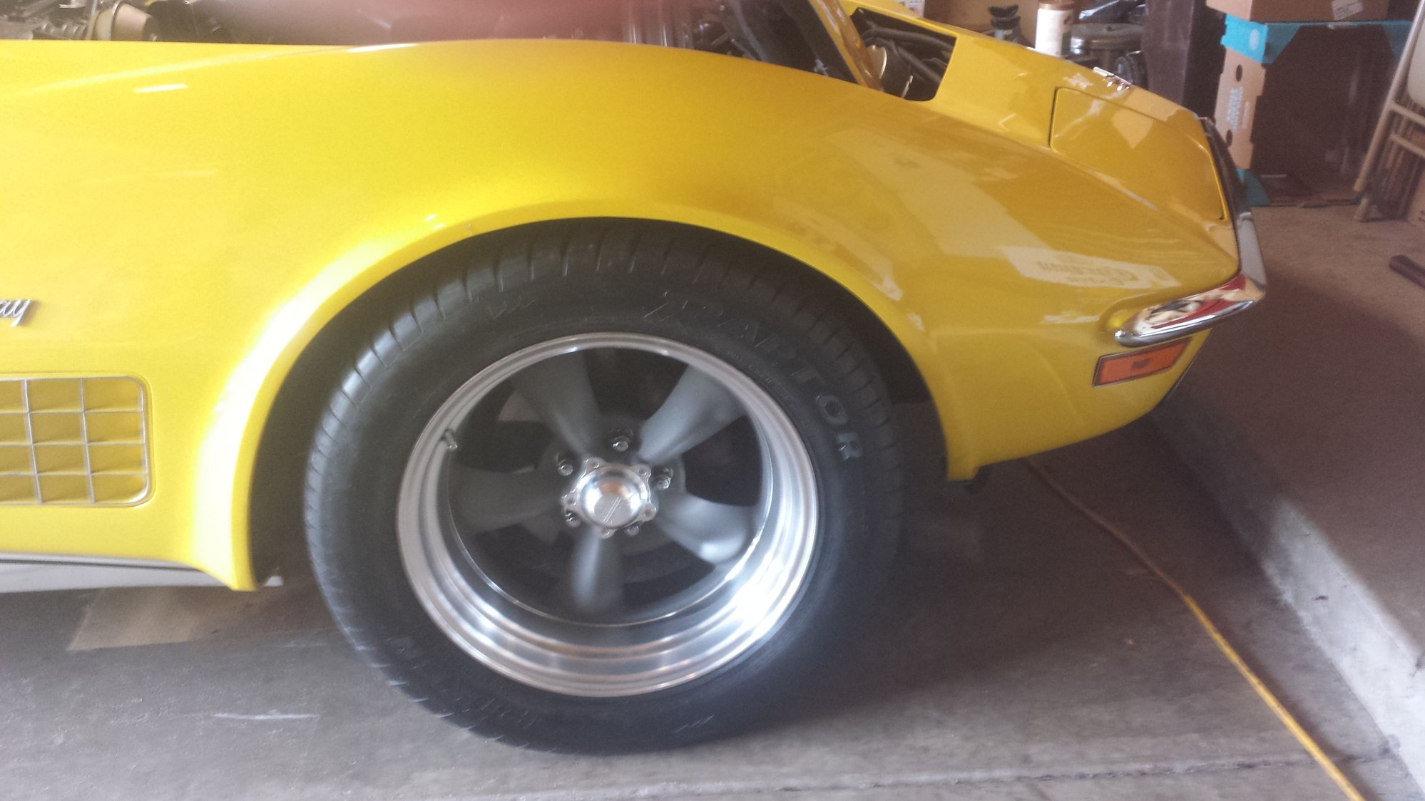

I put 275-60r15’s on the rear and 235/60’s on the front. My front end sits 1” higher than the rear with stock front springs and new rear 9 leaf spring. I have aluminum heads, intake, water pump, and radiator, so I’ve probably lost 100+ LBS off the front so that explains the ride height difference. I keep some ground clearance.. because side pipes and potholes .
I’d like to drop the front 1”-2” and keep a good ride. So do I cut the front springs, get new 550LB springs and cut those? Other spring options?
Thanks
PS: I would have taken better pictures outside but it’s snowing .

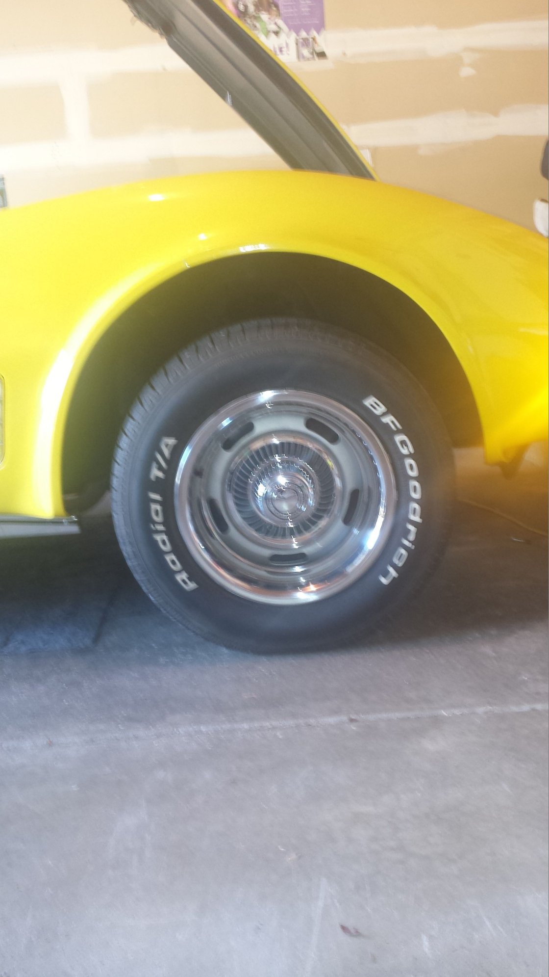

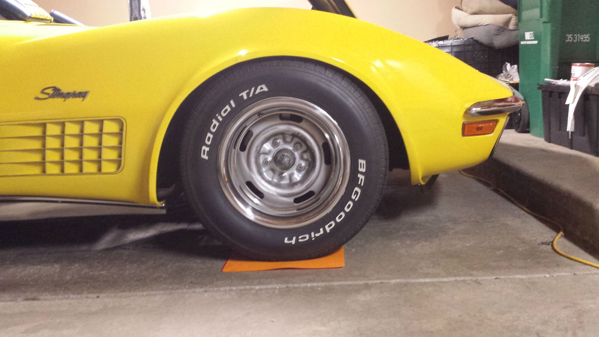

Corvette Central 460lb. spring. With aluminum heads and intake and shorty headers and radiator, no A/C.
Same Corvette Central 460lb. spring with 1 1/2 coils removed.
MOOG 5758 (474lb) coil springs with 1/2 coil removed. 255/50/17 tire circumference is 27", versus the 26.6" of the 15" BFG's (245/60/15) in the previous photos. 27 1/4" floor to wheel arch.

It's 77 with stock opening , the front are 26", so 1" shorter than 255's . The rear tires are 28" so 1" taller and wider than 255's. So there is a 2" tire size difference plus it's 1" higher in the front. It's a base model with stock springs. I think I want about 1-1/2 - 2" lower in the front. Those MOOG 5758 (474lb) sunflower quoted also look like an interesting option. The van steel sounds like a neat way to go if they will adjust low enough.
The wheels are visions 15x8 with 4.5" backspacing 0 offset, I put a 1" spacer (steel adapter) in the rear. In the front I put in longer studs and 1/4" steel spacers.

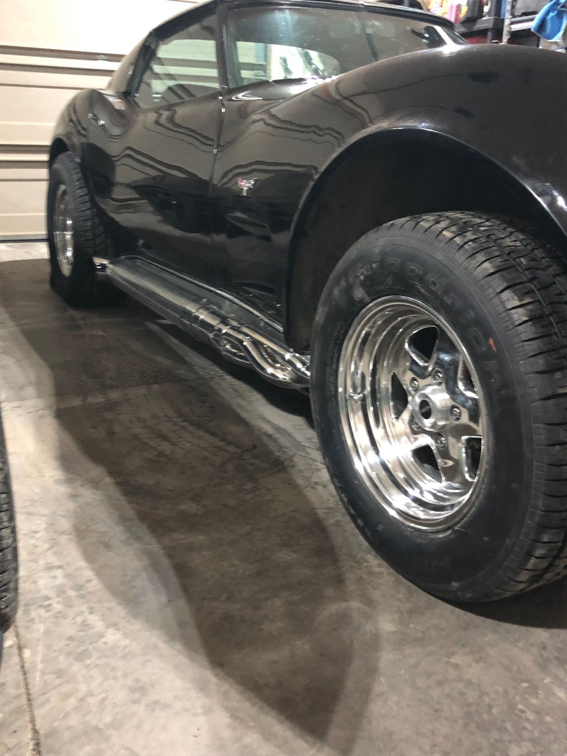

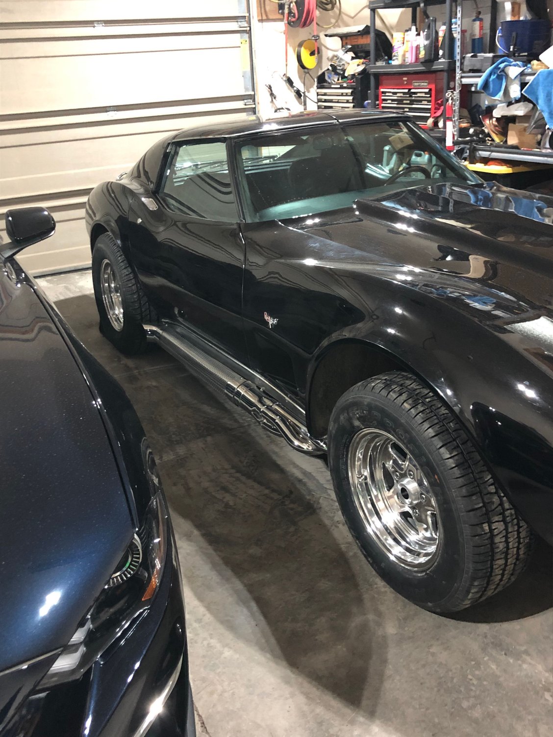

An uncut 550lb aftermarket spring lowered my front end exactly 1”. 235/60 vs stock 255/60 tires lowered another 1”. I’d been advised that lowering below 2” makes decent alignment specs more difficult.
Rear needs fender flares
