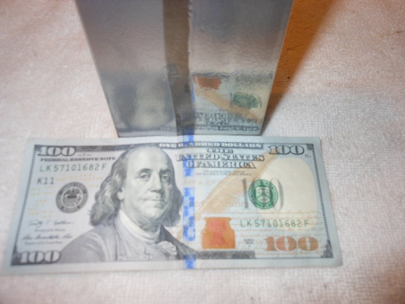

I had good luck powdercoating with "Super Chrome" from Prismatic powders- a little expensive at $25/lb but worth it!!!
Just make sure to fully cure as the chrome will give your temp gun a false reading- usually about 25 degrees less.
A piece of angle iron I had laying around- no sanding just wiped it with some acetone and coated-
Prismatic is on the right-
