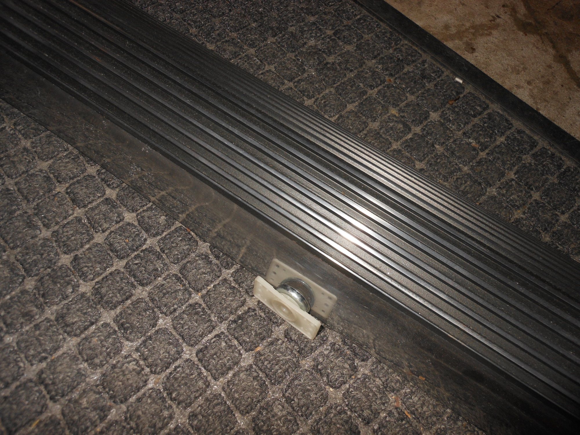

Update. The wiper door is stripped of all paint now. It took a couple of rounds of stripper, a little work with a stripping disc in an angle grinder, and time in the blast cabinet.
I do not know what the deal was. The top layer of yellow paint was very thick, It looked like someone put stripper on it, and let it dry. The media blaster would not really remove it. There were three layers. The yellow top coat, a green, and then what may have been a red oxide primer. Once the yellow was gone or, mostly gone, the media blaster did the job.. Interestingly the back side paint was thinner and came right off in the media blaster. The cowl vent panel and the molding were the same way. I do not have an after photo but, both are stripped clean now and ready for the painter to do his thing.
Also, why did GM choose to paint the stainless moldings on the wiper door and upper fenders? I think we are going to leave it unpainted and polished.
