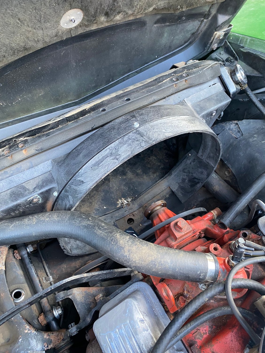

Got this far then my back said time to stop. I didn't see any bolts coming from the sides,maybe something at the very front.

The heads of the bolts are in the wheel wells.
