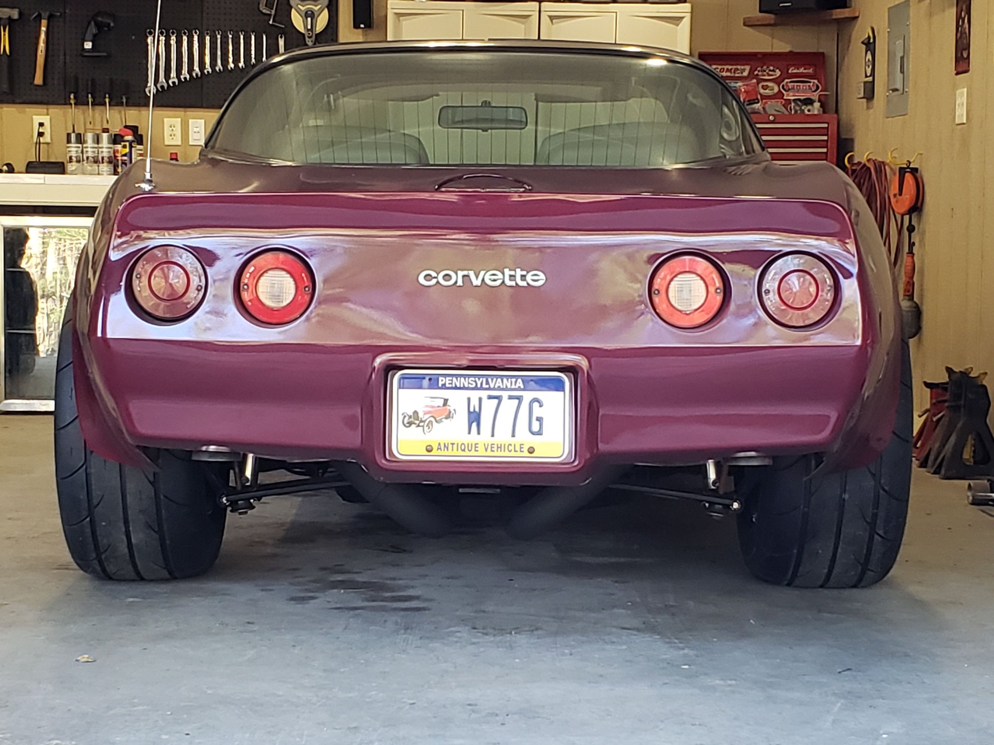

These are 28x12 drag radials on 15x10 Welds With any luck yours will not stick out quite as far as mine do. I could not justify the expense to cut and weld the frame to move mine in.
