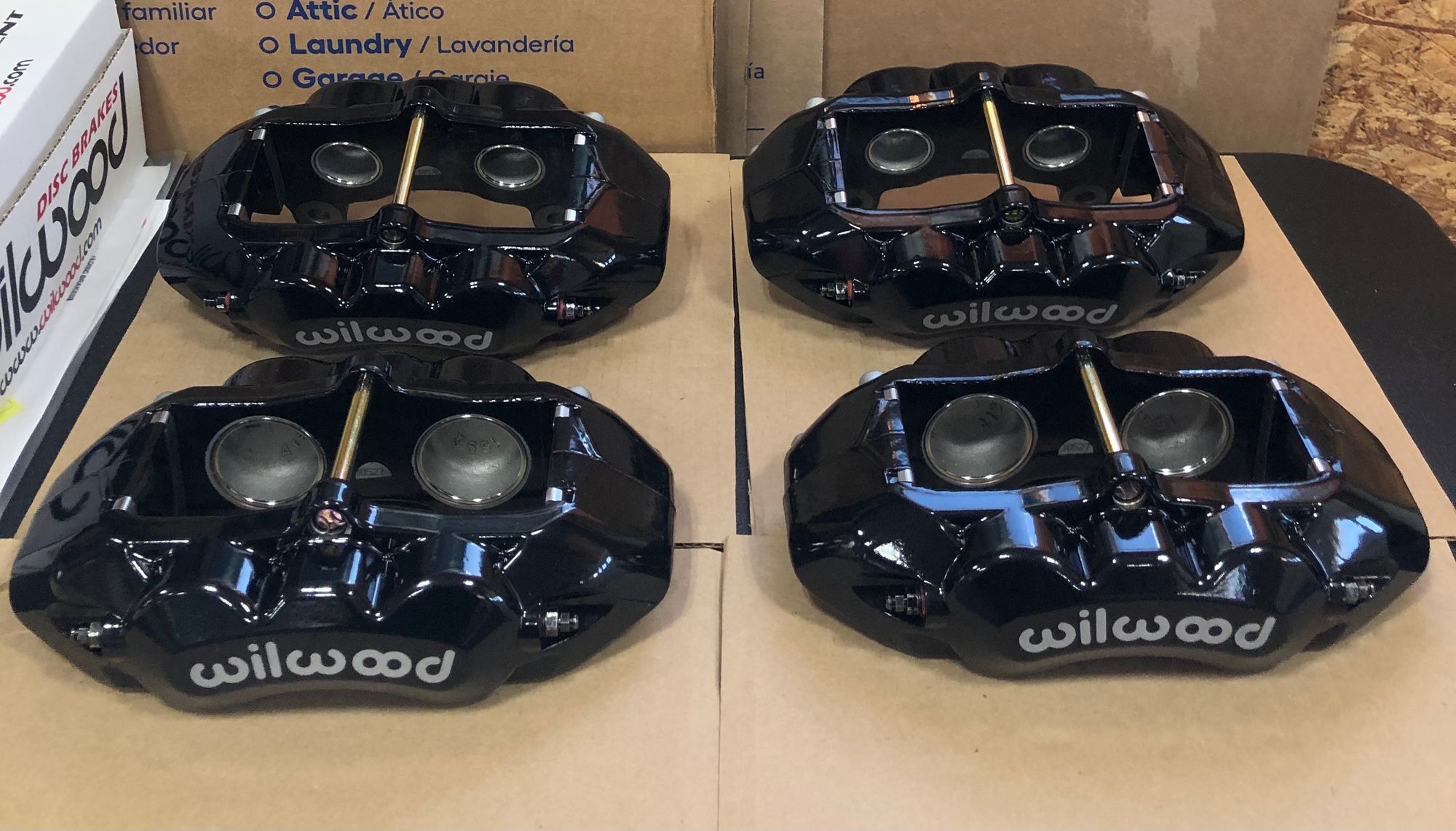

I’ve tried rebuilding and multiple remans over the years. They all ended up leaking at some point. I gave up and went with Wilwoods. Leaky brakes are now a distant memory.

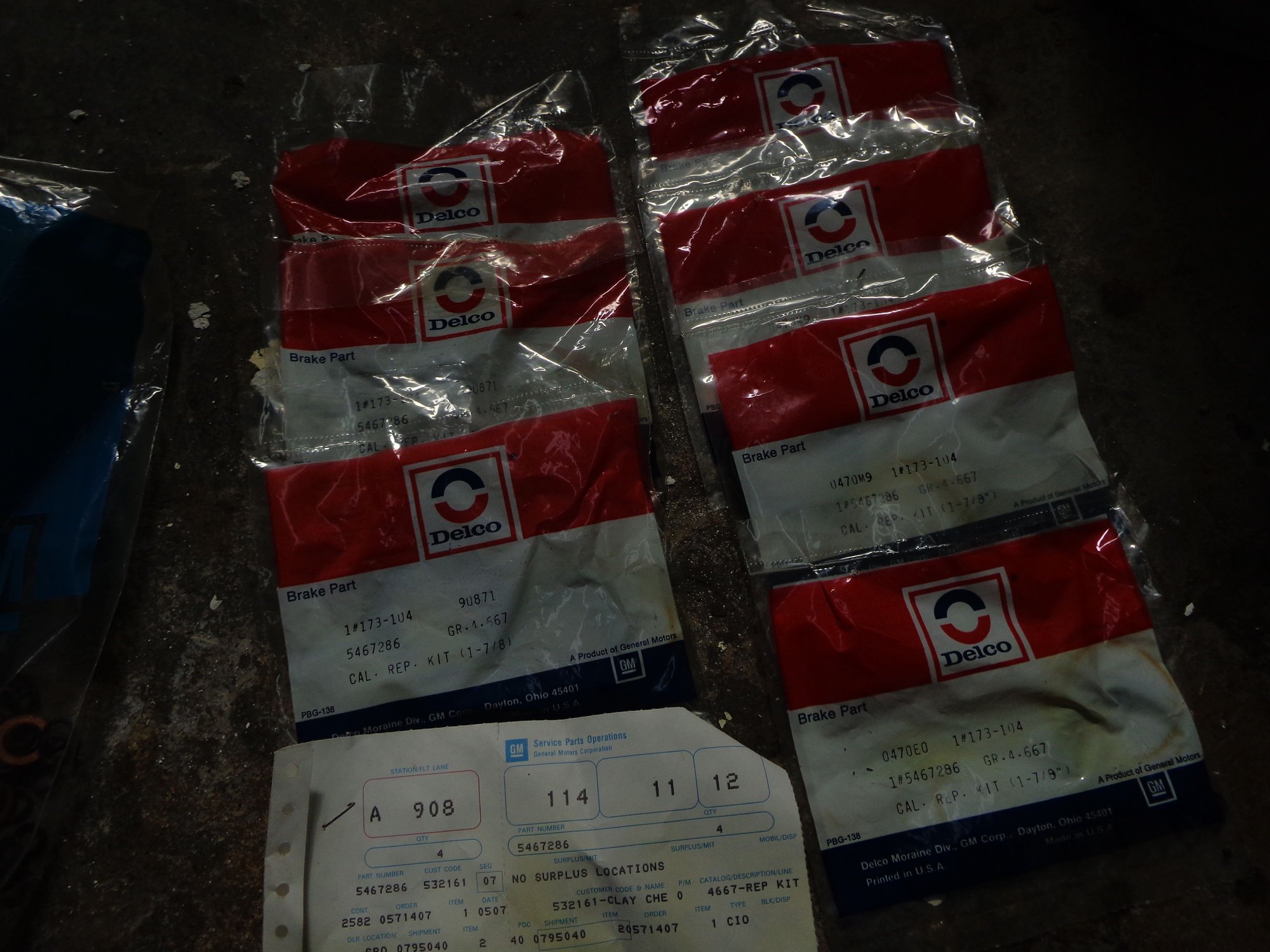

I always used these Delco kits do they still sell them ?
