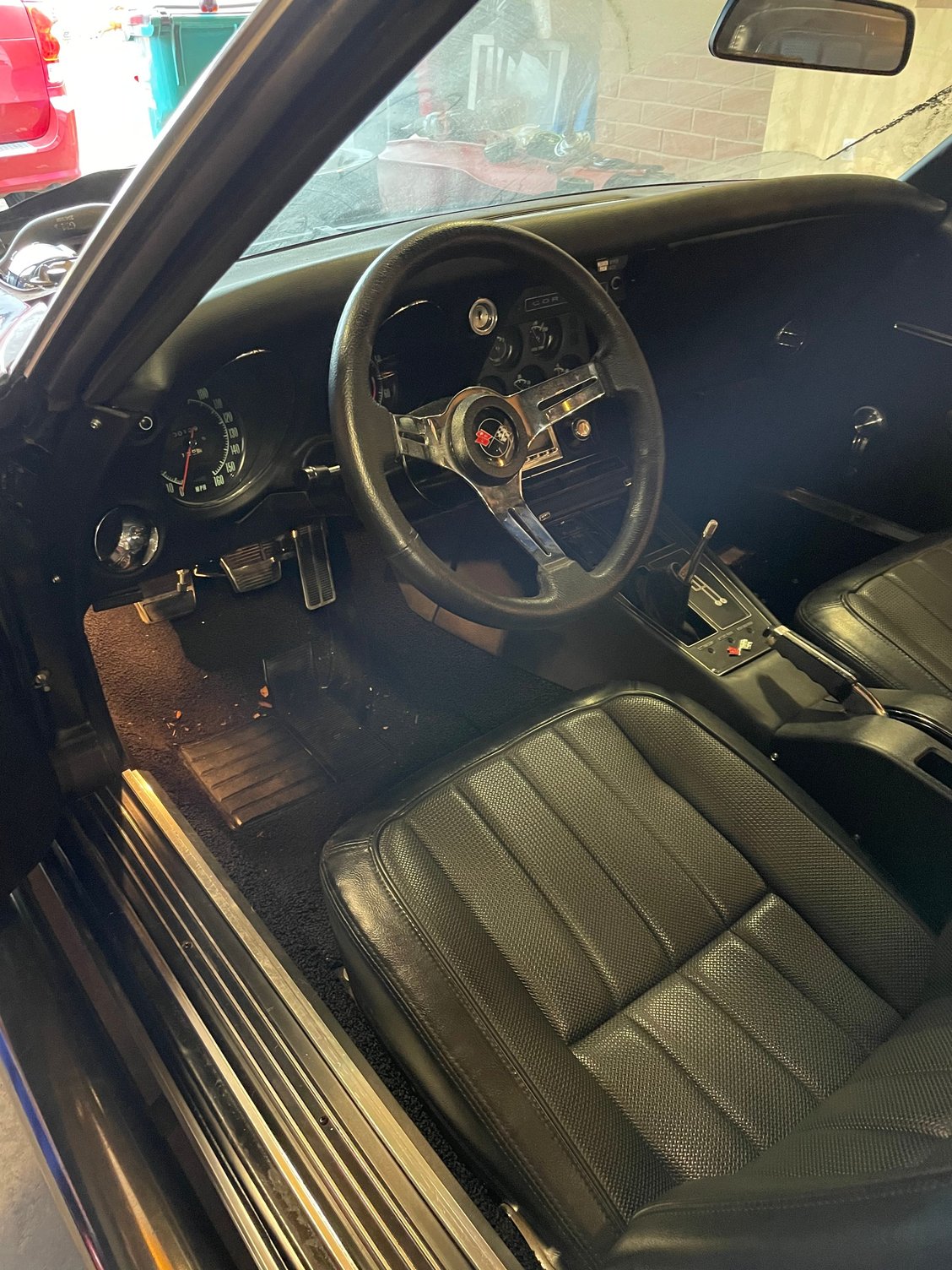

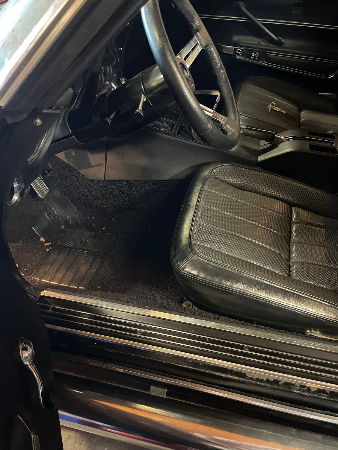

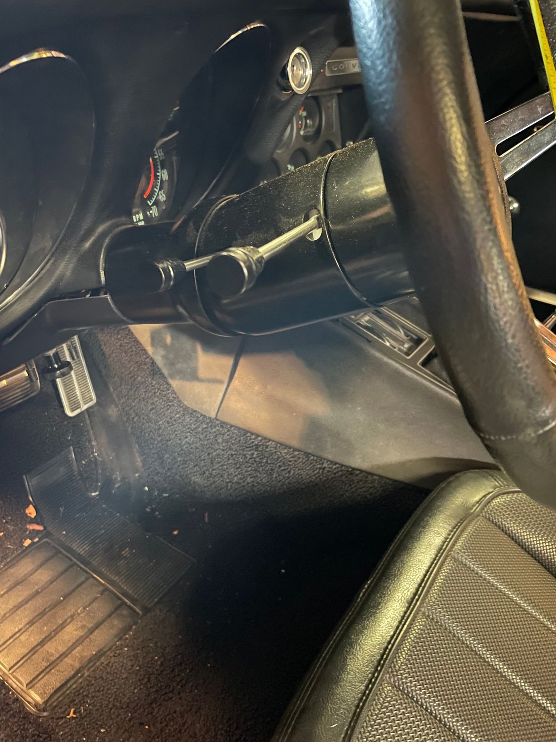

Originally Posted by rmoudry
I have been trying to find a tilt wheel assem for my 68 Conv. Does anyone know if a 30inch or 32inch will work and also how do you confirm? The car is a pain to get out of as well as enter, it will be at a shop in Jan having some other work done so I would like to have the column installed at that time. Help would be deeply appreciated. Thanks and Merry Christmas!
Here are pictures of my brothers 68 with a ididit column. The wheel in question is a 14” diameter wheel.
I have driven the car just to move it around and do some short maintenance check drives and the the tilt column is a night and day difference.
I have 2 discs in my lower back that are badly damaged (one I’ve had surgery for already and the other isn’t far off). So I know what your getting at as far as back issues. Here are pics to give you an idea.
The only real drawback is it’s a real bear to get that lower dash piece in and if you have a non OEM the fit is just terrible. I need to pull it back off and do some more work to it to “fit” right.
