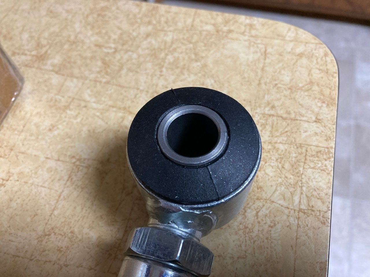

Originally Posted by wwiiavfan
Went with these. https://www.maxpeedingrods.com/produ...e-1963-79.html
At $70, they are budget enough that if the bushings give up, I’ll replace the ends with Heim joints and will probably still be money ahead.
we’ll see how they fit up.
Interesting. Rods were delivered today and the ends look like, smell like, and feel like rubber bushings.
Looks like ya got what ya paid for no matter what add description states.
Couple minor issues with this set so far: the square plates that replace the cams were just a hair too wide to fit inside the channel in the differential bracket. Had to grind about 1/16” off them. Also, weirdly the bolt & nut they supplied is metric, and therefore a little sloppier in the plates than I like. So, I’ll stop at the hardware store and grab a couple 1/2” x 3 1/2” grade 8 bolts. No biggie.
