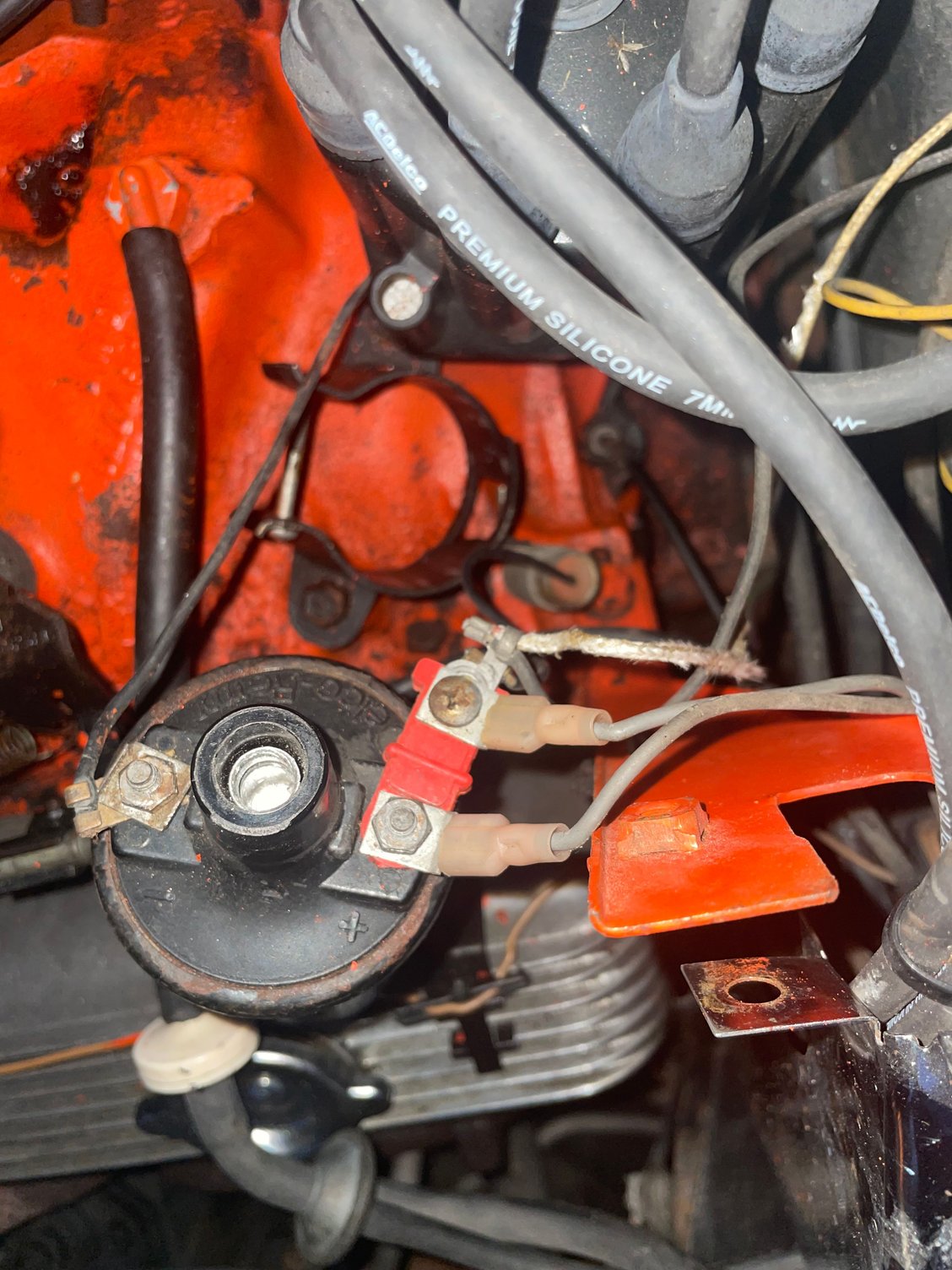

1973 corvette. 350, very Low miles so I think this is factory
coil is not firing. I will replace it But what are these extra wires on the positive side ? They look factory
Thanks Danny

I don't think that's factory, looks more like someone wired in a cut-off (anti-theft?) switch or something. Where do those two grey wires go?

They two wires run back thru the firewall
The kill switch does make sense.
I’ll see if I can follow the wires this weekend
thanks

Good clear pictures.
Definitely not factory wires.

Not factory and most likely the cause of why your ignition is not firing.

The wire at the top appears to be a resistance wire. If so, it is used to step down the power to the points in the run position. Jerry

Check your ash tray for a kill switch
