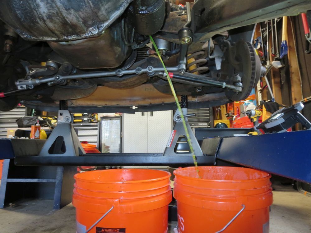

I just used the prestone stuff and added it and drove for a couple of days, completely drained and refilled and ran the prestone again. THen on the third lap I just ran straigght water and then kept flushing it until it was clear. THen took the radiator out and back flushed that until it was clear..... Refilled everything with premix 50-50 and every time I drain the block after that it was as green as the day it went in...
