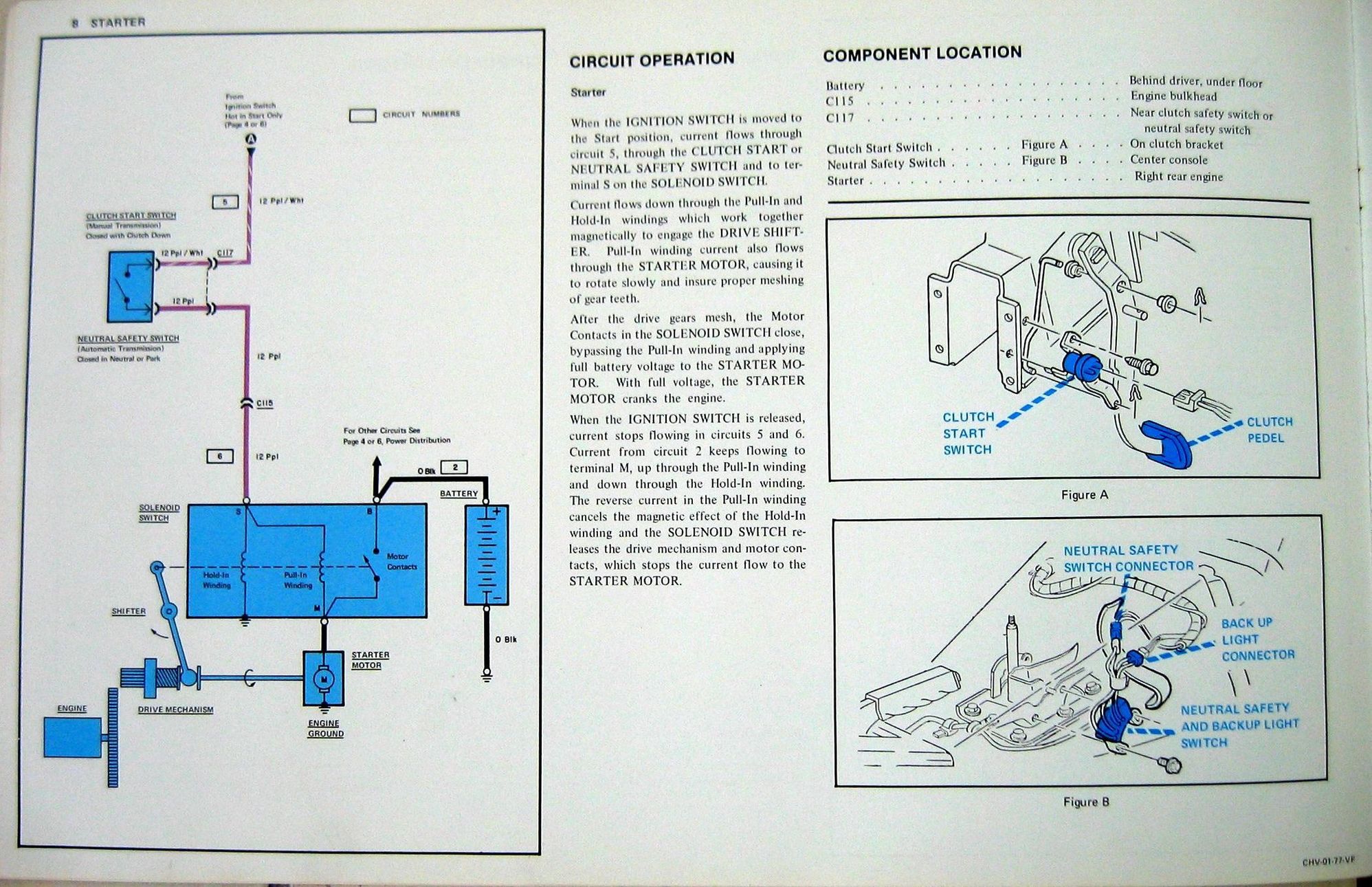

Do you have power through the clutch start switch?
Ignition power to switch ONLY in start position.
Wire colors MAY be different, check your service manual for starter wiring drawing.
N/O contacts on clutch switch, depress clutch pedel contacts "should close" sending power to terminal "S" at starter solenoid.

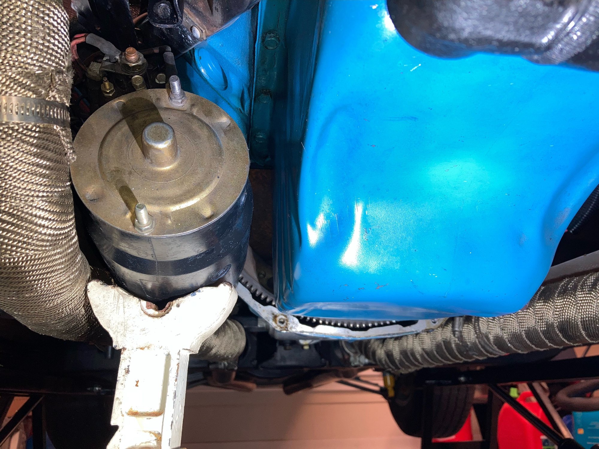

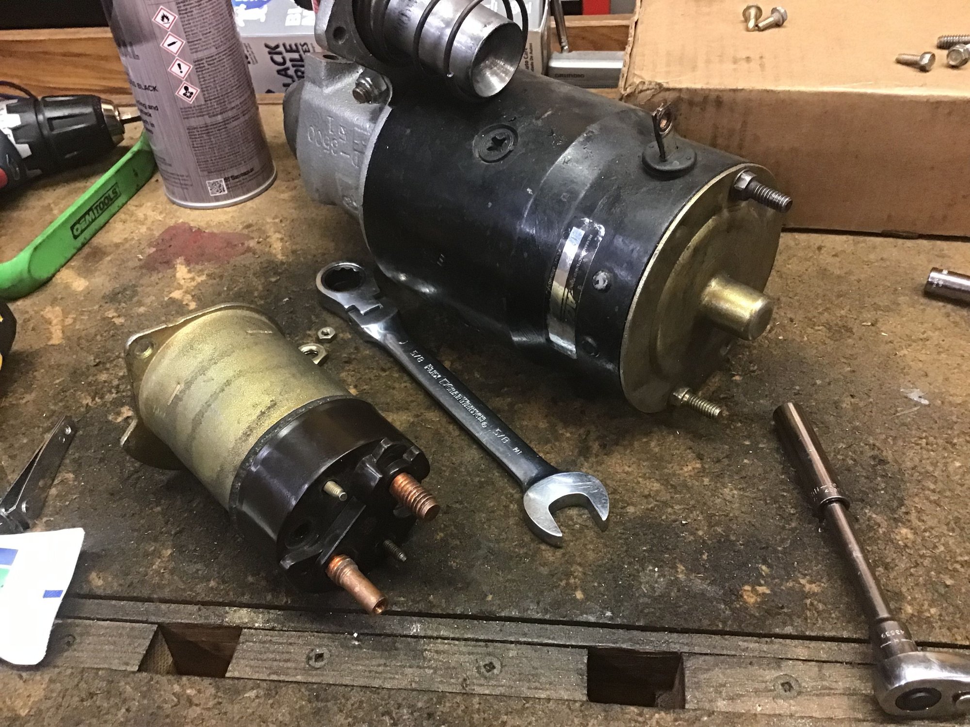

Thanks for that I already pulled the starter so it’s too late I did notice that on the solenoid all the studs nuts were loose on the starter not the wires and when I put my power probe on the starter it blew a circuit so I can’t test it that way but terminal stud S was loose and when I would move it around it would make periodic continuity so now I’m trying to get the damn thing off which it looks like it doesn’t come off I may have to get another one and see
Old Dec 22, 2021 | 11:32 AM
interpon's Avatar
interpon
Joined: Jun 2019
Posts: 7,658
Likes: 2,470
From: Indiana

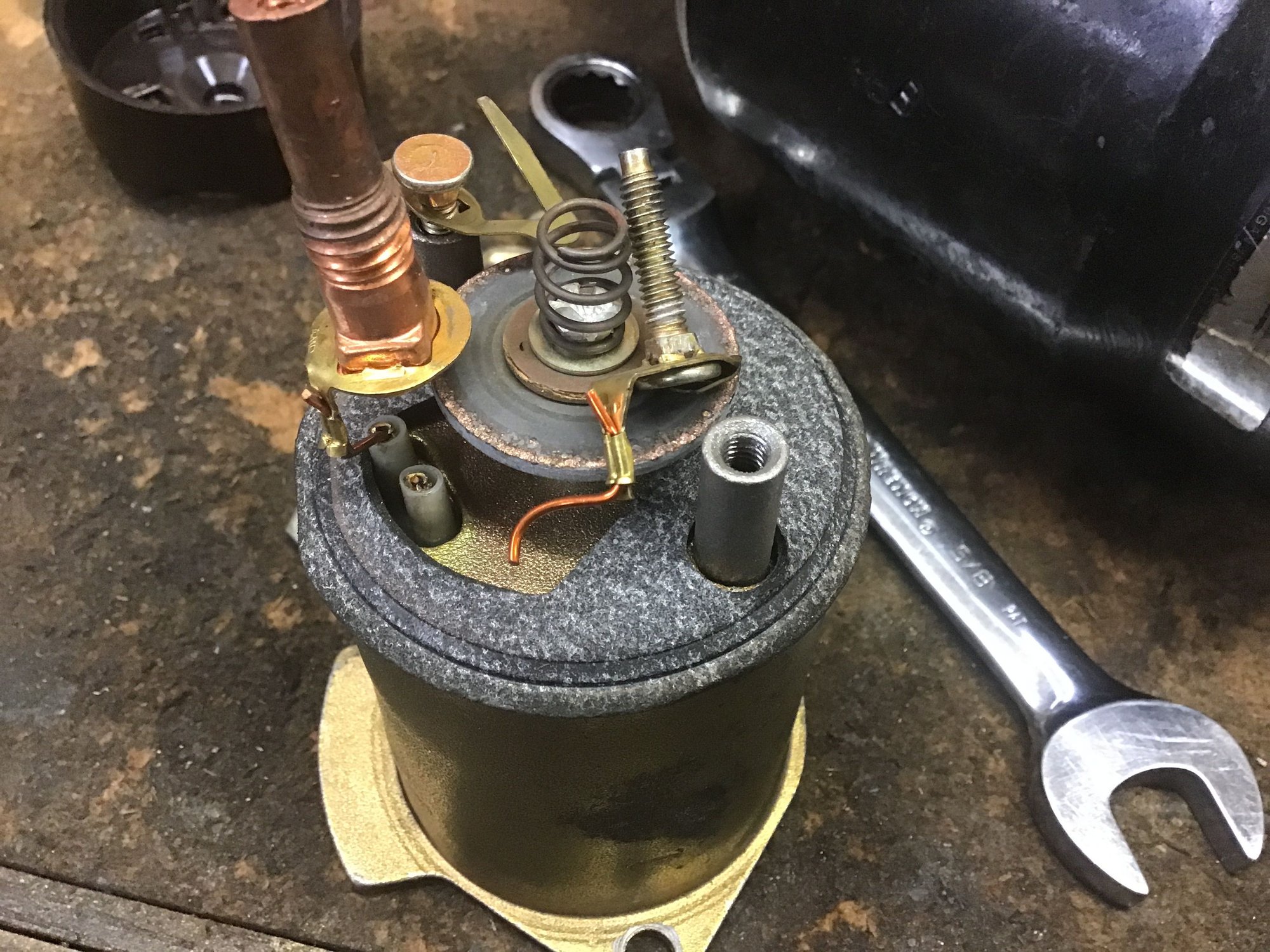

Well..this probably aint good the s wire

From: Seattle Area Washington
I believe you found your problem...
If you look at the buildup of copper on the disk under the plunger spring, something was going on inside there...
The disk will usually show some wear and carbon arching and can be removed and rotated for a nice clean start to use the other side.
I bet both contacts points of the motor winding lug "M" and circuit 2 or "B" lug are both ground down significantly.
Old Dec 22, 2021 | 12:22 PM

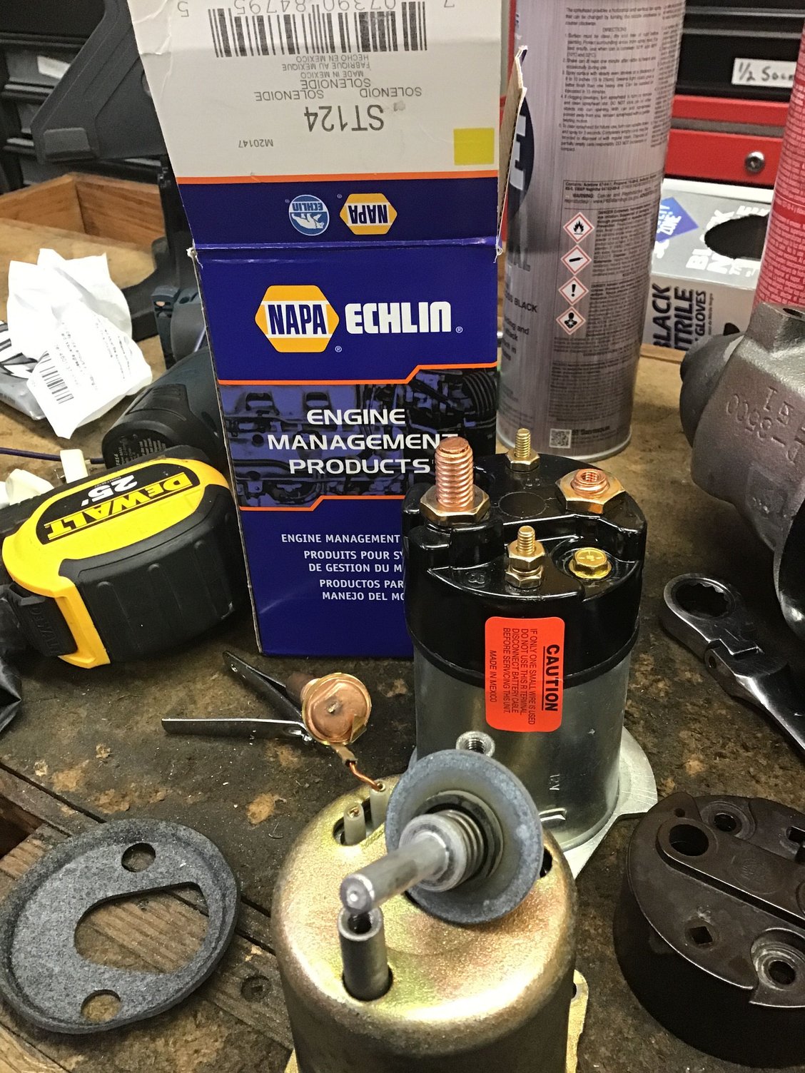

Pics under
mexico made napa all they had and pf course the most expensive 42 bucks. Black cap..

So wth??? The stud isnt long enough..am i to adjust it out?
Old Dec 22, 2021 | 12:53 PM
Jebbysan's Avatar
Jebbysan
Dr. Detroit
Joined: Mar 2012
Posts: 10,097
Likes: 4,027
From: New Braunfels Texas
There is usually a spacer and a long screw........but there are solenoids out there that have the long lug on them too.....

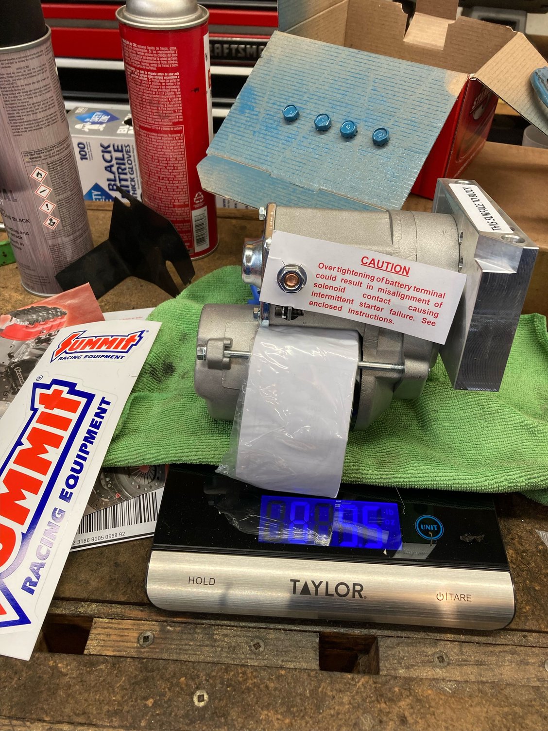

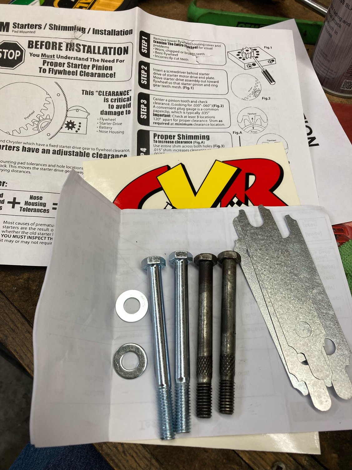

i know this has been asked many times before….but
usa mini starter that I won’t need to shim or destroy my teeth on flywheel? Or alternate solenoid?
budget not unlimited but will pay up for usa and wife just asked me what i want for Christmas
May save my front teeth too installing it..
thank you

CVR 5323.....have installed a dozen of them never once had to use a shim......I won't use anything else.
https://www.summitracing.com/parts/cvs-5323

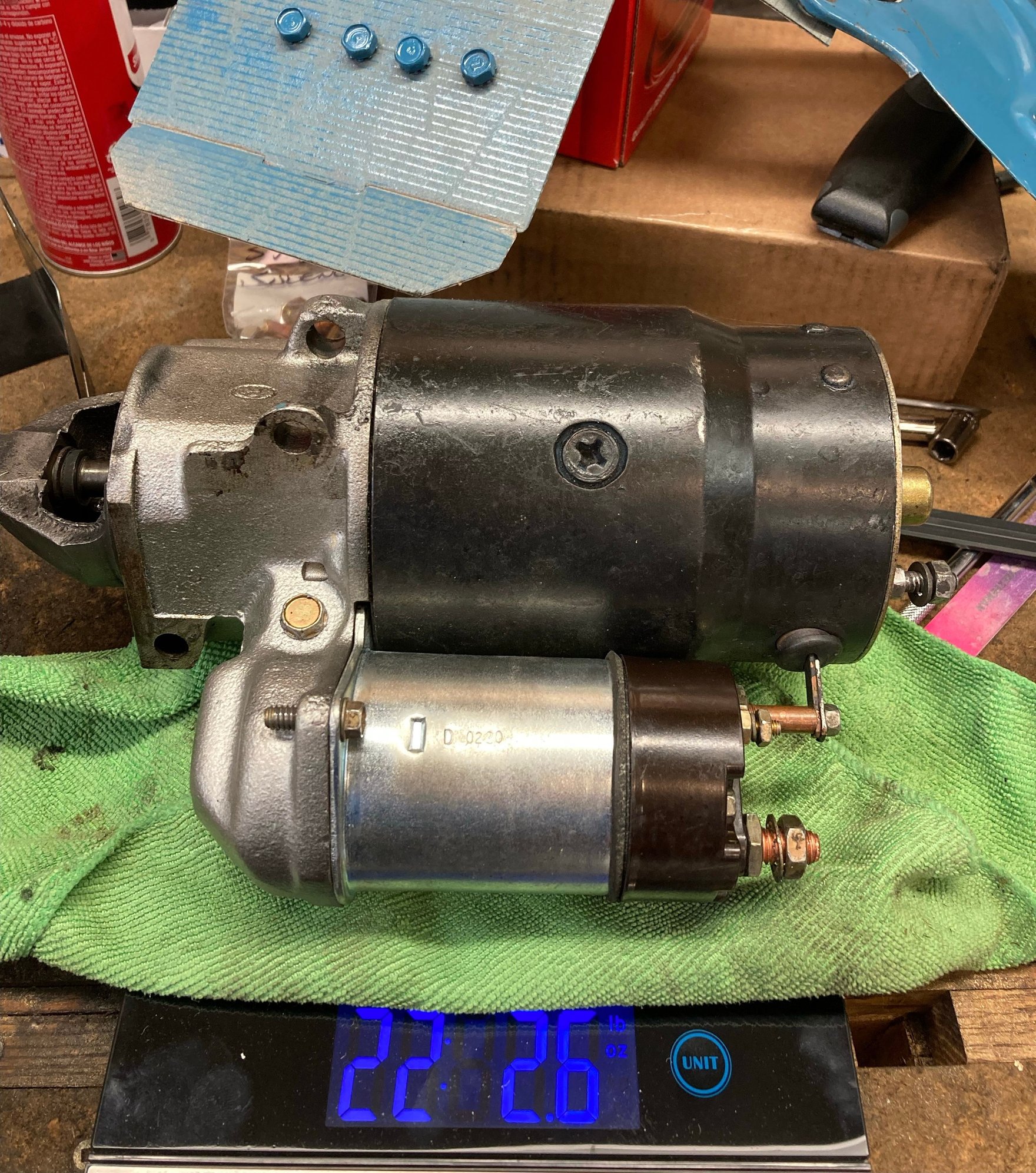

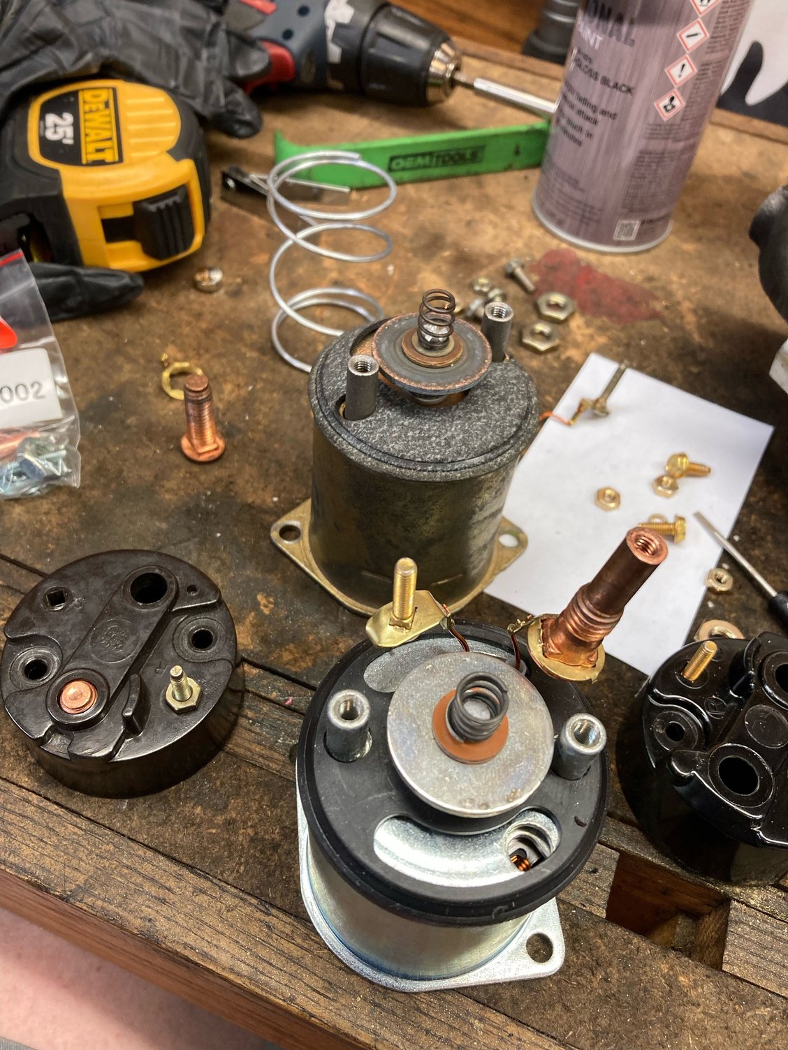

So I figured why throw the old starter in box with trashed solenoid…
so….
oreillys had standard solenoid for 30 bucks!
guess what..it comes with hardware and the spacer! It is exactly as the napa one no doubt…that came woth nothing for 10 bucks more..
i was able to transfer stud as @bmotojoe suggested turning it 180..
reused asbestos gasket and brown bakeolite
cover..
rough install and starts rightup!
i now have a good spare if my mini ever goes…
i think cheap insurance for those running oem starter to ****** up one of the standard ones for 30 bucks as not many left, rockauto out of stock as well.
It appears the copper wires get pretty brittle as bending the other one not broke snapped right off.
so….
cover..
Yep, those internal wires at both the "S" terminal and "BAT" terminal are under full load until engine starts.
It is only then the PULL-IN winding's drop out and the drive shiftier and plunger return to it's home position opening solenoid contacts.
That's why a #12 gauge wire is used on the "S" circuit.
Good find in the Standard Solenoid
Old Dec 23, 2021 | 11:50 AM
bmotojoe's Avatar
bmotojoe
Joined: Oct 2007
Posts: 4,380
Likes: 1,746
Now if you find a Brown Bakelite cap like this with only a "S" terminal it will be correct...

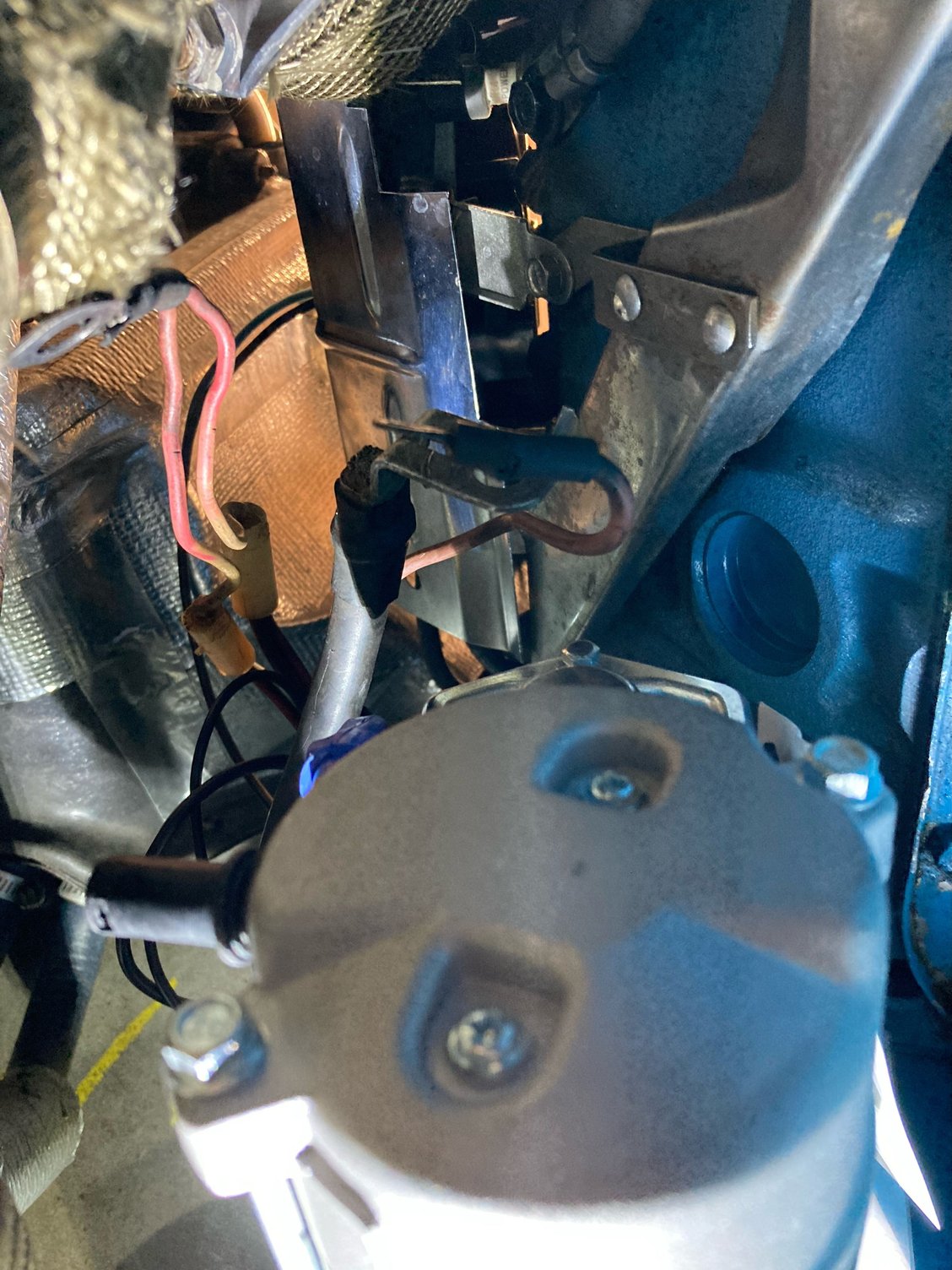

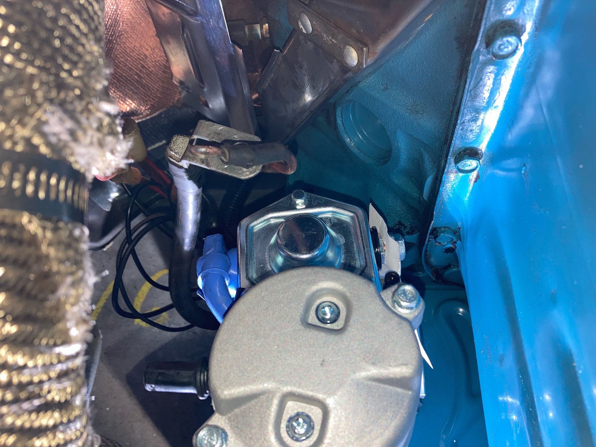

Well problems…
number one, no way are you checking end play..impossible as screwdriver cannot grab to pull out..so hope its right…
number 2..the wires are worse than oem? Do i havethe wrong one? Positive cable will not reach..and if it did is 90 degree?
thoughts help?
There is also no knurle on the bolts like the summit video says is required?
