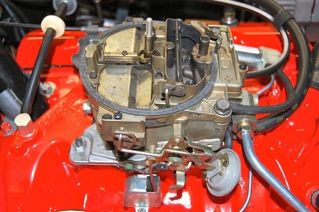

Do you still have the same carburetor that you posted in 2019?
Originally Posted by Daveinspain
I see you were missing the clip that goes on the choke thermostat spring rod, maybe the choke rod came out. I would check that all of the choke components are working and moving freely.
Choke closed
Choke open
Old Dec 30, 2021 | 10:19 AM
Choke closed
Choke open
Yeah I still have the same carburetor and I see what you mean about the missing clip. I never noticed that before. Thanks for posting the pics and pointing it out. I remember you mentioned that back in 2019 but I didn’t know where the clip was that you were talking about or what it looked like. The pics really helped..!!
Whenever I check my choke operation with engine cold, I remove the air cleaner, stand on the passenger side and reach over and operate the throttle to see if it closes properly. Start at the choke thermostat spring to see if it pulls down and go from there. Follow the choke linkage.
