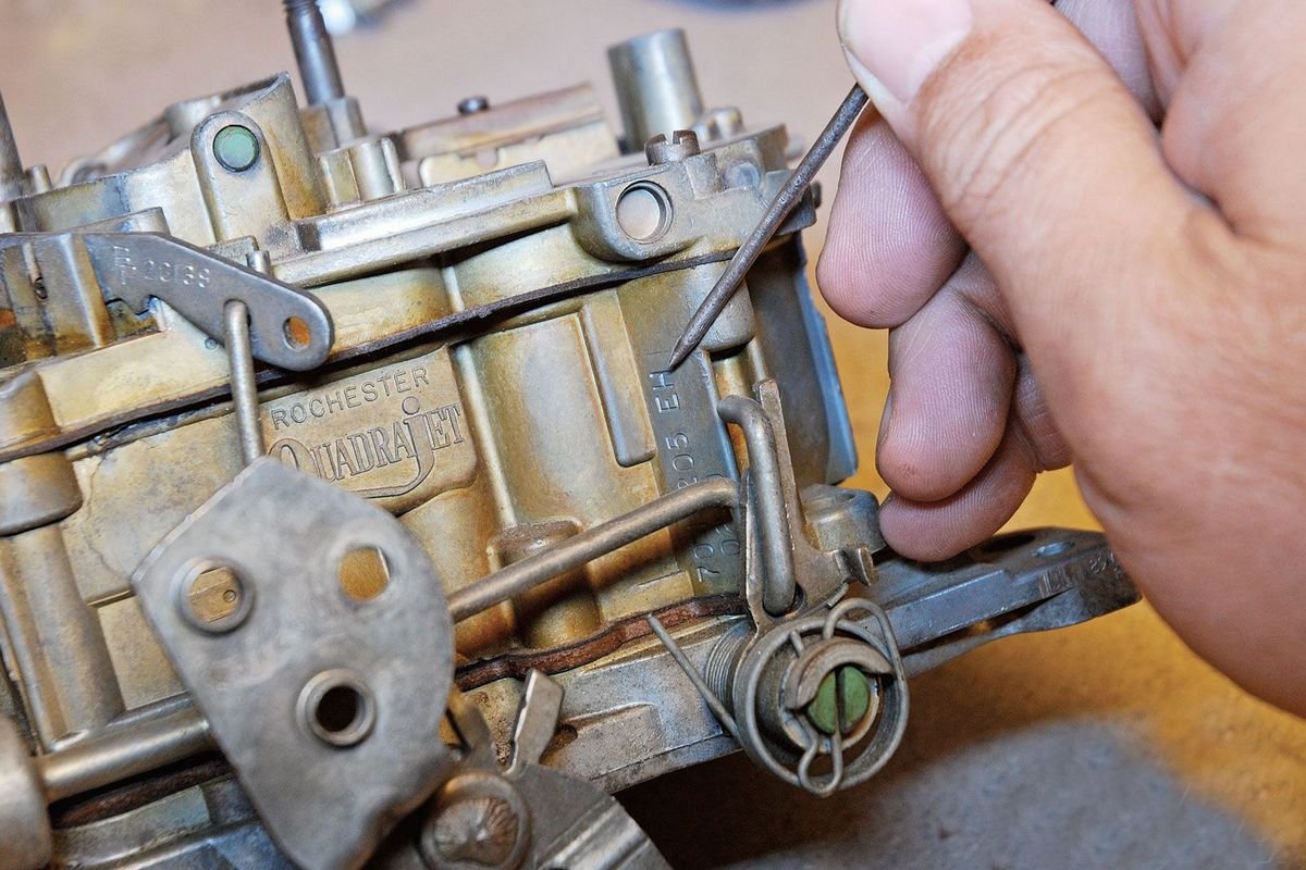

Tx for the info Lars and I will take a look at the carb and maybe send you a pix
Can you direct me to the exact location for the carbs ID number?
JJ78

Not Lars but...
Here's a pic from the link derekderek posted - driver's side:
