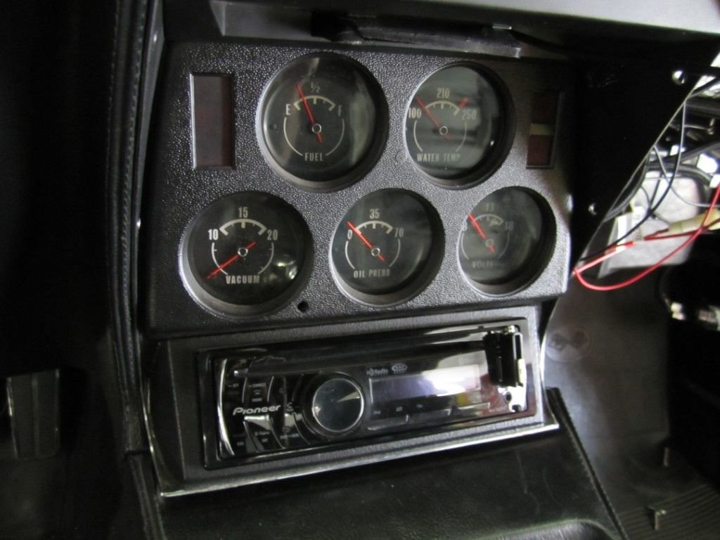

A vacuum gauge is more useful than a clock.
M

Originally Posted by Mooser
M
Wow...didn't know such a thing existed!
Jebby
It didn't (or at least I never saw one) so I made that one https://www.corvetteforum.com/forums...post1604149155
