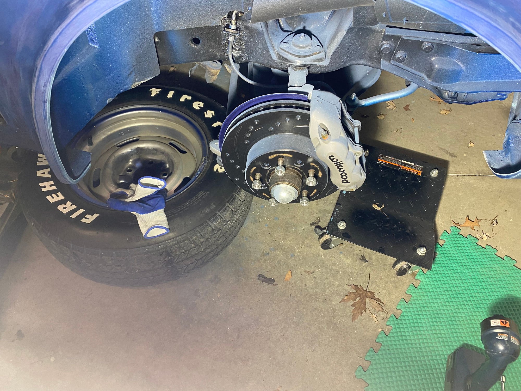

Hello Gang,
In my ongoing education on Corvette restoration and modification, I got a crash course in paint prep and painting from an old school hobby painter who talked the talk but failed to walk the walk. I learned a lot about what not to do.
n short, he messed some things up severely by not masking off well enough before painting. I now have overspray on everything from brand new headers, stainless brake and fuel lines, the backs of new Willwood calipers which will be visible through my TT2's, on the new springs and shocks, and on the already pained wheel wells and undercarriage. It's taken me months to overcome my fury and disgust to begin to address the problem. Simply reshooting the undercarriage and wheel wells in the same black I did before really isn't that big of a deal, though I hate doing things twice.
But what is the best way to go about removing the overspray from the springs, shocks, calipers, headers,clines, etc. Lacquer thinner? How do I avoid damaging those pieces original finish? Any help and direction would be greatly appreciated.

Damn I would be pissed......it pisses me off just looking at this photo.......WTF was that guy thinking not spending time at least taping a makeshift apron on the fenderwell.....
Anyway.....I would start by getting some old T-shirts and a gallon of enamel reducer. Try an area that is not as noticeable and see how it comes off with a soaked rag........a spray bottle with reducer in it is handy too.
Stuff like the backing plate and caliper will need to be removed to do a good job and to uncover things like the steering knuckle. It is a slow process......
Remove the A-arm flaps and get new ones or leave them out like I did.......gives hot underhood air another avenue to escape.....
If it doesn't come off easily then you will need to refinish or buy more whisky/beer and grunt it out.......
Stuff like the wheel well will do better to just refinish it with a semi-gloss black and lot of taping off.......garbage bags and newspaper are invaluable to wrap things up or make "cut lines" to mask things......you can get creative with this......do it right and it will look better than before......
Jebby

Thanks Jebbysan.... Yep, I can feel my bloodpressure skyrocket everytime I go into the garage. The wheel well you see in the photos has been resprayed already. I'll do one well at a time, but getting the overspray off is the big question mark for me. I've gone from pure hatred, to telling him to give me some money back or we're headed to court, to moving on to fix it, and back and forth. But yeah, it sucks.
I'll give your process a shot maybe on a fuel line in a back well, which I can always spray black if it doesn't work out. But man, I worked hard to get that undercarriage stuff nice and he jacked it all up. Even the new body mount hardware was shiny and new and now its a mess. What makes it worse is that his line was contaminated and I had fish-eyes everywhere. I had to sand it all down again. And I paid for that crap: a couple grand for materials plus labor and I went backwards. I'm all kinds of twisted angry about it. But we gotta keep moving forward, right?

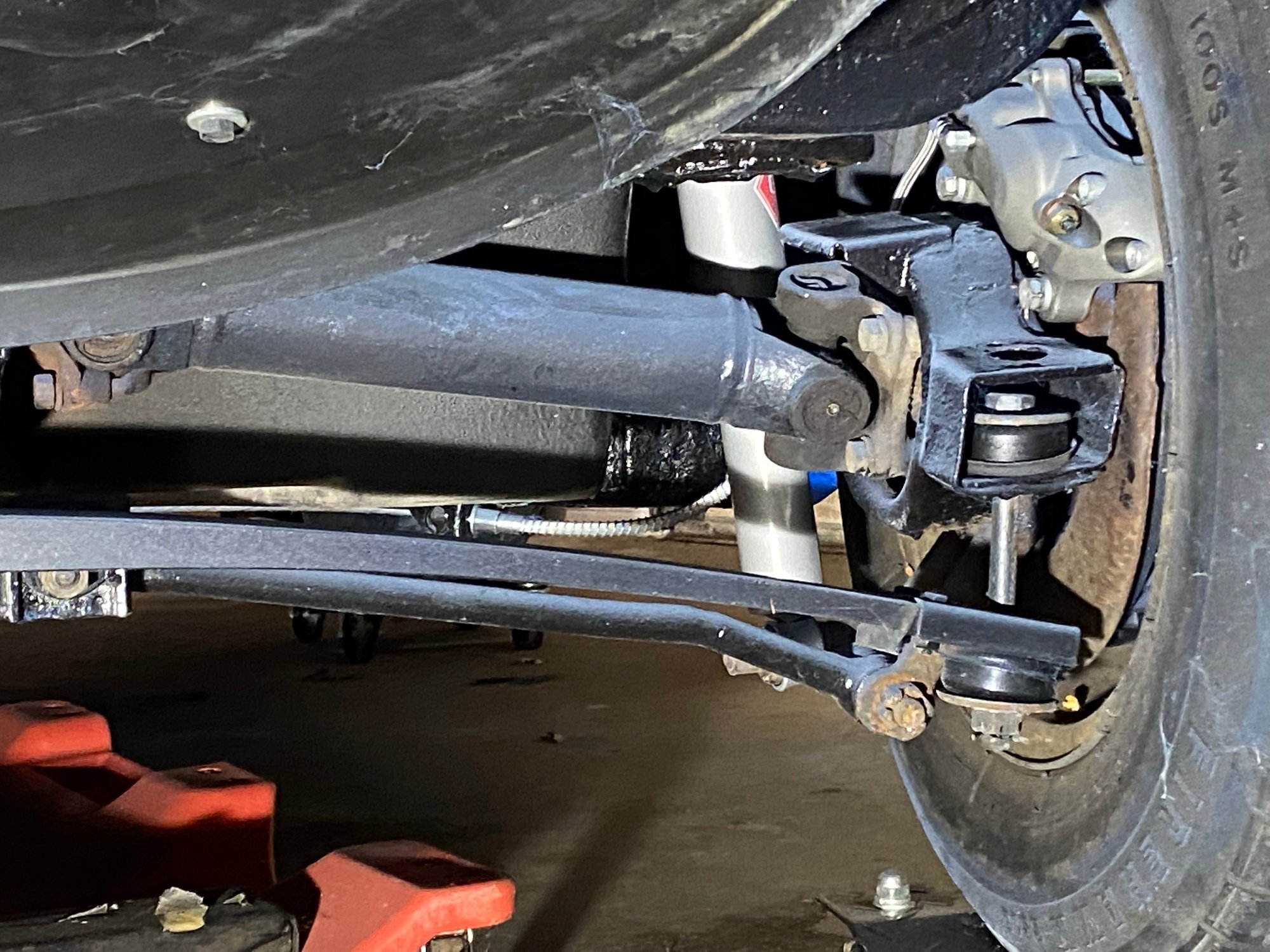

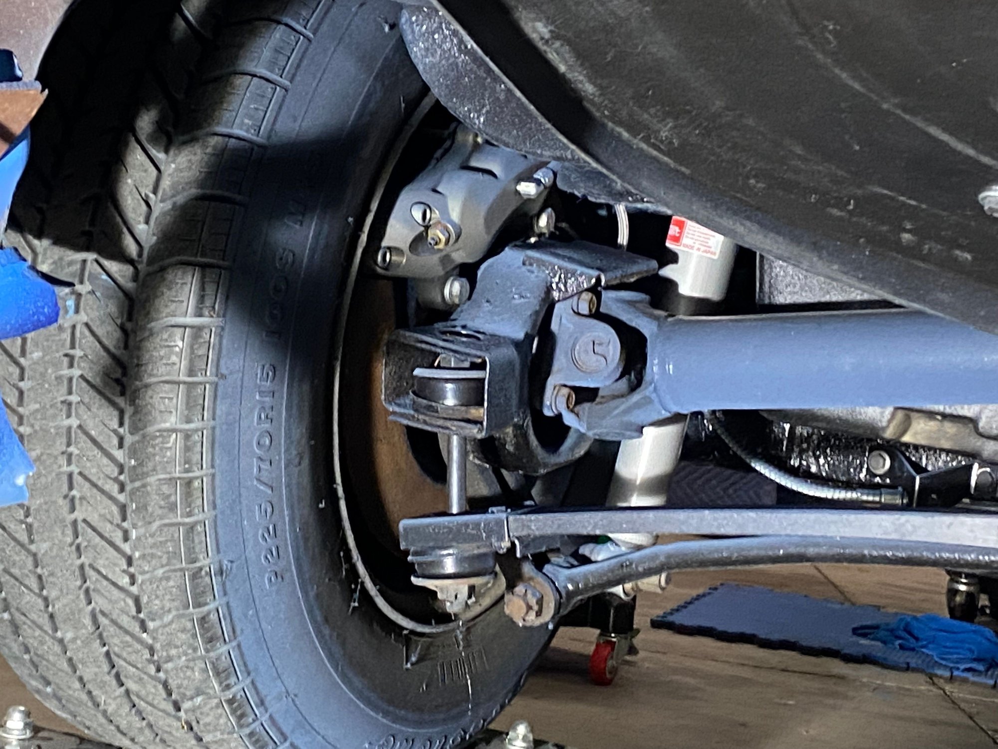

you strut rods are bent up pretty bad ,,
tell him to come back and clean it ,, I would have him in a headlock and be pulling some Superfly Snuka moves

Stroh, so sorry. Some good advice above from Jebby and 69L88, and I agree with forman - - if the struts were bent to get a good alignment, you might consider adjustable rods. I would add that if you use enamel reducer (done so many times) I would use low temp (quicker evaporation) reducer. This will help you avoid cutting through secondary surfaces quite so much.
Regardless, you have a lot of work ahead of you - and you're going to have to disassemble some stuff to get it all done. It's double work, yes. But you have a beautiful car and it will be okay in the end. Deep breath, and tackle it a section at a time.
