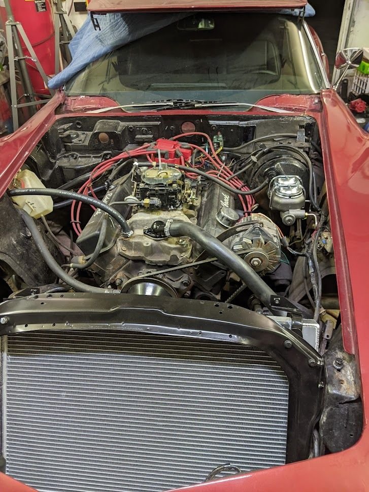

So I looked at a few old threads on this but they didn't appear to have resolutions and I didn't want to bring back a post from the dead.
If you have a 1968 but you have a long hood, so the wiper cowl is gone. Can you bolt a late model (say 1980) wiper motor and get it working with minor modifications to the wiring?
I've read to believe that the wiper has power on with key on, and that the wiper switch grounds each of the speeds. (in addition to the wiper motor body requiring a ground). Is this correct ?
-- Joe

Any thoughts as to the 1980 wiring? I have two brand new 1980 motors from my pile of parts from the aborted 1980 resto.
My 1968 is missing the wiper motor...

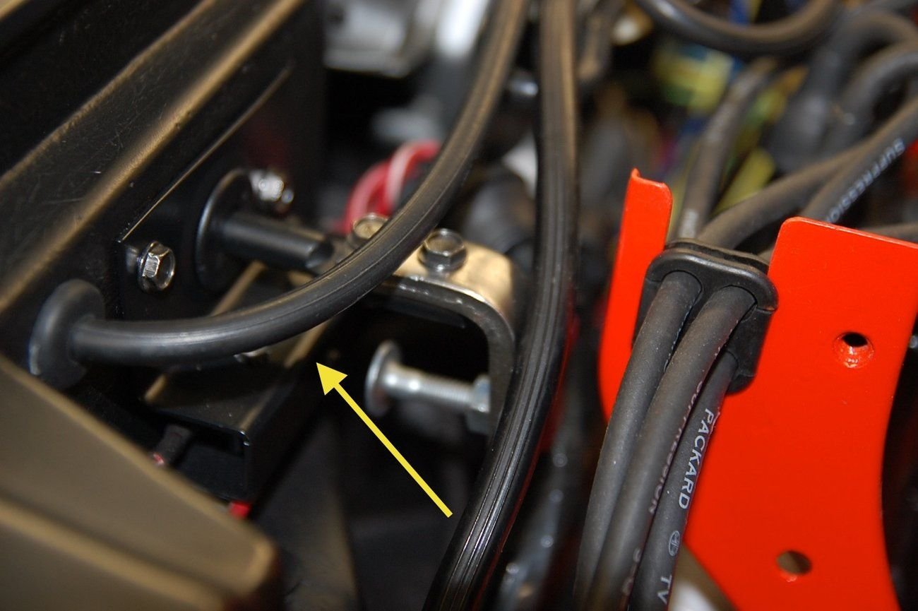

Why do you want a later model wiper motor and the headaches of trying to rewire it? Just use the 68 one. Just bypass the cowl open switch, it unplugs and you can jumper the connection or just cut off the plug and solder the joint..... its the 2 prong T shape one that the L shaped shoe closes to the passenger side of your motor

Pic from ALan71
Find the plug from this switch its about 2 inches away, really short pigtail

I have a 1968 wiper arm. The previous owner disconnected it from the motor and left it. The motor is long missing. I don't know why.
-- Joe
