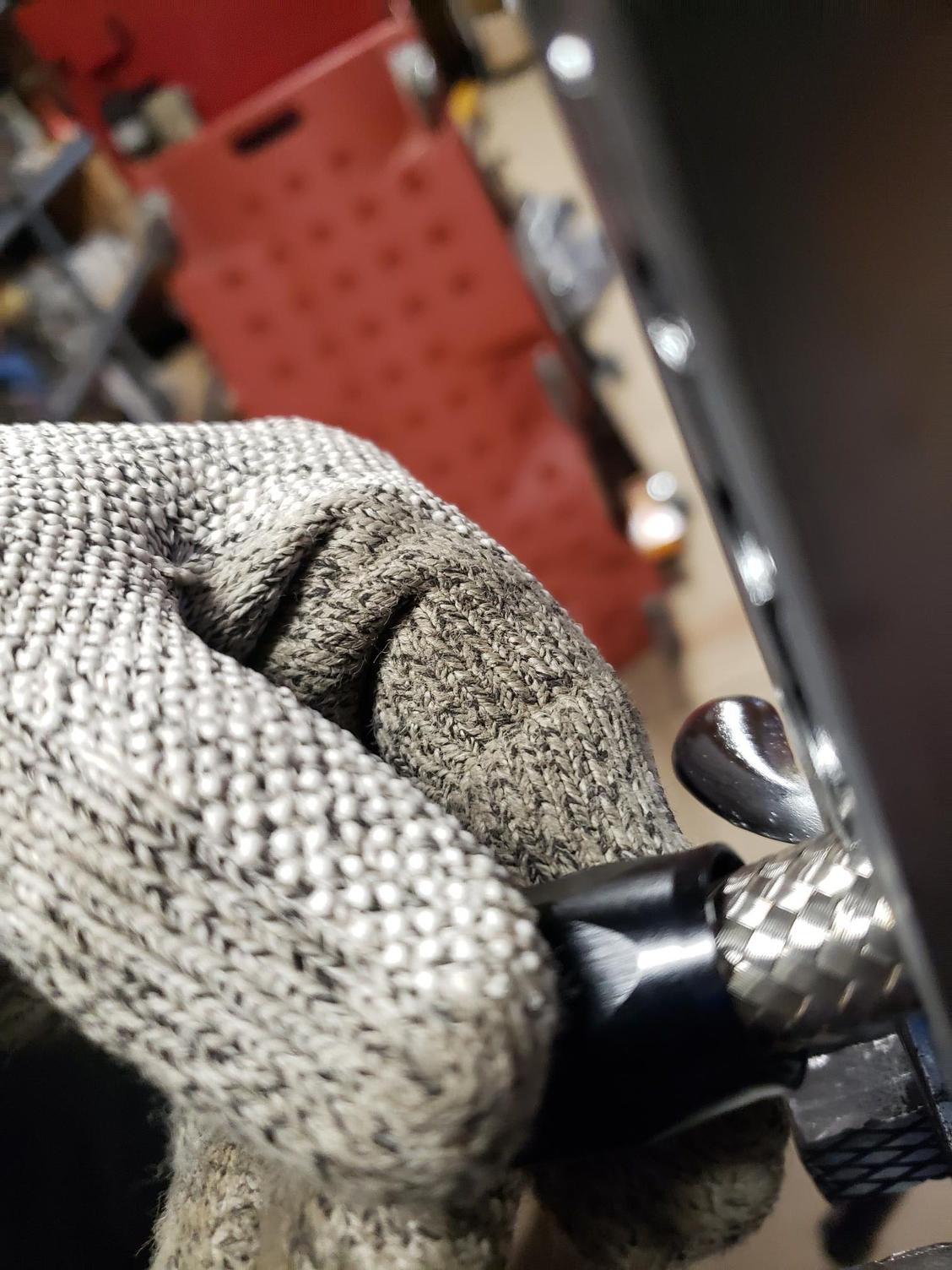

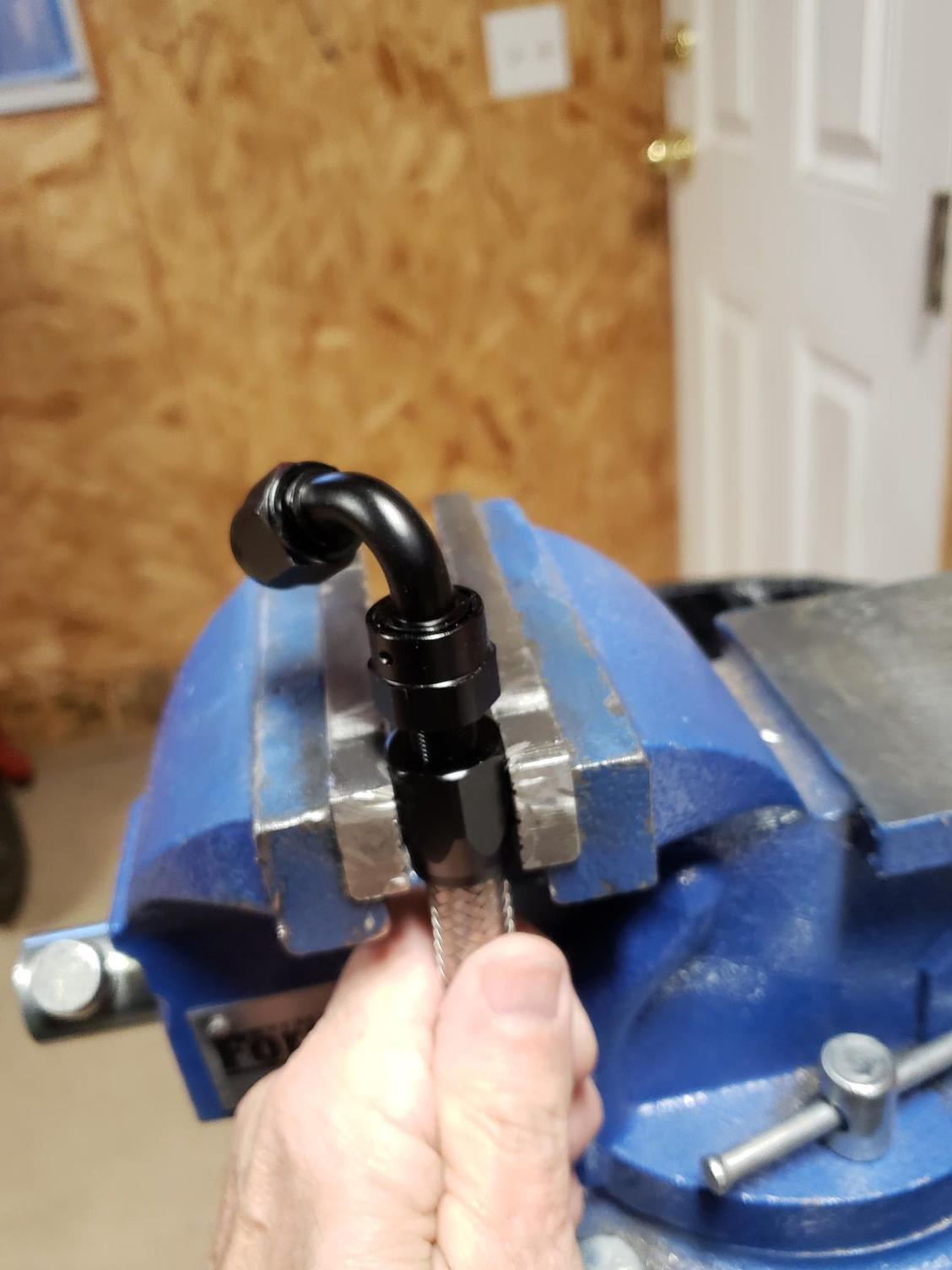

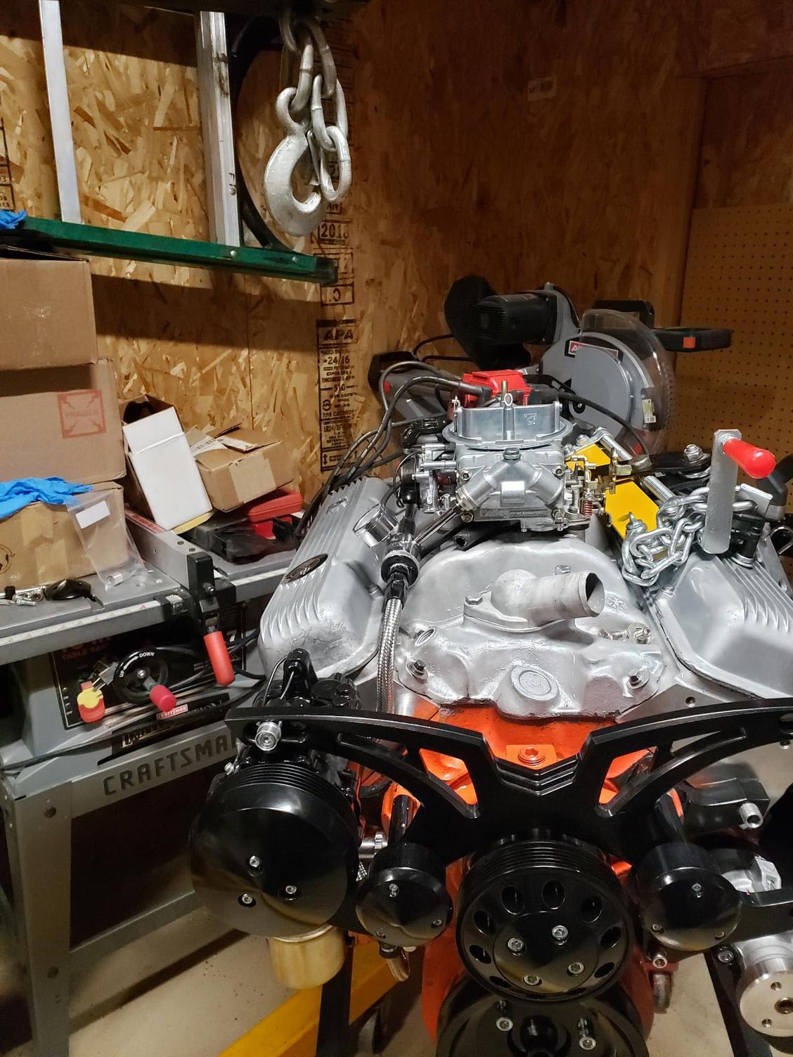

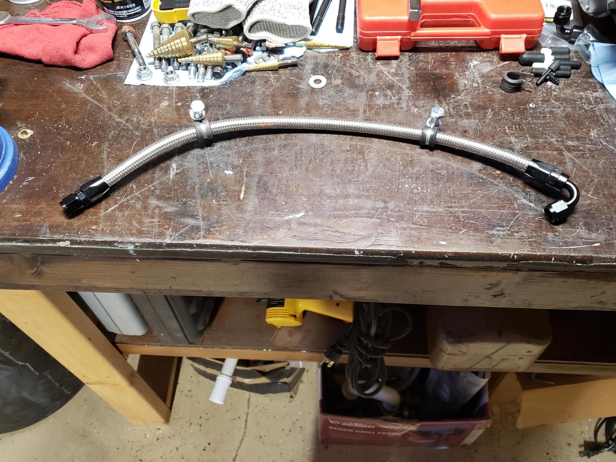

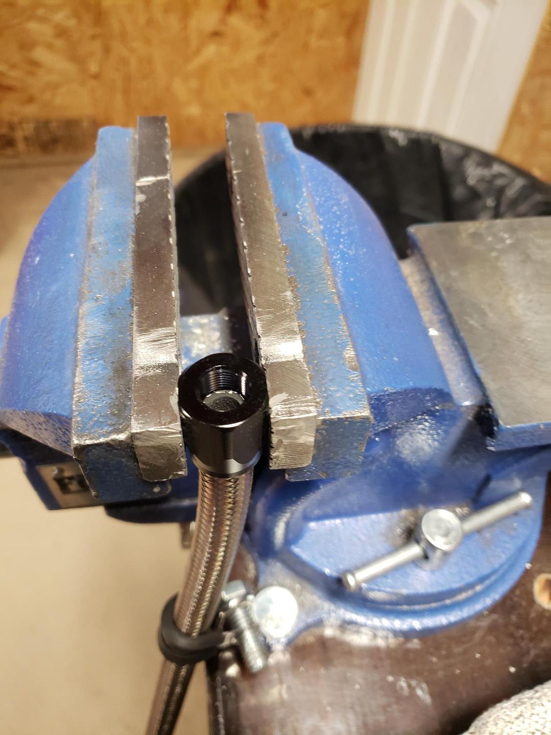

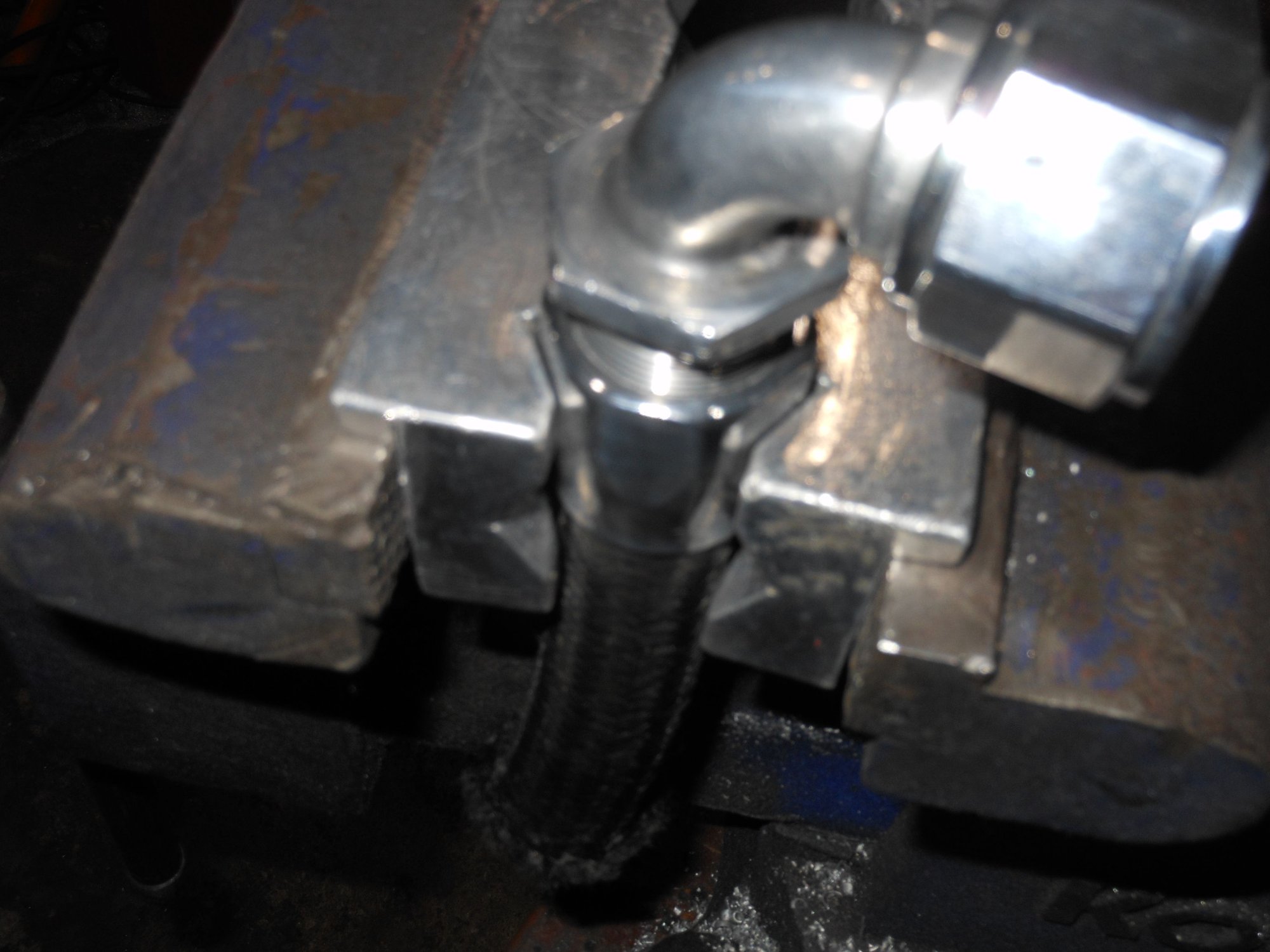

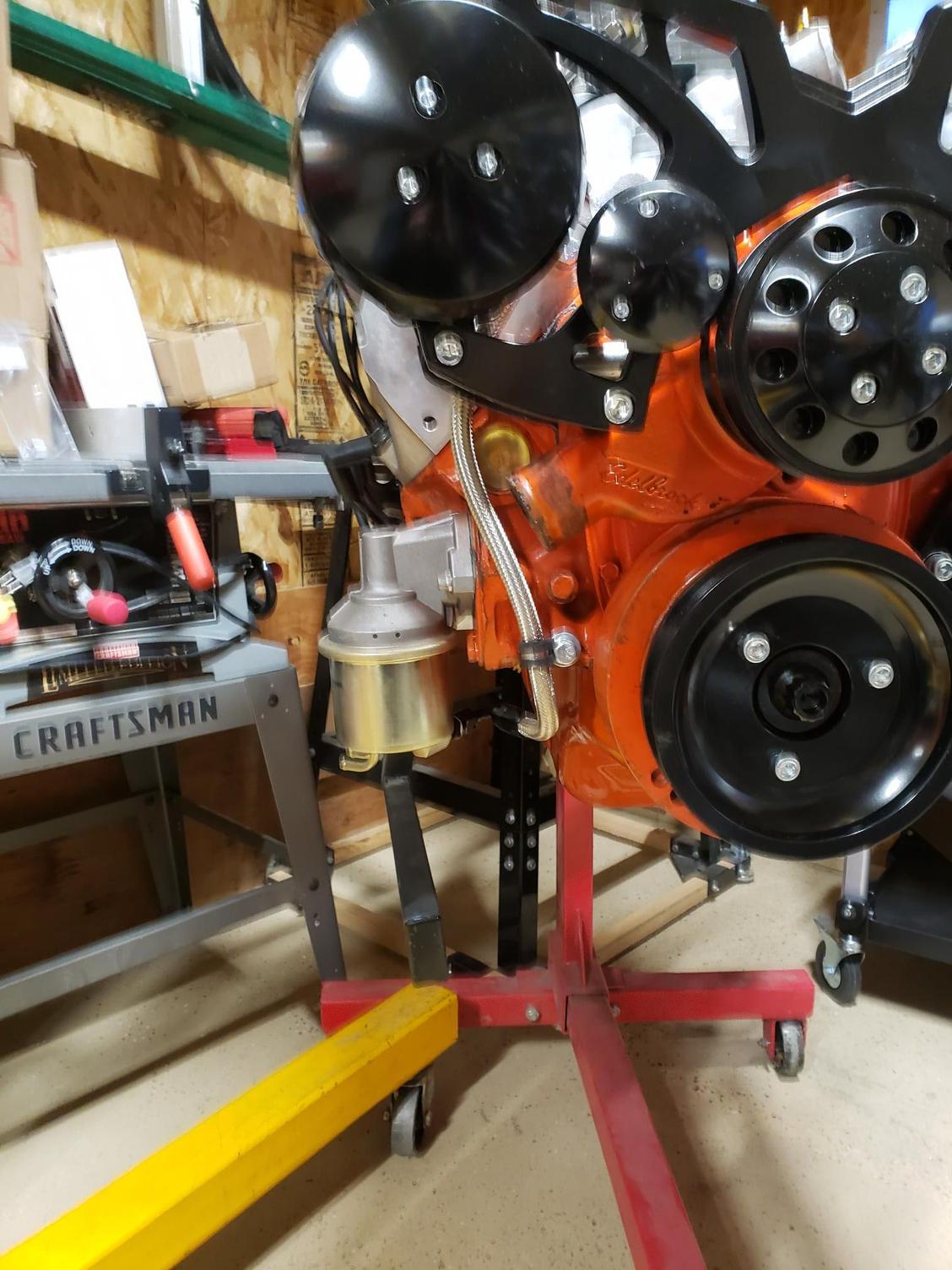

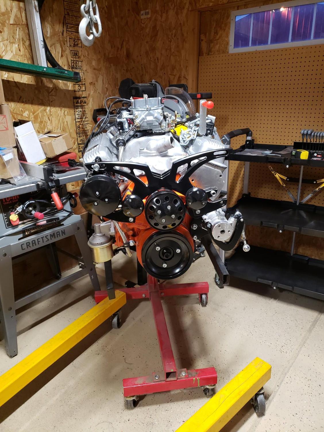

Hi all,

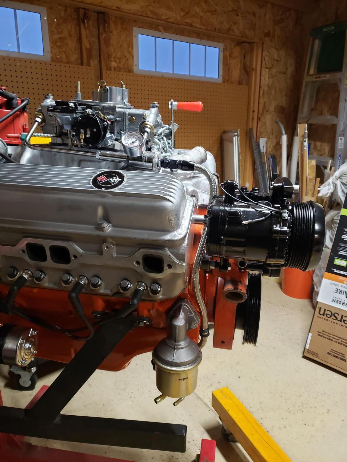

To keep my engine and other parts replacement project moving I needed to run a fuel line from the mechanical fuel pump to the carb. So, I was going to run a hard line and as such bought a flaring kit. I haven’t flared tubing since I was a kid, lol. It’s like riding a bike, right!?

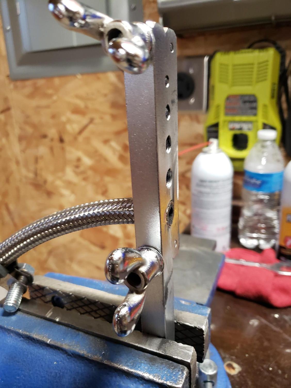

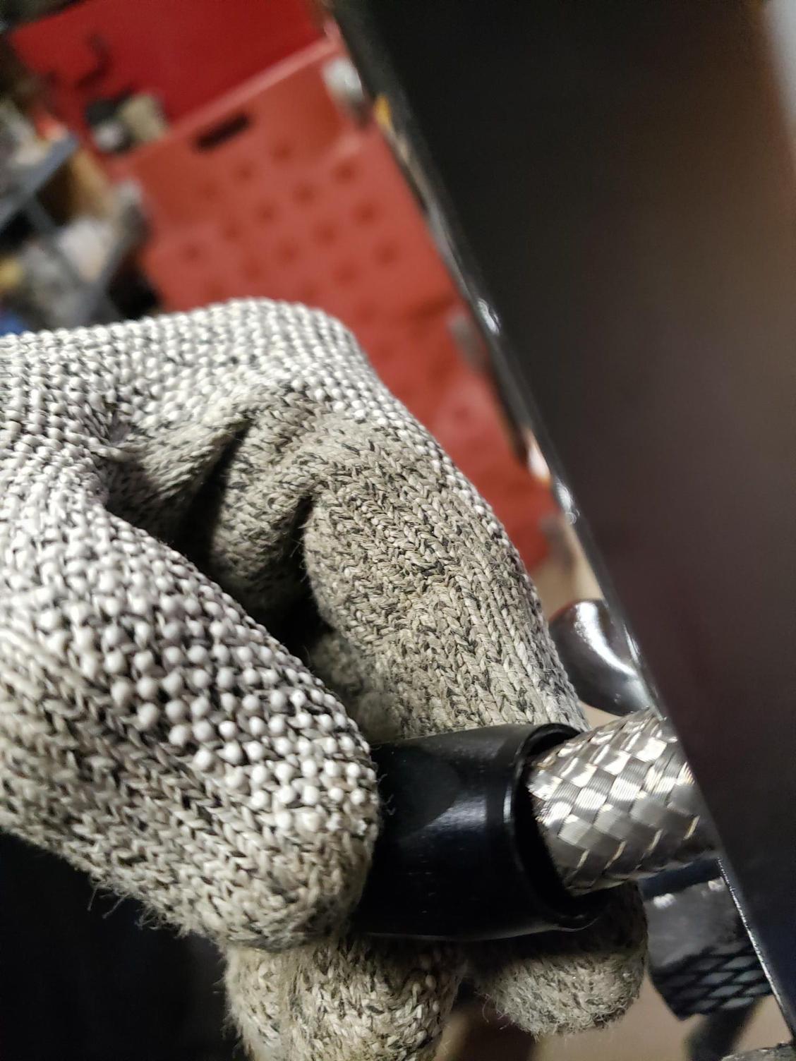

However, I decided to go the 6 AN flexible tubing with compression fittings route which I bought from Summit. Nice kit for a little over 50 bucks. Anyway, I watched a lot of YouTube videos and what ya’ all were saying on the forum on the best way to do this. Well. I didn’t have the right tool to use the hammer and cut method, so I used my little 3” cutoff tool along with using the duct tape over the tubing at the cut point. That cut the tubing just fine but stainless still flared out some and I couldn't get the fitting to go over it.

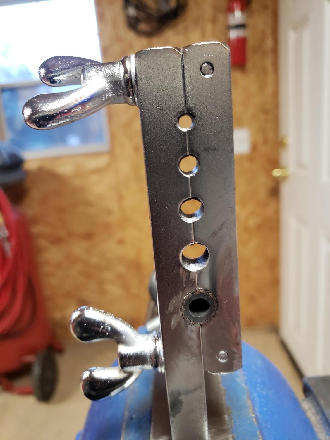

So, after thinking about it I decided I needed some type of tool that would keep the end closed while I was cutting it. Low and behold, their sat my new tubing fairing kit so I put it in my vice and clamped the tubing into the larges hole (1/2” I believe) and cut the tubing up against the flaring kit bracket.
You’ve got to be careful of course as you can ding the metal on the flaring bracket but as one not really experienced in doing this like many of you are, as far as I’m concerned, it’s the cat’s meow! (I know that’s a dumb expression, lol!)
The fittings on both ends of the tubing went on with no issues or any stainless fibers sticking out. Wow! Couldn’t be easier.
Here’s some pix:

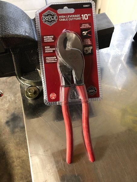

I use something similar, the Greenlee cable cutters.

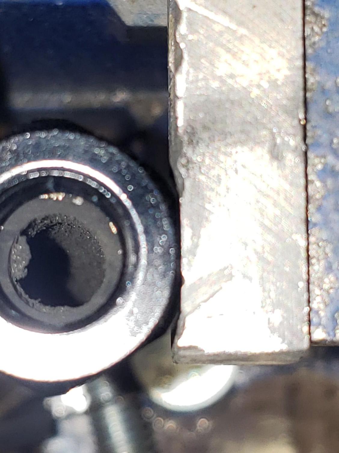

Originally Posted by augiedoggy
Ive done this too and it also works with a cutting wheel.
Only thing with a cutting wheel is it creates a lot of debris on the inside of the tubing (as witnessed in one of the OP's photos), so you have to clean that out thoroughly.
Yes-
My favorite way - a sharp chisel, sledge hammer and a block of aluminum. Nice clean cut and no debris.

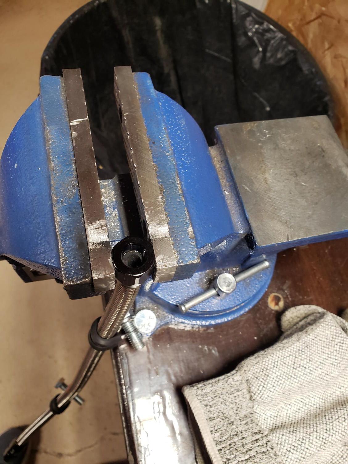

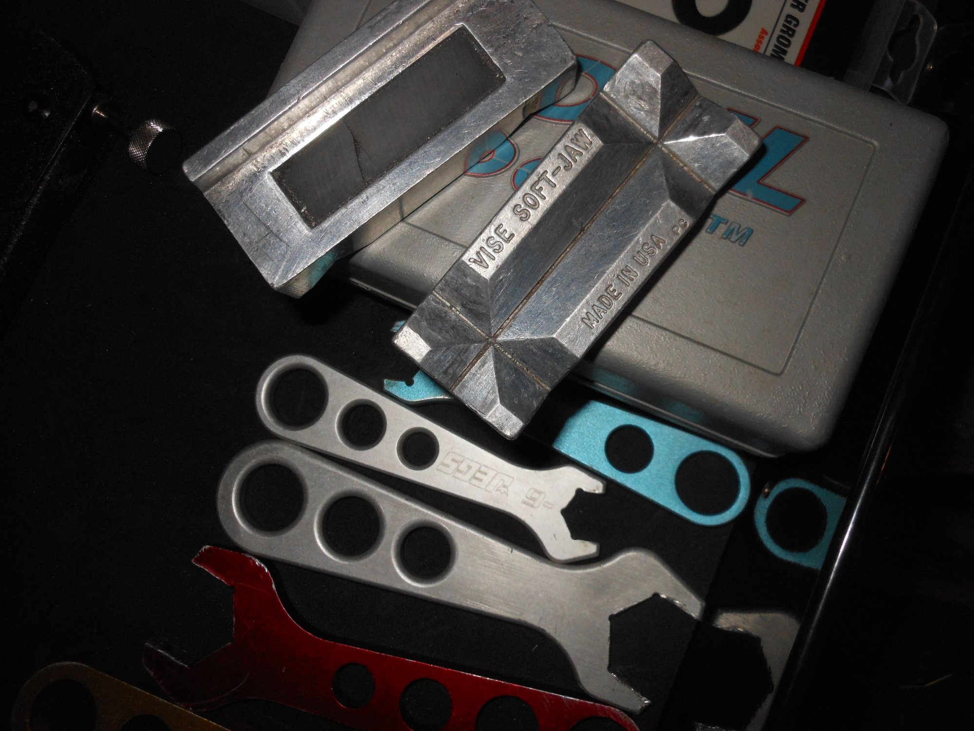

Another tip for when you are clamping the fittings in your bench vice is to use a piece of aluminum angle on each side of the vice jaws to help prevent any damage to the aluminum fittings or their finish.
I use them anytime I'm clamping soft metals in any vice.
Old Jan 27, 2022 | 10:06 PM
Richard454's Avatar
Richard454
Joined: May 2003
Posts: 8,877
Likes: 3,556
From: Fernandina Beach FL
This is the ticket for holding the fittings in the vice- aluminum with magnets- and will hold the fitting in several ways.

Thanks for all the replies on this. Looks I need to invest in some more tools! Yeah, I thought about damaging the parts in the vice but I got impatient and I did see the debris in the tube which I blew out with my compressor, but I didn't think about that as an issue. Good to know and remember.
