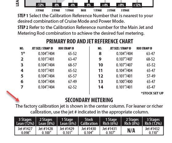

Here is the calibration guide. I am using the stock No. 1 setting. Sounds like maybe go to 2, 3 or 5.
yes, #1 is for sea level @ 59* standard pressure 29.92” .
you’re @ 1300 feet. That means you’ll need to get down to 38*, 29.92” (temp of air to the engine) to get you down to sea level
another consideration is how are you getting the air to the engine? CAI type intake or underhood air with an open element.
if it’s open element then You’re gonna need leaner jetting than cold air intake air. Pulling in underhood air reduces it’s density considerably. In either case, it’s running far too rich.
that 20% to 30% is primarily prior to peak torque. At higher RPM the engine can tolerate the richness, still with a loss of output however.

Yes, standard open element K&N with open top on drop base.
So if I want to go a little leaner on cruise AND power, I should go with calibration setting #3 ?

That chart I posted above is only for the Primaries. Here is the chart for the secondaries which I didn't show:
So maybe go 1 or 2 stages leaner on the secondaries also. Probably some trial and error going to have to do.
I would try #5 for cooler temps normal driving, if that's too lean then #6, kind of depends how much time you spend at WOT. Maybe #6 for track time and #5 other times. #3 for summer temps normal driving and #5 for track time in the summer. See how those work.
Yes, it's likely that the secondaries will need leaning too.
