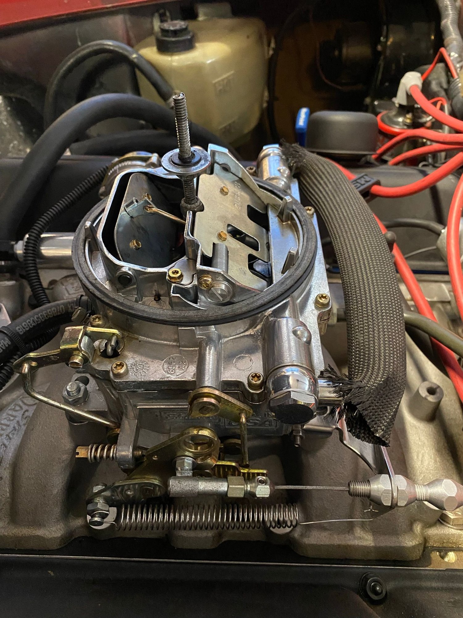

Check and see if you are getting wide open throttle with the pedal on the floor. The older gas pedal arm attached to the pedal are known to bend. As well as having to thick mat or carpet. Use a zip tie as a tell tale for max cable pull if you have exposed cable or het an assistant.
Out of a turn of a slow turn in first gear you should Be spinning the tires easily with that much power without dumping the clutch. Do you have any pics of the cam when you were building it? It should have the numbers scrawled on the end. It just doesnt seem like you Have an aggressive cam that would make 440 hp.
My car in first gear, rolling along slow along a boulevard would spin the tires if you floored it and lifted off repeatedly/ quickly and makes the front end hop. Didnt leave the ground but was fun and impressive.
My car wieghed 3750 ish with me in it at the track

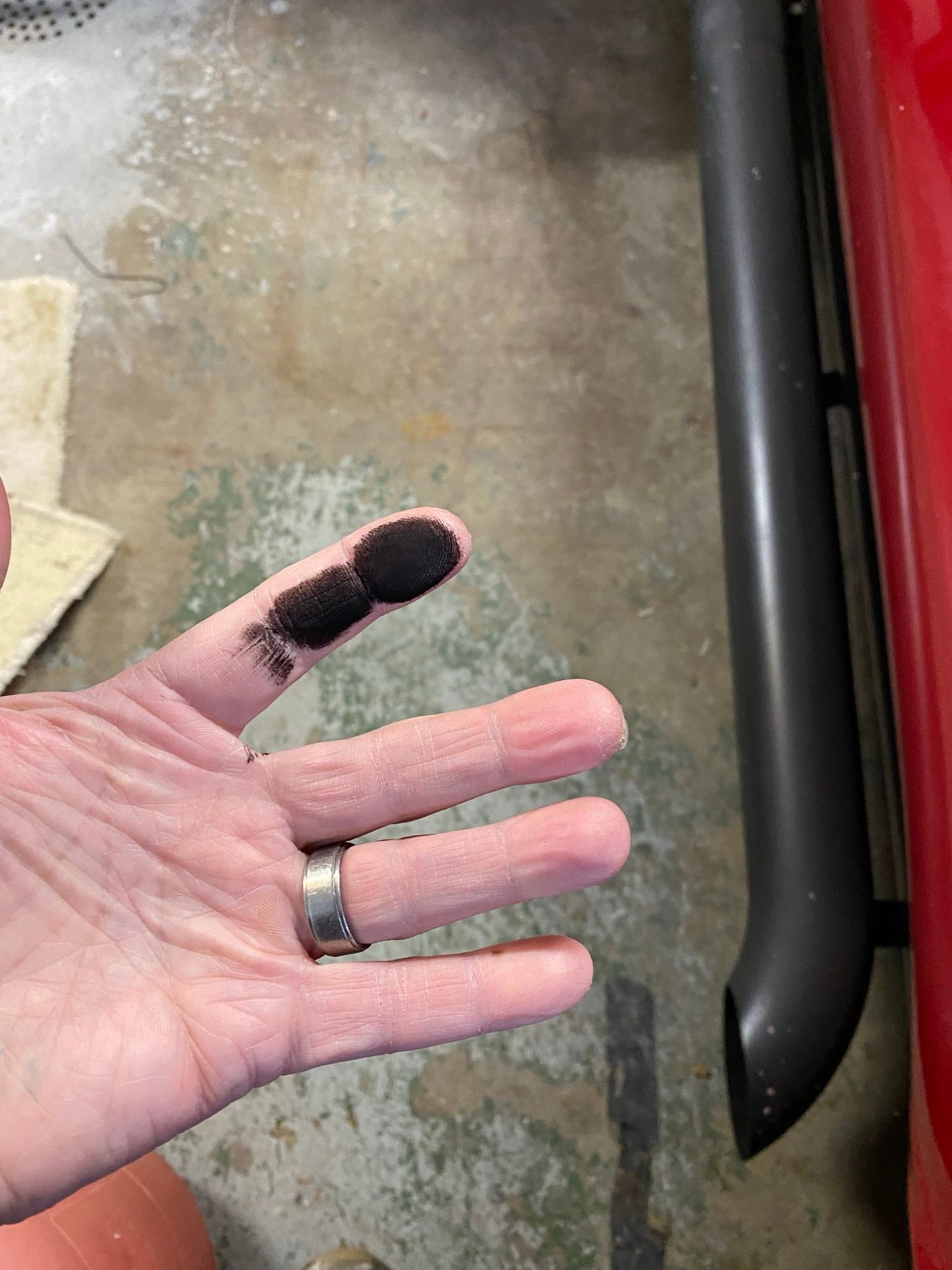

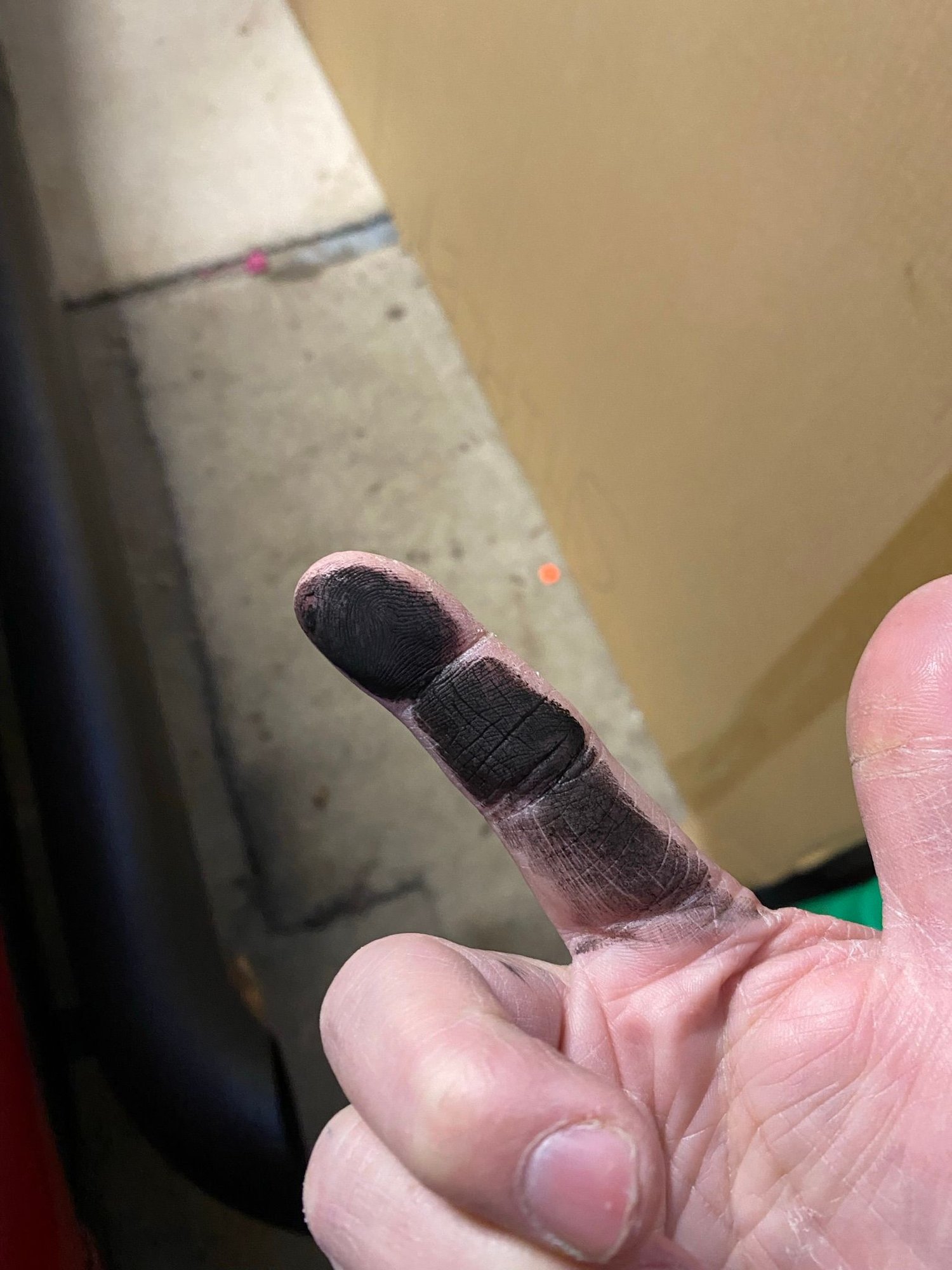

Look at your tail pipes. If you stick your finger in there does it come out with black soot, black finger, lightly black or nothing on your finger?

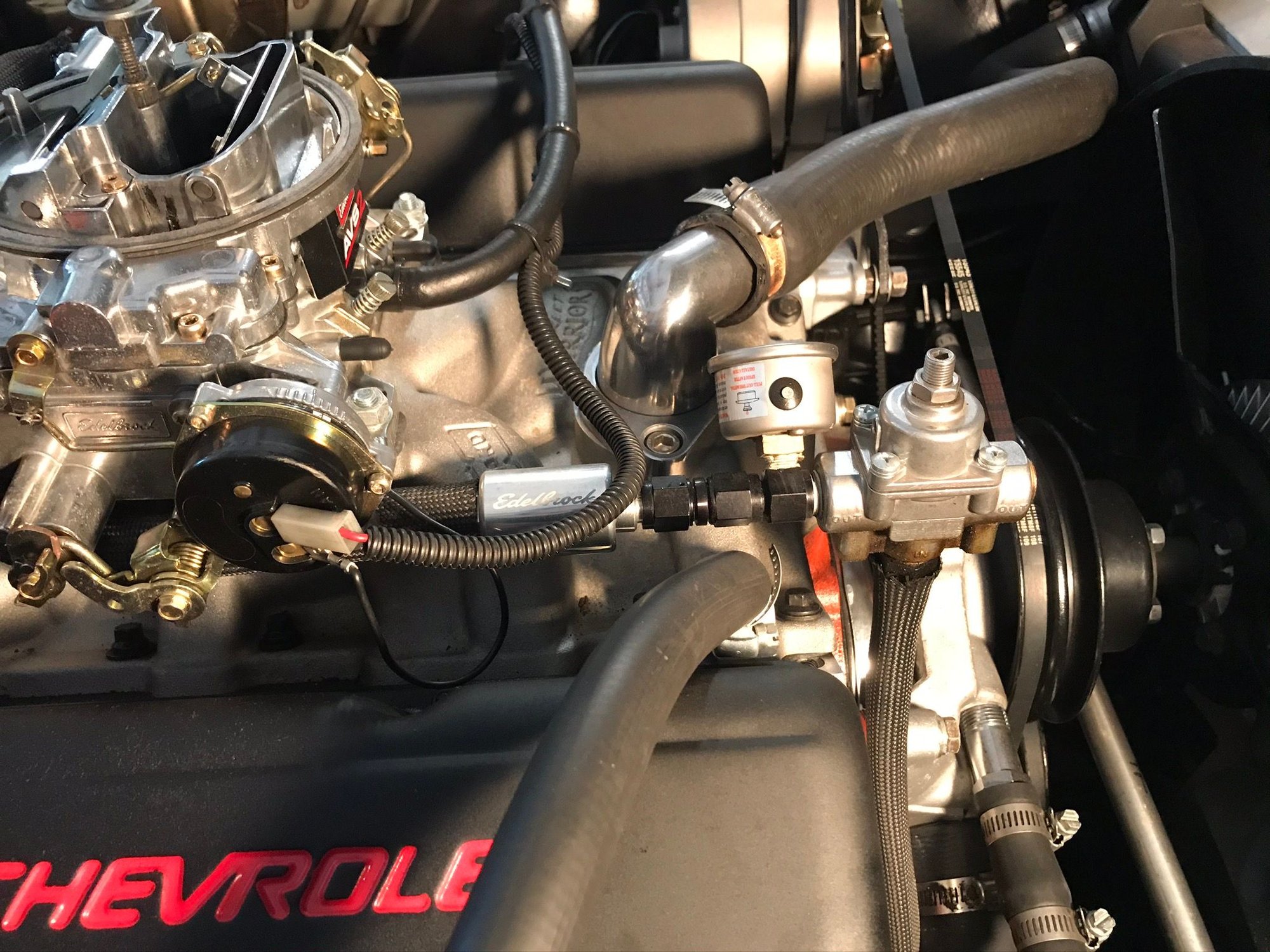

Couple of pics cuz we have to have some pics:
OK just went out and checked it. Had the wife floor it and check the throttle to see if it had more travel. Nope.. looks good. Definitely pulling it all the way.
Pedal to the floor
OK just did this. Black soot/finger on both sides. It usually smokes a tiny bit on startup after sitting several days but nothing major. Doesn't burn oil.
Pics:
Driver side
Passenger side
Lol at my dry *** hands in the winter
