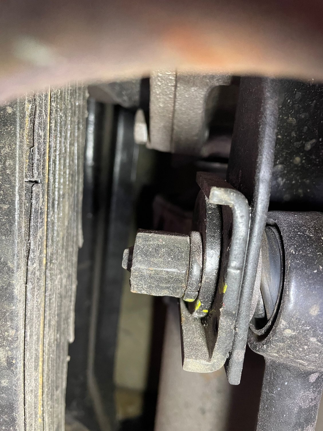

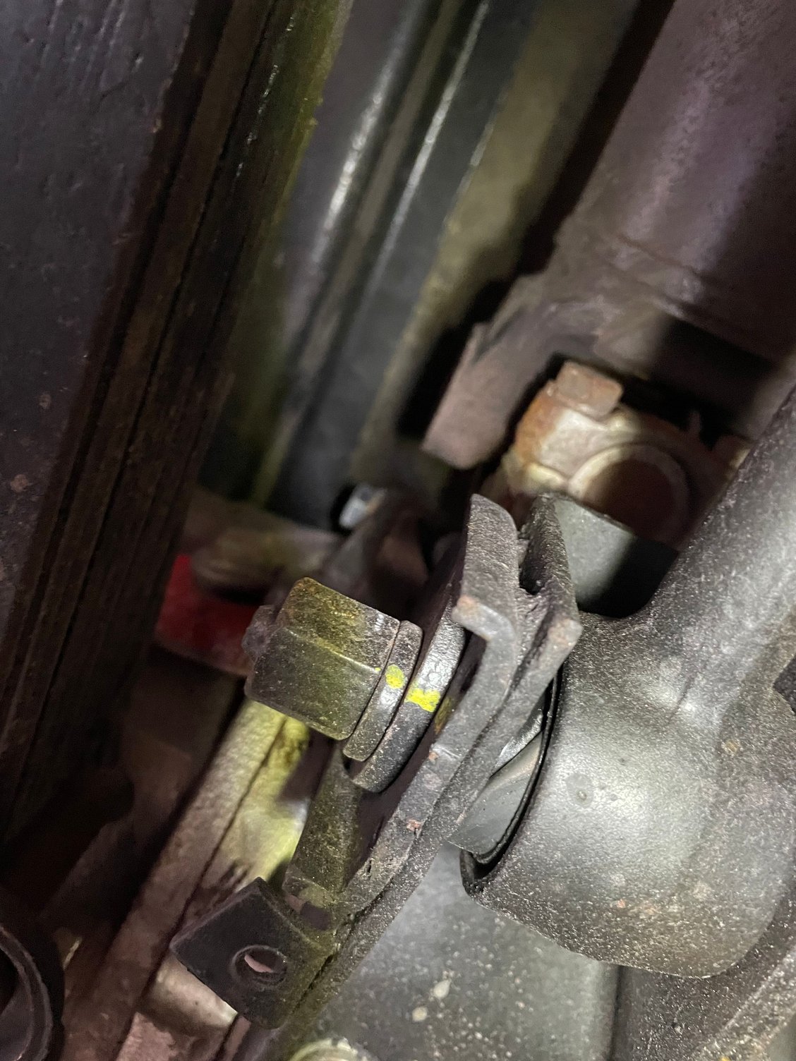

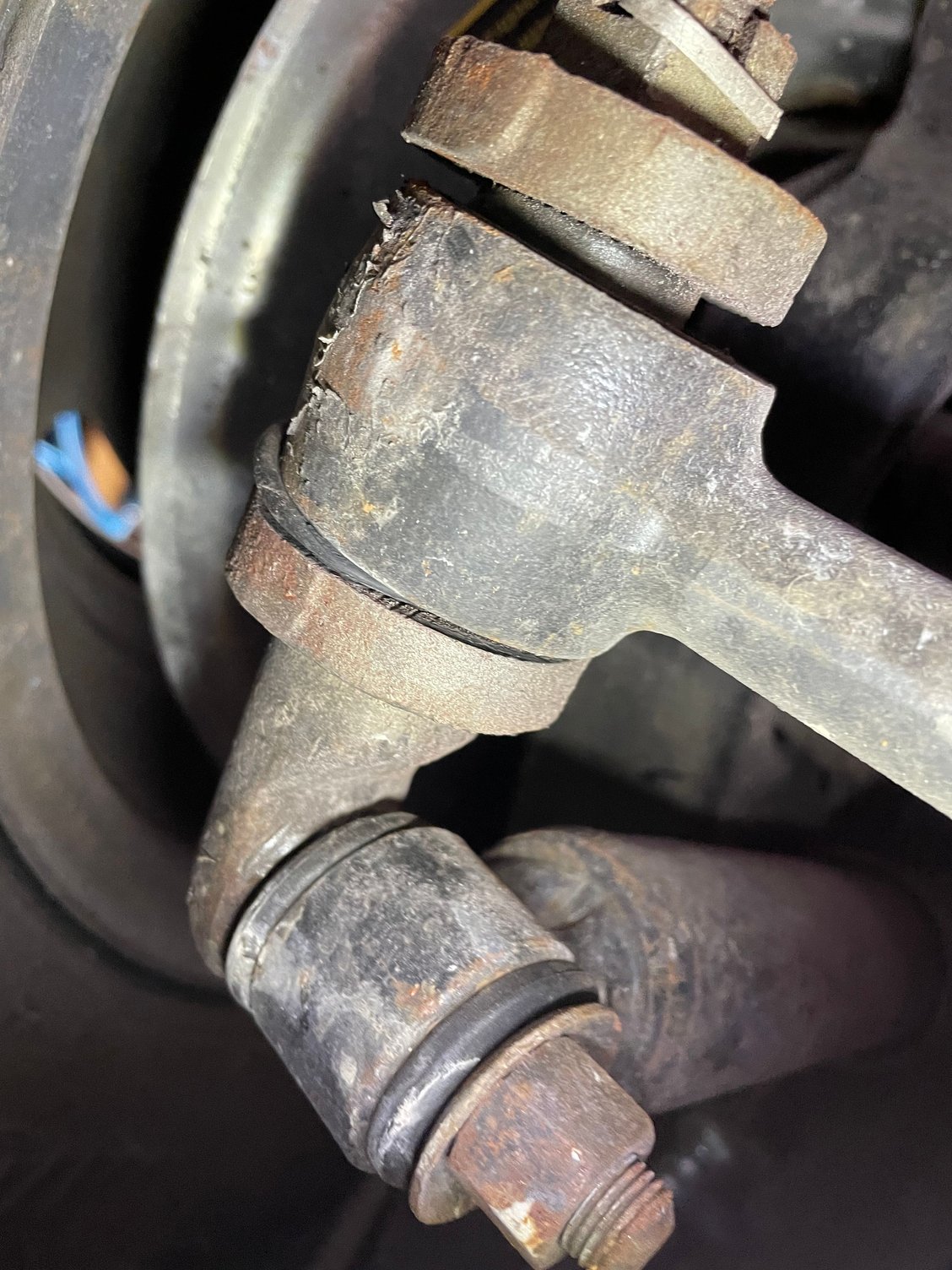

I wonder if these could have something to do with the vibration? One of them did move from adjustment as I witness marked them

Those pics you posted point to an issue that should be fixed, but that's likely not the issue. I like what FORMAN posted above as a possible solution for a fix. The most likely cause is the u-joint angles at the transmission and the rearend....as said before, they need to be the same, but opposite angles. Check this using a magnetic angle finder on the flats spots of the u-joint ends....using a nut as a spacer to clear the stepped end of the yolks.
