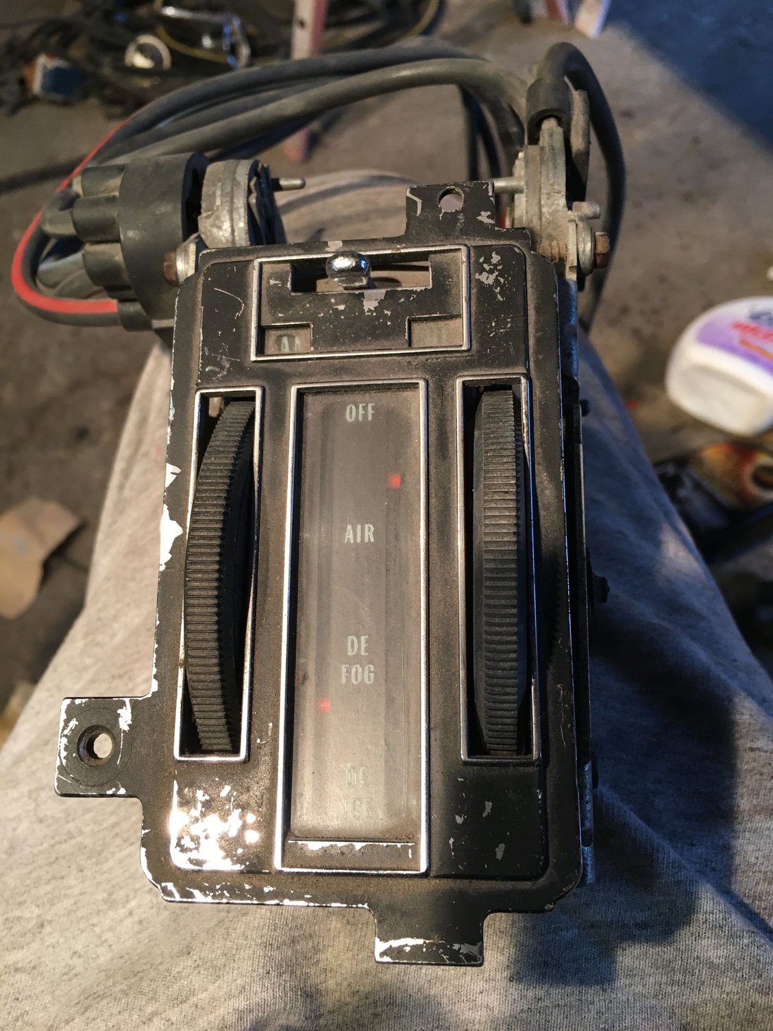

So I have my interior semi-apart as I continue searching for my battery drain, wondering how I can refinish the black paint in the interior parts as you can see in the pictures. My very basic questions (this is my first time repainting car trim):
  • Do you need to strip off existing paint, if so, what's the process/product recommended to do this?
  • How do you clean the parts beforehand, do you use just rubbing alcohol?
  • Do people do spray paint or paint on with a brush? Do you need any kind of primer?
From my search on the forum, people like a few different paints (Krylon 1613 semi-flat black, Dupli-Color "satin black", John Deere Blitz black, SEM 39143 Trim Black, Rustoleum Satin Canyon black). I'm planning on trying the Rustoleum Satin Canyon black since it is relatively affordable and available locally.
Any help would be greatly appreciated.
peeling paint
paint around air vents is peeling

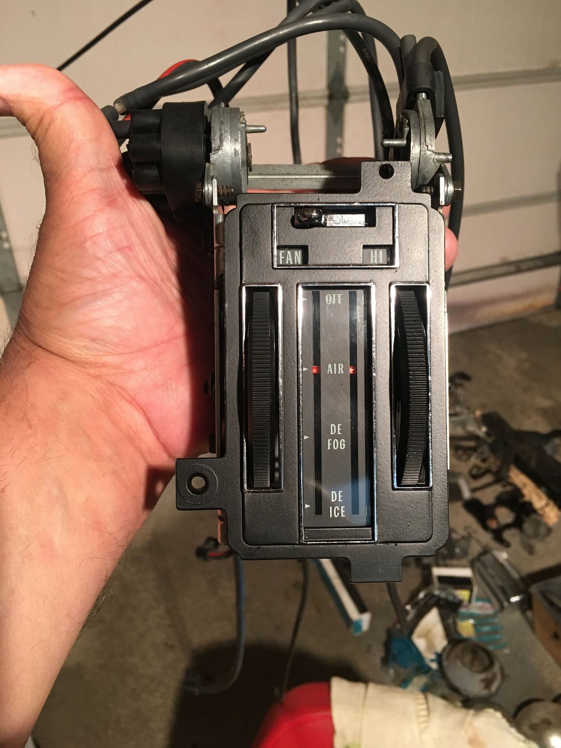

I found this Rust-Oleum product to be a perfect match to the original sheen. It is a primer and paint so it is a one step application.
I stripped off all the original paint, then cleaned with lacquer thinner, scuffed with a grey Scotchbrite pad, taped and sprayed 3 light coats, about 10 minutes between coats.
Take your time and be sure to get into the corners to clean every surface to ensure good adhesion.
53 years of use
Stripped, cleaned, scuffed, taped.
The best match (and I’ve tried several others)
Ready for another 53 years!
53 years of use

Thanks for all the details with the pictures too 69L88, that black really did come out well. I'll switch to the flat rustoleum instead of satin and follow those directions when I repaint these interior pieces. May be several weeks, need to fix tachometer, speedometer, and a few other electrical items.
53 years of use
I forgot to ask, how did you strip the paint / using which product/solvent?

Truth be told, I had a small quantity of methylene chloride stripper in a spray can but you can’t buy that anymore.
Most strippers today aren’t worth a damn but I’d head down to your local hardware store and see what they have. The good news is that the paint you are removing isn’t adhered to the parts all that well.
Just take your time and don’t rush it.
