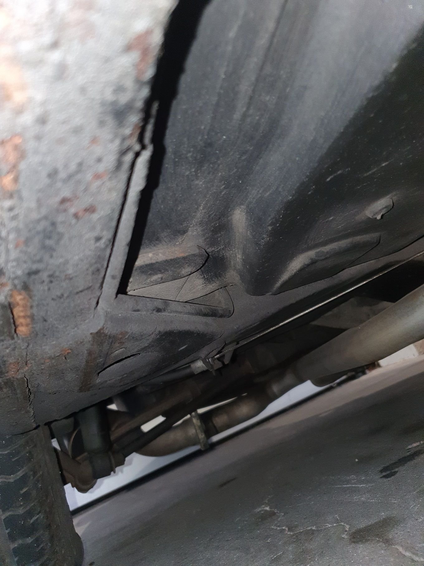

On the frame rail at the very top of this pic' (above), does it look like rust has tried to push the seams apart? Is that a deal-breaker?

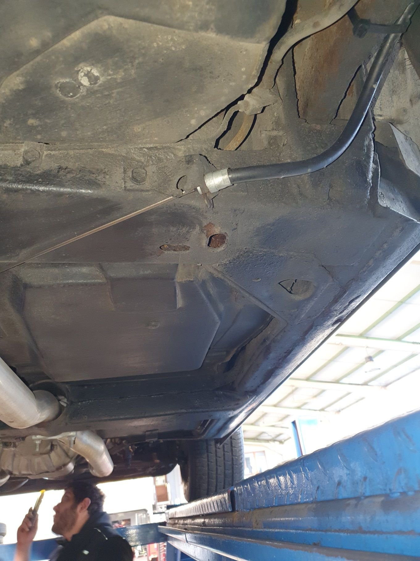

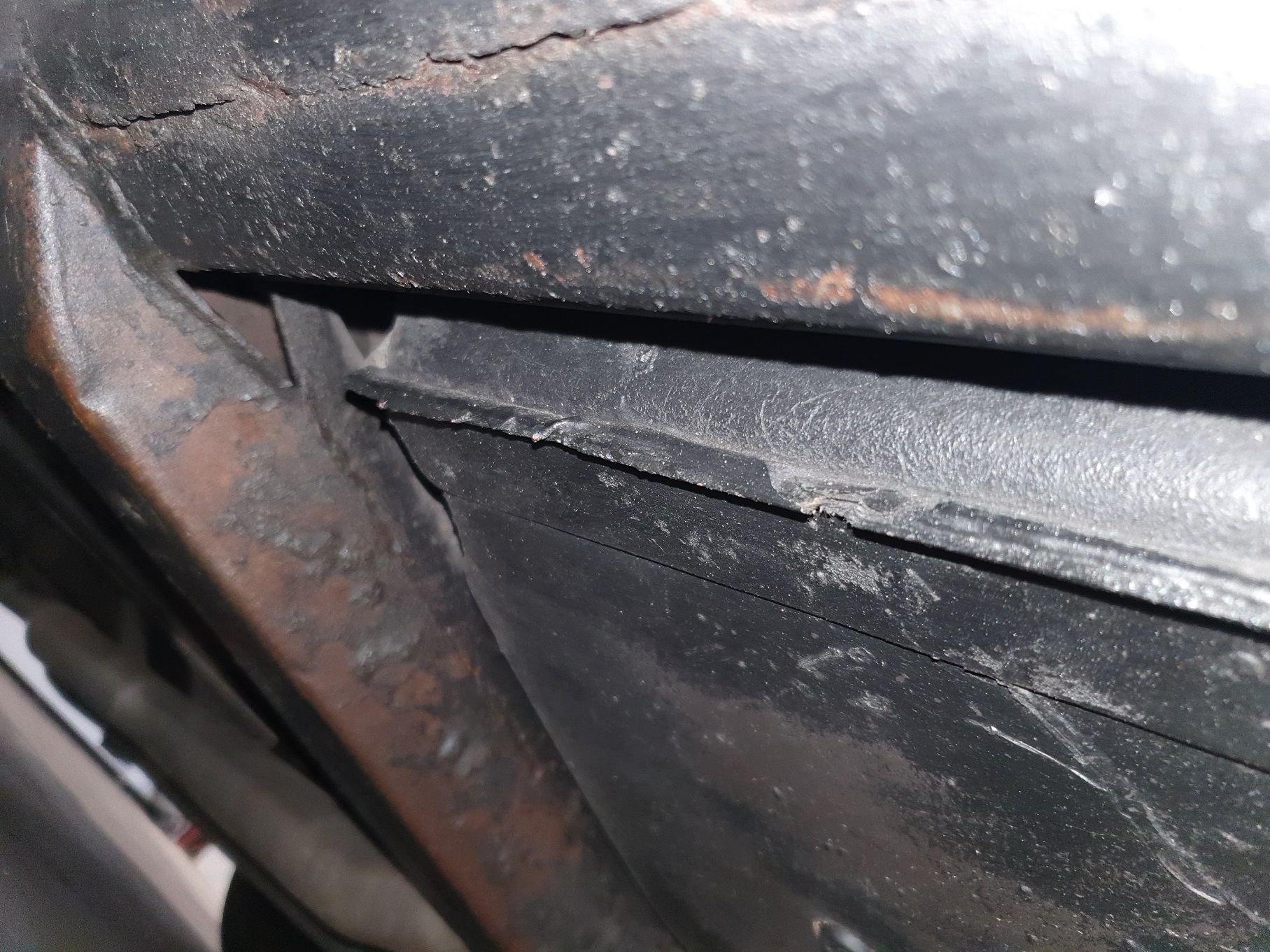

Is that rust on the frame rail (seam) at the far left (above) an indicator of excessive (deal-breaking) rust?

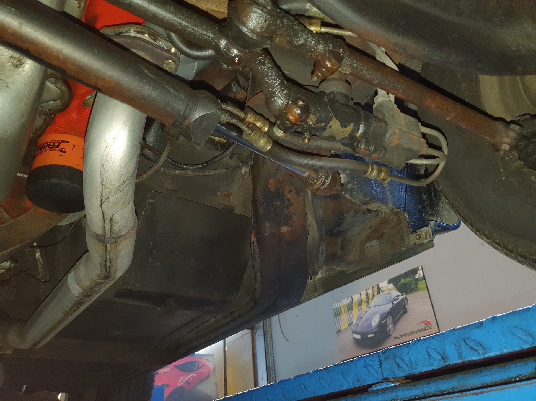

Just above the wall pic' of the Porsche, is that a rusted-through hole that I see? (I'm aware of the rather wet power steering stuff)
Zooming in on the 2 factory holes in the frame (above) allows one to see the internal rust there. Is this a deal breaker or can I soak the innards with Waxoyl/Dinitrol/whatever and sleep well at night? Other factory holes show similar rust.

I see nothing in those pictures from a frame rust standpoint that would cause me to walk away from a purchase. All normal for a 51 year old unrestored frame.

I agree with Mr. D that I don’t really see anything too bad there at all. Having said that, I could never recommend anybody buy an old car without getting knowledgeable eyes on it. The birdcage should be inspected, as repairs there can be worse than frame replacement. I know where you are might be tough to find someone that can inspect it for you, however a sight unseen purchase would be too big of a gamble for me.

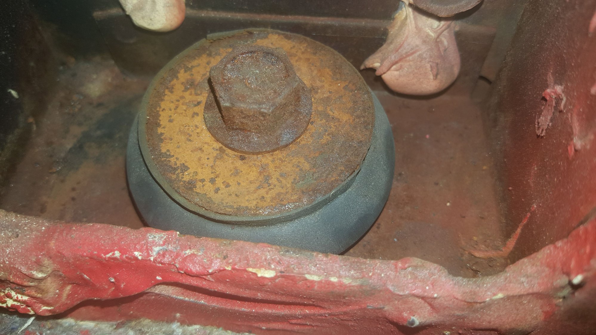

If you pull off the kickpanel and look at the body mounts you will be able to check the birdcage structural integrity. If you see rust there it will be VERY difficult to repair.
For example - just light surface rust here is not an issue. If you see a pile of rusty chunks down in there around the body mount cushion you should probably just walk away.

Be sure to pull the #3 body mount covers off in the rear wheel wells and inspect the #3 mounts also.

Yeah I was thinking the same thing that the frame isn't that bad. I have seen pictures of frames that have large chunky rust all over. This frame looks oily even - which helps! Like you say though, the seams look suspect. I would just take a close look at them but judging from the overall condition I would think they are OK. Hard to tell from here if the seam is splitting. Note that the welds from the factory were not all that great to start off with. Good luck!
