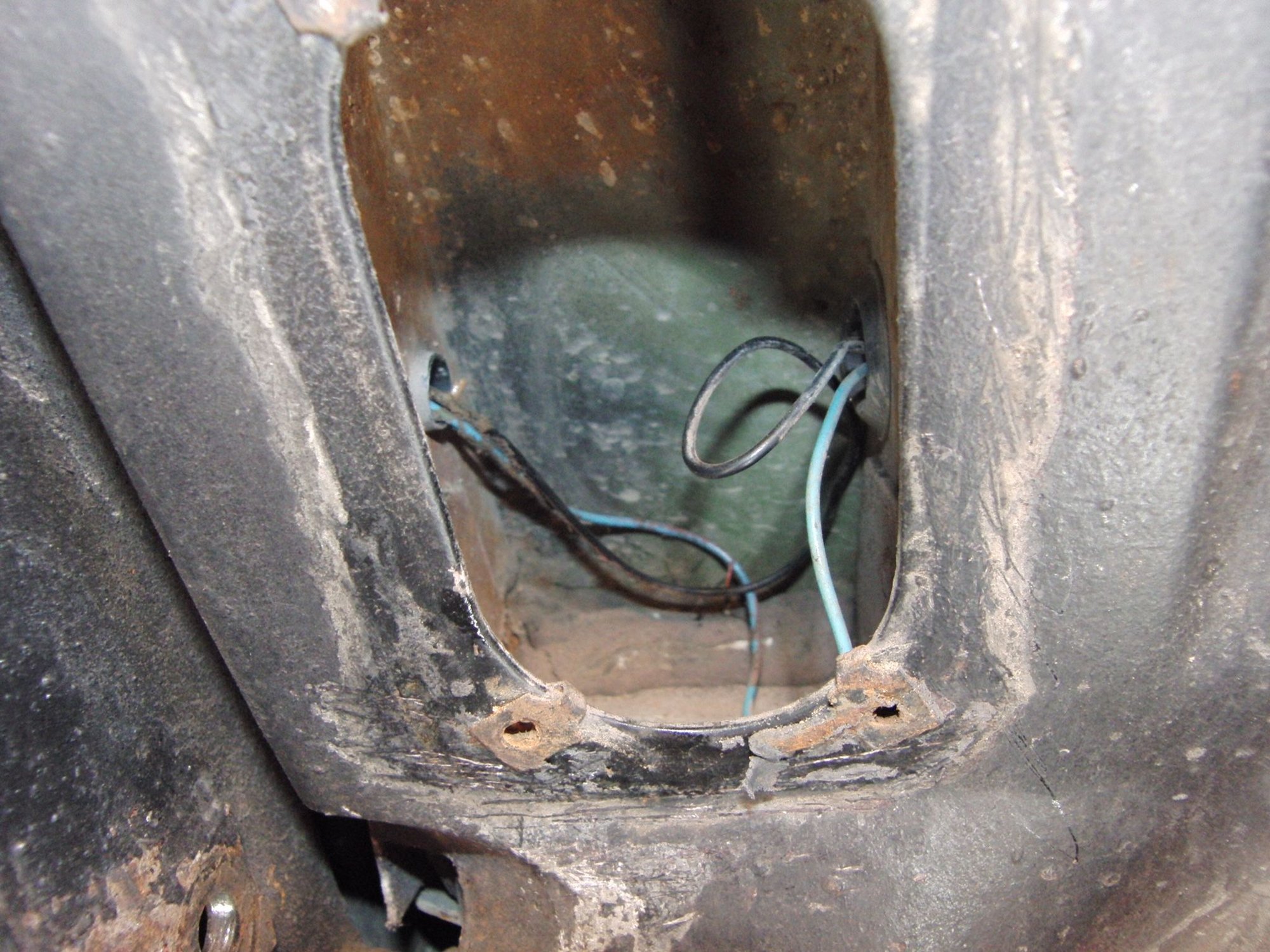

If the dealer is that confident have one of his guys pull a piece of windshield trim to see some of the birdcage. He probably wont but...
Youre doing the right thing getting it up on a rack. Youre seeing what the car really is, not the paint job.
Surface stuff...i dont like either but as long as it isnt flaky looking or holes youre probably ok.
I get a lot of crap for saying "its just a car" but seeing it from the underside as you see...yup.
Easy to get caught up in the paint interior, lipstick I call it.
Good luck!
Check the bushings on suspension front and rear..if they are old that is absolutely a bargaining chip. Not super easy/cheap and makes all the difference in the world how these cars handle track and drive. Know more than the seller if you can!

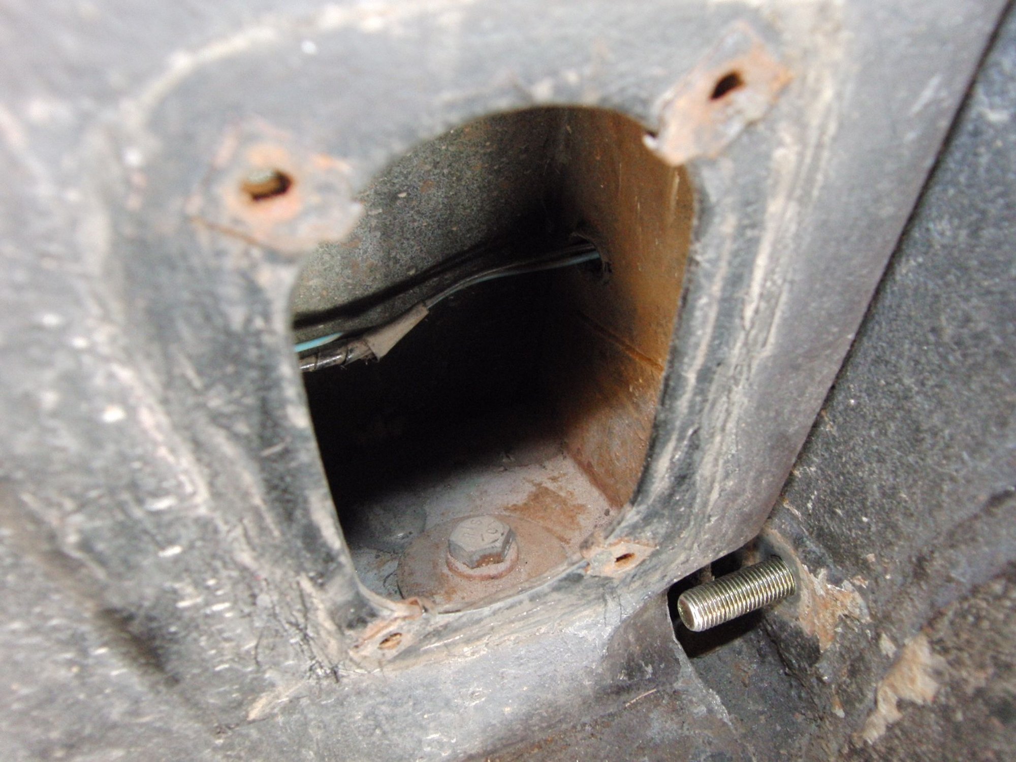

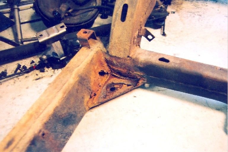

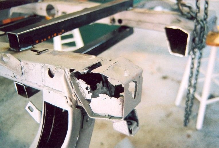

There is no frame rust in the photos above. This is what frame rust looks like:
I bought the car anyway and just fixed it.
Lars

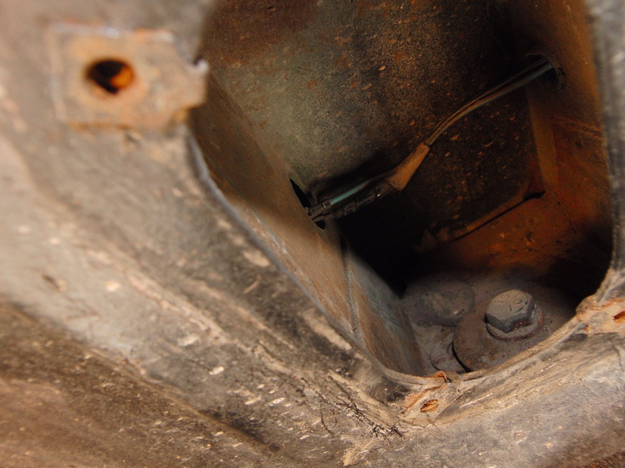

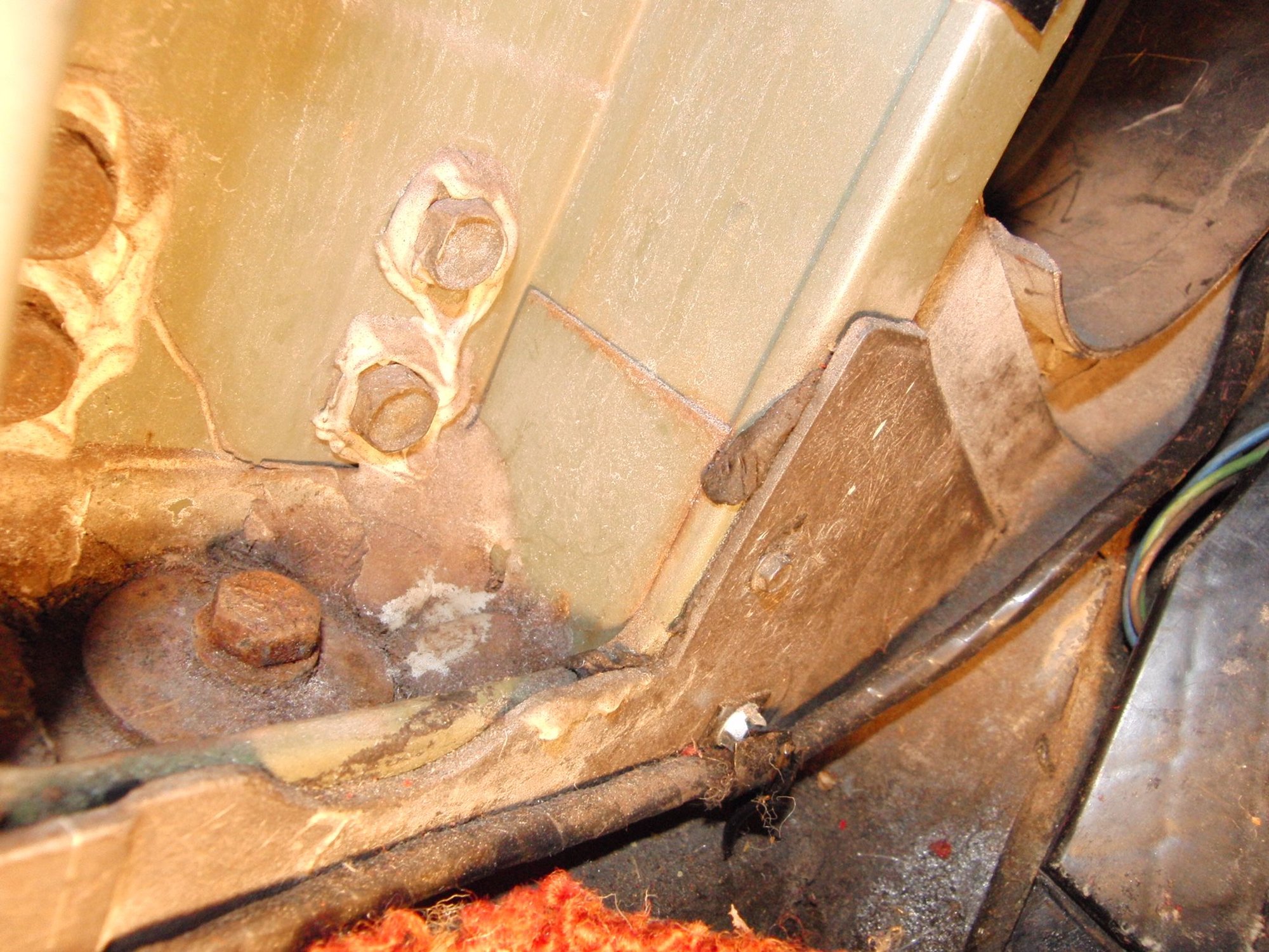

In your photo at the engine and Porsche poster, the area you're asking about isn't the frame. The yellow arrows show the inward curving frame to accommodate the front suspension. The blue arrow is a bolt-on triangular "splash" panel, that yes, does look like it has an irregular hole where one shouldn't be. This panel is easy to replace if you desire.
For any area you are concerned about, tap on it with a hard object, like a screwdriver to "feel" the structure. If the screwdriver easily chips off, crumbles, or enters the metal, then it's quite rusted. Surface rust won't chip off anything other than a very fine powder. As everyone else said, there's nothing in these photos that are concerning.
Now, inspect all around the windshield with a flashlight, looking for a layered, rust-colored, crusty look to the structure behind the glass. Also look at the chrome trim where the convertible top or t-tops latch to the frame - this trim should lay smooth and not look like something is pushing it up from below -- which would be happening if rust is swelling the birdcage metal.

Run your fingers across the top of the windshield, on the inside, up tight to the trim. Should feel 'smooth' and no rusty bits fall out.

Your photos look good to me. Now having said that, really need to pay a C3 knowledeable person to inspect for rust. I take a screwdriver and hit on the frame everyplace accessible and see if it sounds like ringing metal and not "thud" rust. Also check keyholes in frame and see if the shape looks original and crisp. And since the birdcage is sheetmetal, (maybe 1/16" original), check it throughly. You can remove the kick panels and look up the A pillars plus study the edges of the windshield glass and put a white sheet on the floorboards and slam the doors a few times and check for rust flakes to get an idea of the windshield frame condition. Also pull on the windshield a little and see if you get excessive flex. Even so, you can have holes in the windshield frame under the glass. Ask if windshield was replaced in recent memory. All can be fixed and no C3 is zero risk. But if you do the checks above, and it passes, odds are good it is ok. Hope this helps and this is what I do.

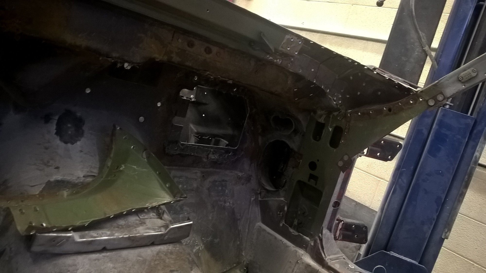

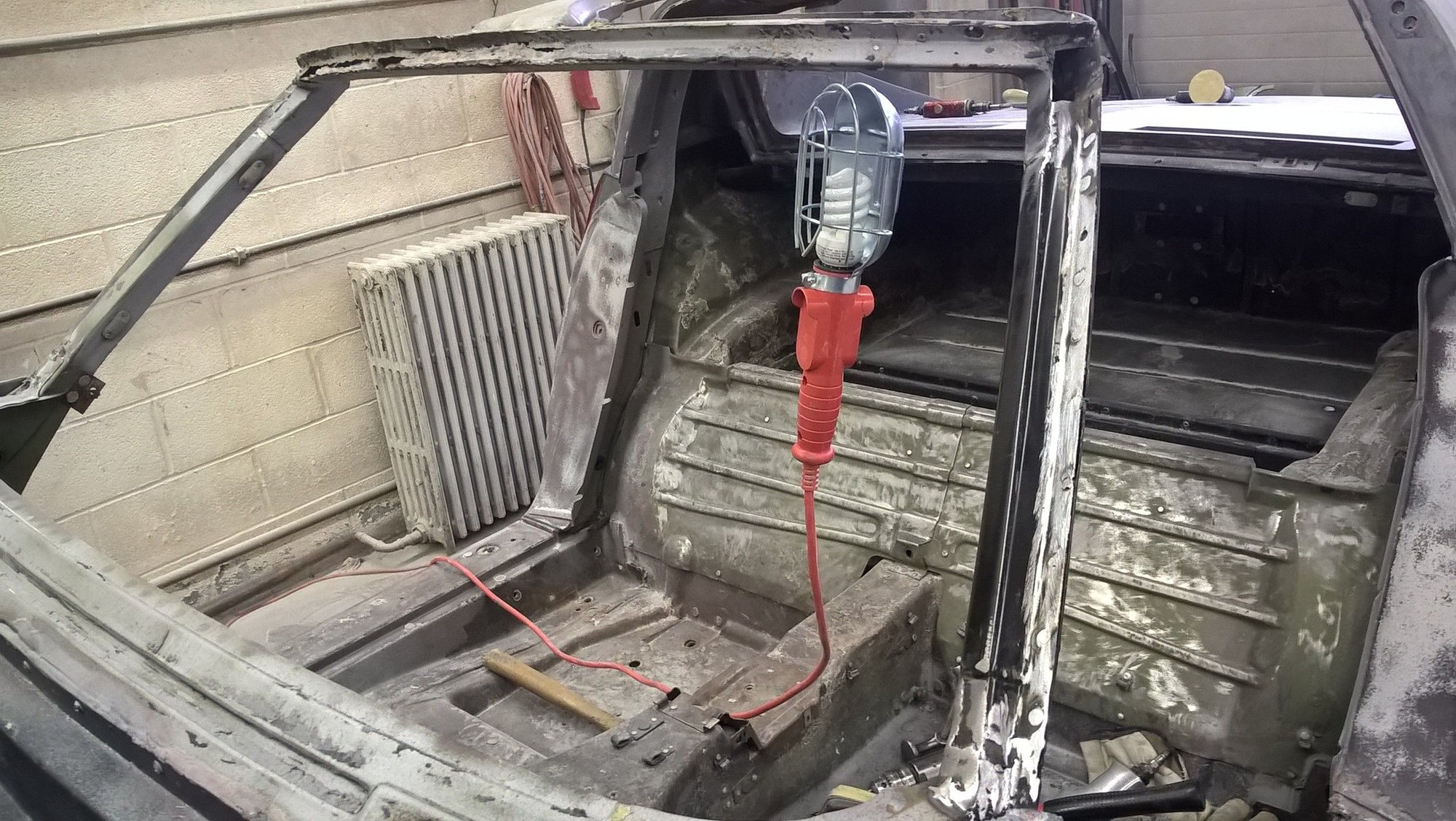

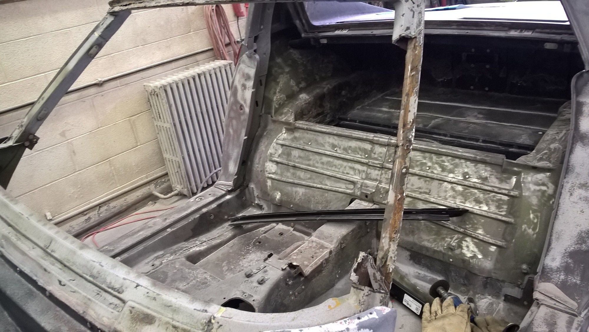

A rusty birdcage is not necessarily the kiss of death, either. If you lack the skills and equipment to make the repairs, yes, it will likely put the cost of repair out of reach for a lot of folks.

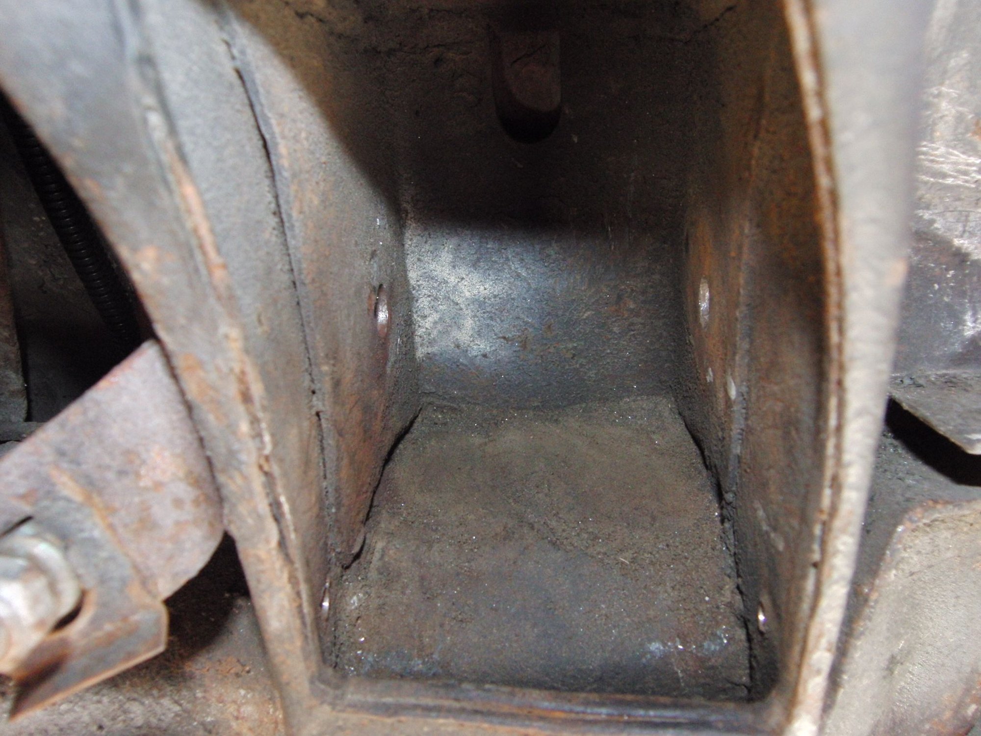

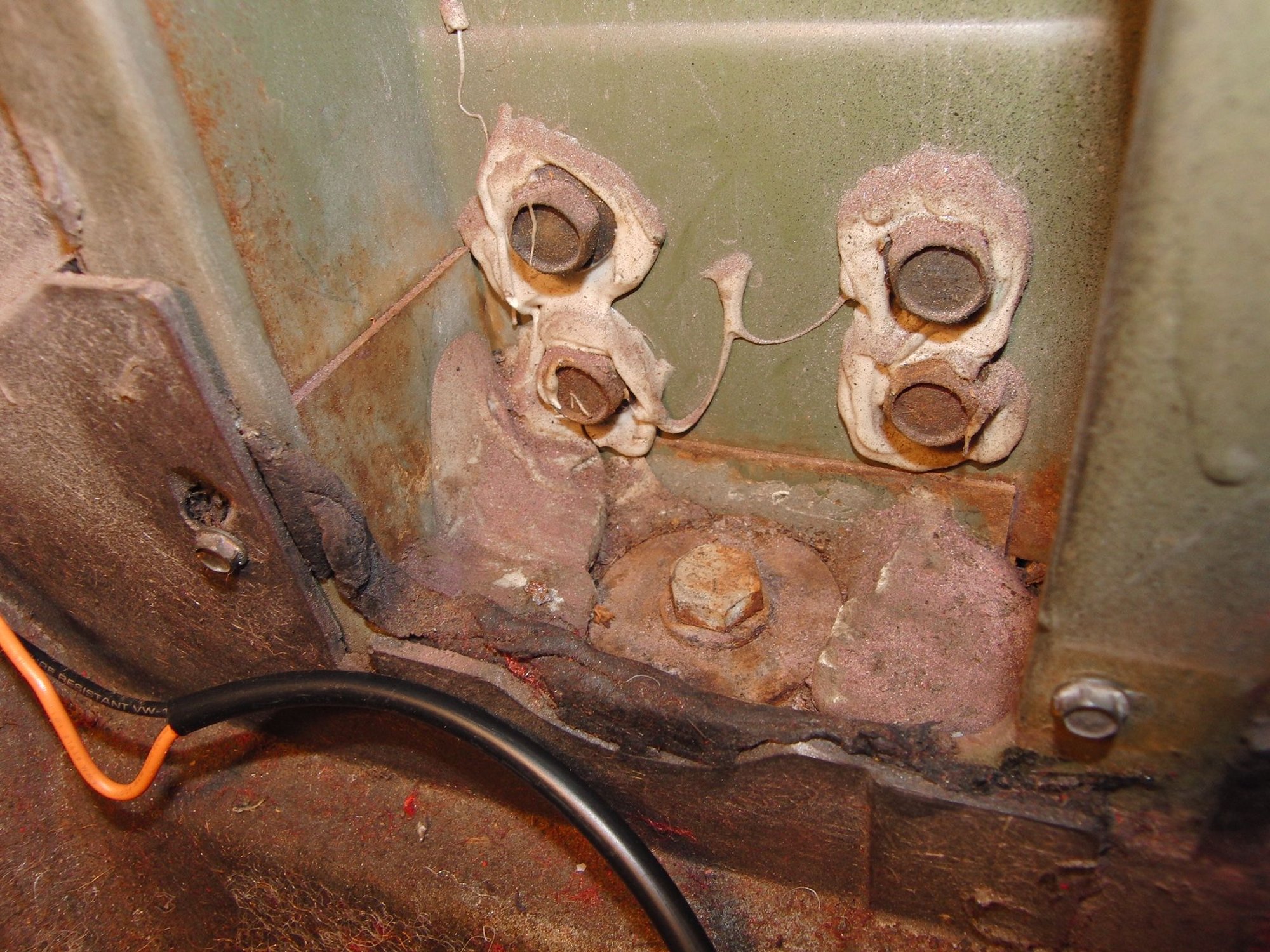

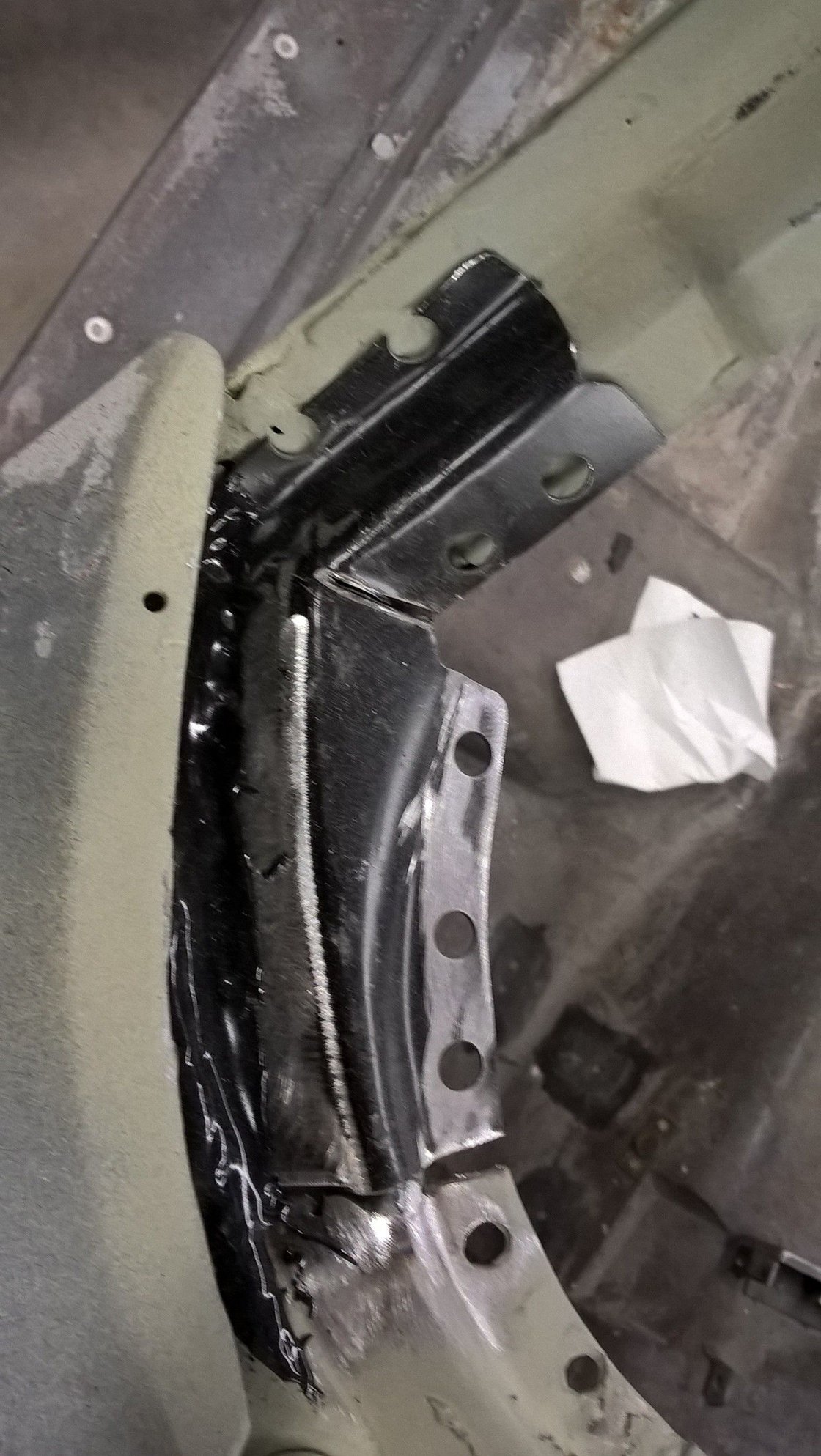

Also a good trick is to put a white piece of paper on the floor driver and passenger side and then open and close the door a couple of times. On mine, some fine rust was on the paper. Then on the body mount under the kick panel on that side was an inch deep in rust flakes. The body mount was perfect, but the flakes were coming from up the windshield frame. I recently finished a body off restoration on this car. Looking at the two and three body mounts on each side, you would have thought the cage was perfect. Wrong, needed two thirds of the windshield frame replaced, as well as a hole lower that my guy accessed from behind the dash. I would rather replace a frame than do birdcage work. I am not trying to scare you, but don’t assume that since one spot looks good, that it is all good. Below are a couple of pics of the repairs needed on my car, that the body mounts looked perfect with no rusty bolts.

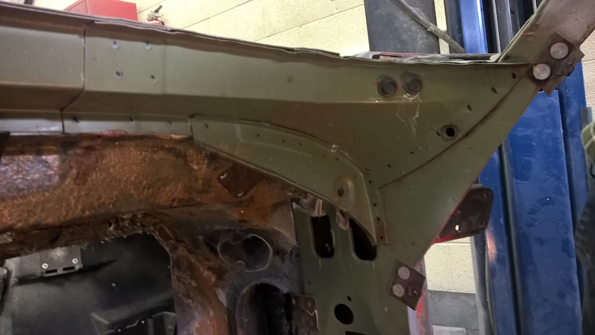

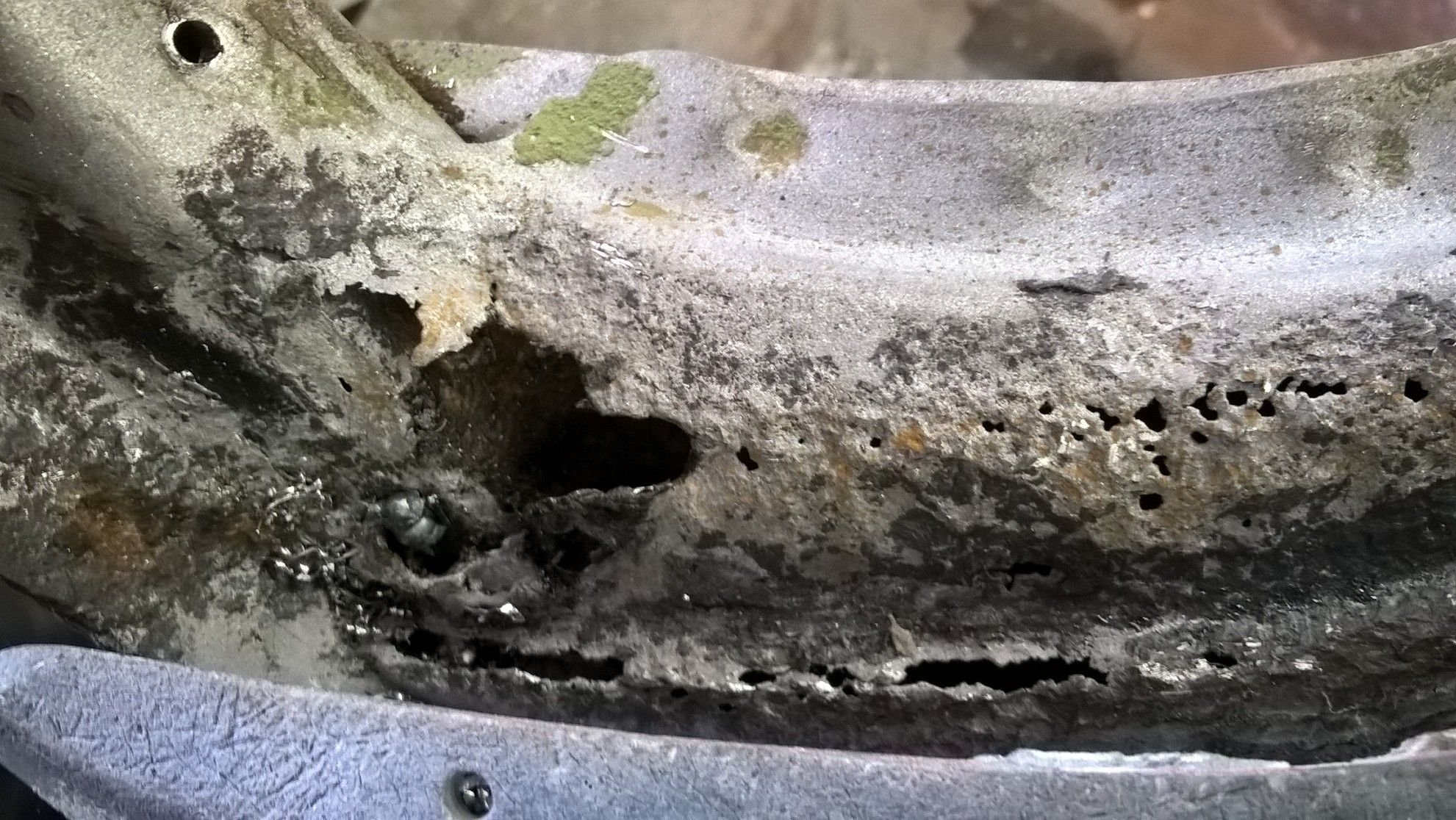

And this is what my 2 and 3 body mounts, and trailing arm pockets looked like before discovering the rust, other than all the flakes in the passenger #2 mount. So you see, you really need to be thorough because cages problems can be well hidden.
Lars
Ha! My worst nightmare!
Thanks 67:72.
But don't worry, I know what the frame is. I suspect you didn't read the footnote below that image where I did not mention the frame. Still thanks for your response.
Good to know that that panel with the hole in it is "...easy to replace..." I wonder what could've caused that.
And thanks for the tips about how to check the windshield frame for (excessive) rust. I will do that if/when I can get to the car. I'm in the NLs and the car is in France. So, it's not like I can easily pop over there to do the checks. I do plan to visit that place on my way home from a French vacation later this month...now that so many of you have reduced my fears of deal-breaking frame rust.
Thanks, again,

The Windshield Frame is prone to rust and there really isn't an easy way to see without removing all the Trim. Have a good look at the Serial Number area for rust, You can also look straight up under the dash. Most of this can be fixed with out to much effort unless its in the lower corners right where the front fenders overlap. Quite often 90 percent of it is just fine and a spot or two is rusted out. How hard is Europe on rusting out cars ? Every picture I saw looks to be an ideal Canidate.
Thanks 69ttop502!
Yeah, this rust thing has me really scared. It's like "buy a C3 Vette - find rust" and pray it doesn't require MAJOR work. I'm happy to treat surface rust, but the lengths SO MANY guys are going to in order to fix structural issues is scary.
Thanks, again.
Thanks Gale,
There's a pic' of the VIN area that looks fine, but it's only a small field of view. I wish that pic' showed the area further down. Well, I'll check that out myself when I can finally get there in a couple weeks...if the car is still there.
This part of Europe is hell on cars in the winter...if one were to take it outside. But mine will live in a dry garage the entire winter.
Hey, thanks for the encouragement!!! :-)
Thanks, again, 69ttop502,
You say they you don't mean to scare me, but rest assured, YOU DID!!!
Nevertheless, enough folks here have been positive enough that I plan to check out the car, if I can, and eventually bring it home.
I really appreciate your providing all the pix and your advice.
