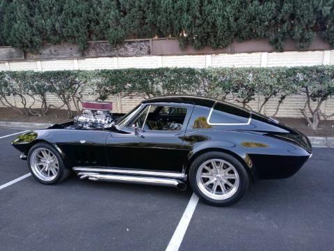

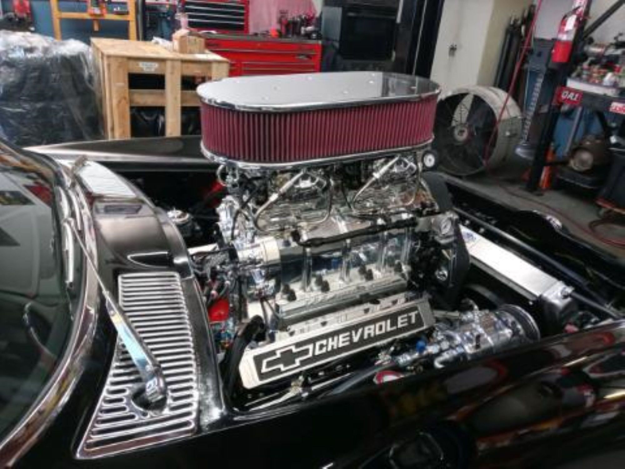

Naw, nothing like a big ole 6-71 sticking out of the hood!
blower shop 671 .
