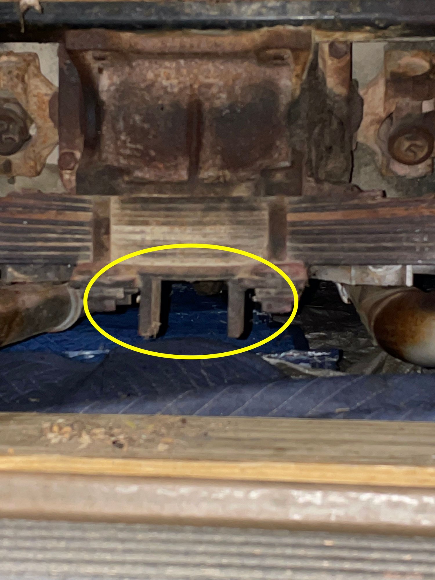

Is the part circled in yellow an add on? I have never seen this on another C3 (mine is a 1970/454/AT). Is it a bolt-on protection for the differential? Thoughts?

Home made tow or tie down hooks?

My vote would be a trailer hitch connection point

More likely to be a trailer hitch as mentioned about but at one point there was an aftermarket traction bar that mounted there as well.

It is solid metal with no holes on the sides or visible weld marks. Probably just take it off.

It's the bracket for a traction bar just like the one in the picture Mooser posted.

I will have to check to see if there are holes on the bottom of the plates. In looking at google images, it certainly looks like part of a traction bar system. It is about even with the exhaust pipes, so it does not hang too low. I will probably take it off at some point in time when I change out the rear spring.

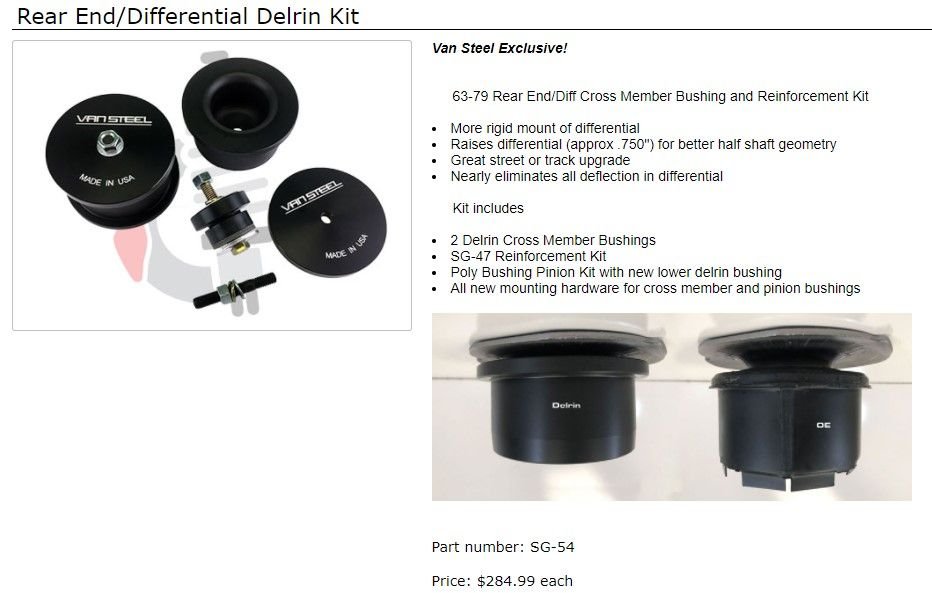

Once you get enough traction with non stock tires, axle hop becomes a real problem on C3s with a strong launch. The issue is the rubber mounting of the diff crossmember and diff nose.
That Lakewood traction bar was an easy bolt on type solution. No idea how effective it was. Van Steel's solid diff mounting kit is another solution, albeit a little more work involved. I have the later kit. That delrin kit also lowers the rear of the car, improves the half shaft u-joint angles, as well as lessen the rear toe-in with a downward sloping half-shaft. Win-win-win!
And yes to quote the OP, preventing axle hop is definately a "differential protector". Because axle hop can shatter the spiders and/or the posi case.

Cool kit, I have their alum disc and made my own solid pinion bush. Don't think they had the delrin cross member bushings when I set up my rearend.
