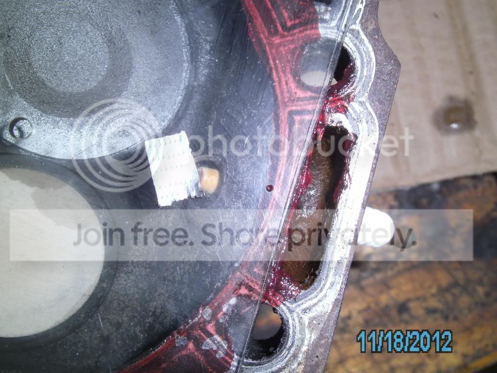

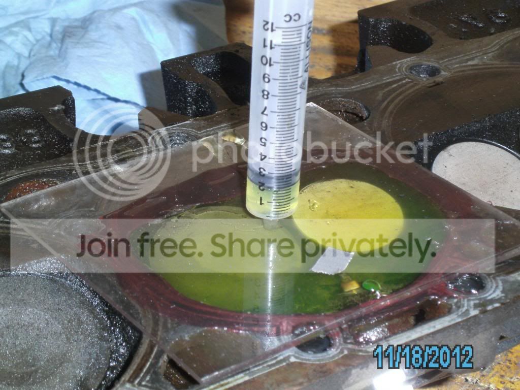

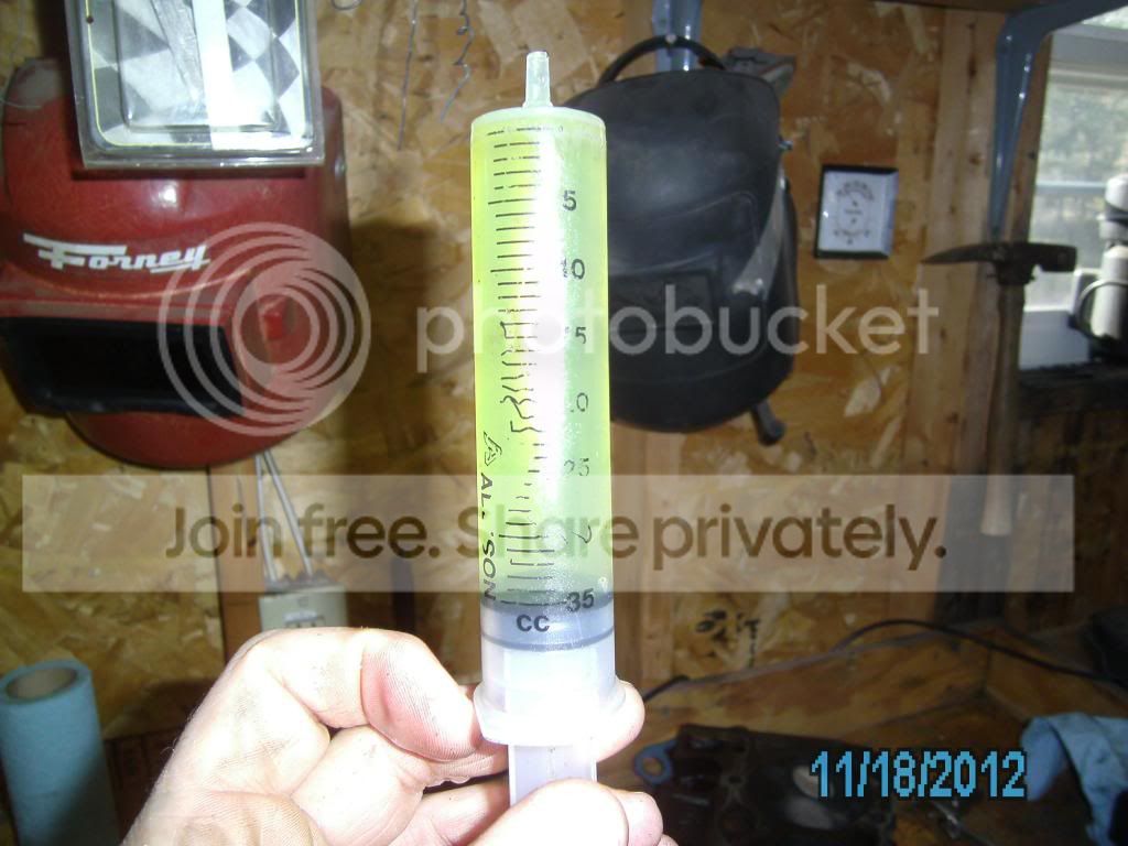

Originally Posted by Pale Roader
My 73 came with a 350 from a truck, 78 i believe... about as lame as a 350 came. So far i've read 155HP, 170HP, 175HP, and another guy told me 165HP. I've read 8.2:1, 8.3:1, and 8.5:1 rated CR. What i want to know is, what was the ACTUAL MEASURED CR ov these engines? I ask because once this thing is running, i'll be buying an aluminum top end for the engine... just a bolt on. Cheap (but checked by my engine guy) Chinese aluminum heads, single plane, matching cam, etc. I want to get an idea ov what CC to buy for 10.5:1-ish actual compression.
Mopar 440's were rated at 8.2:1 in the mid 70's, but came in at 7.6ish. Their 400's were rated at 8.2:1, and came in in the low 7's. Was Chevy the same?
This is from when I cc'd my L-48
Just got done ccing the heads. I cc'd three of the head volumes one of them twice to see if I could get repeatable results.
The results are as follows;
78.5 cc
79.5 cc
80.0 cc I did this one twice to make sure. It was 80cc's
Keep in mind these measurements were without cleaning any carbon out of the chamber.
So GM's 76 cc heads are not 76 cc heads.
In the Manual it states a CR of 8.5:1 for the L-48... that's optimistic.
Using the CR calculator at Summit racing if I negate the area of taper on the circumference of the top of the piston and use 79 cc head volume I get a CR of 7.91:1.
However if I include the area around the top of the piston which I measured this morning and computed at 3.9 cc's,79cc for the head .017 gasket then the compression for this 1977 L48 works out to be a wopping 7.67:1.
Here of some pics of how I cc'd the heads.
Pic of air hole in plexiglass. I fill until it comes out this hole.
Use this one twice. 70cc's
Use this one to fill remainder. total 80cc's
[/IM

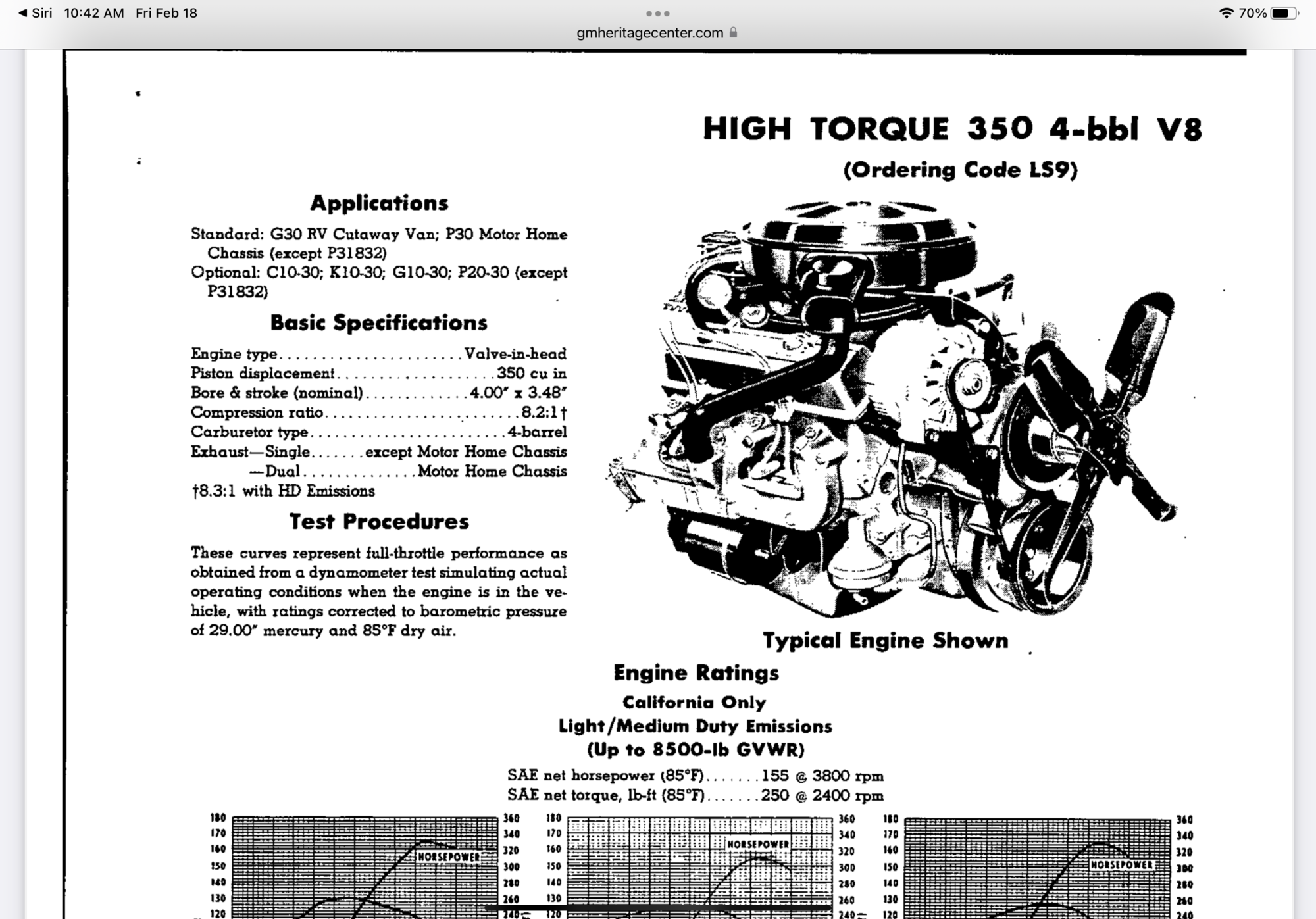

This from GM heritage center, 1978 truck 350 was RPO code LS9
