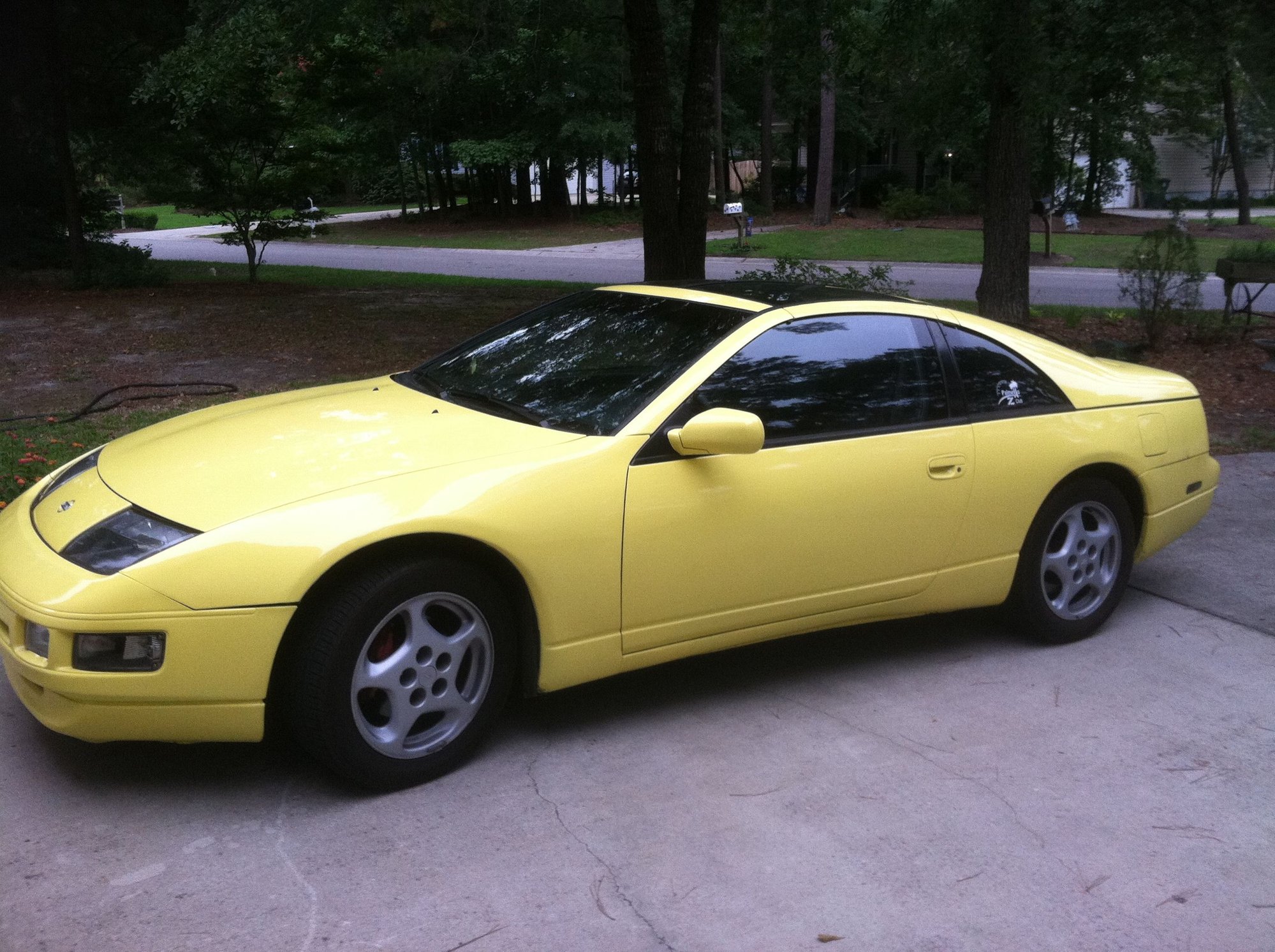

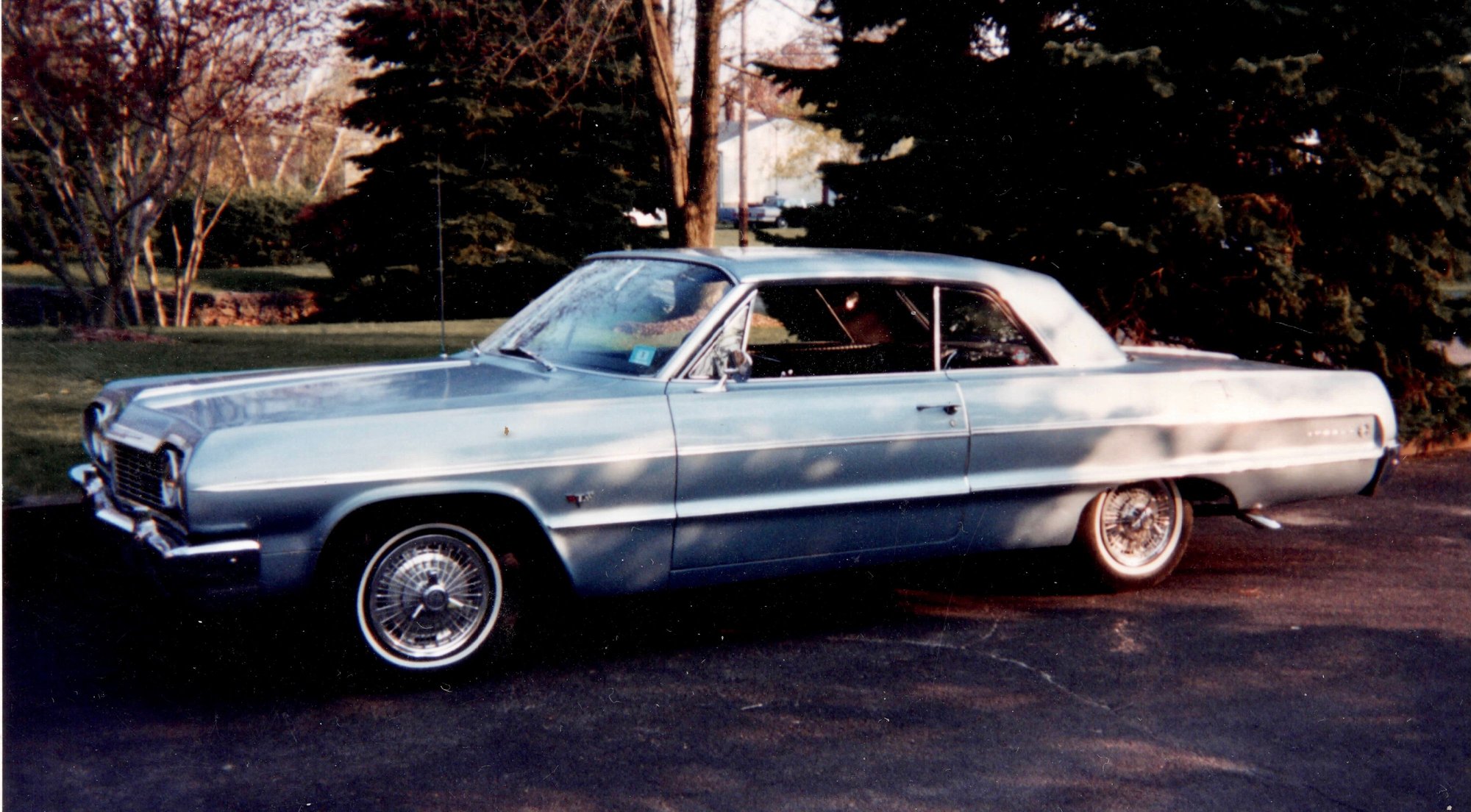

I probably will get slammed for this...but try Maaco. I have had 3 or 4 cars done by them in the past. You do the prep ( which is the hard part) and let them shoot the paint. You get to choose the quality of the paint depending on how much you want to spend. I have been very happy over the years. Yeah, I could find flaws in it. But I really felt good when, two weeks after the paint job, someone backed into my 1990 300ZX. The bright yellow one she didn't see. The last one I did was UNDER $3K. Not sure of todays prices, but unless it is a show car, it will look fine for a few years until you save up the $15K to get a perfect one. Here are two of my classics with Maaco paint

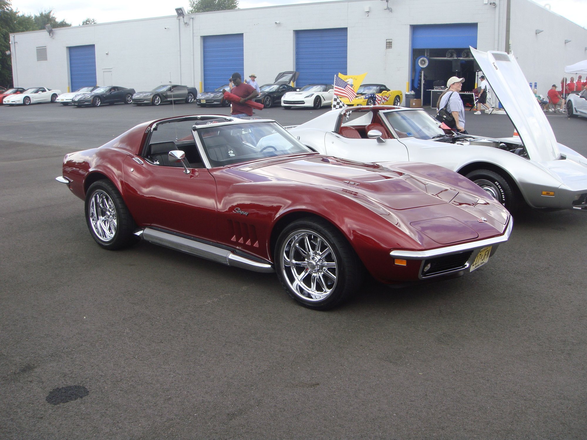

My buddy George Adam's 69 Restomod - First place at Corvettes at Carlisle before COVID - painted at Maaco, basecoat/clearcoat, polished & ceramic coated - as good as most show car paint jobs I've seen.
