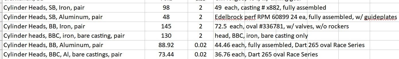

One pair of assembled aluminum BBC heads is 56# lighter than the iron versions. Not as much of a difference as the internet myth, which seems to grow over time.
These were scale weighed. The Scale accuracy is in second column. Weights vary between shipping weight, assembled weight and bare also. I have acquired a 69 Camaro weight database and am adding C3 Corvette components to it. So that we C3 owners have access to facts, not heresay. I posted it in an earlier post in this thread.
Still 72# for each iron one is pretty hefty! 45# each for AL is much more mamageable.
SBC can also save 50# with AL heads.
Who would have thought a BBC has 15# of valves and springs?
