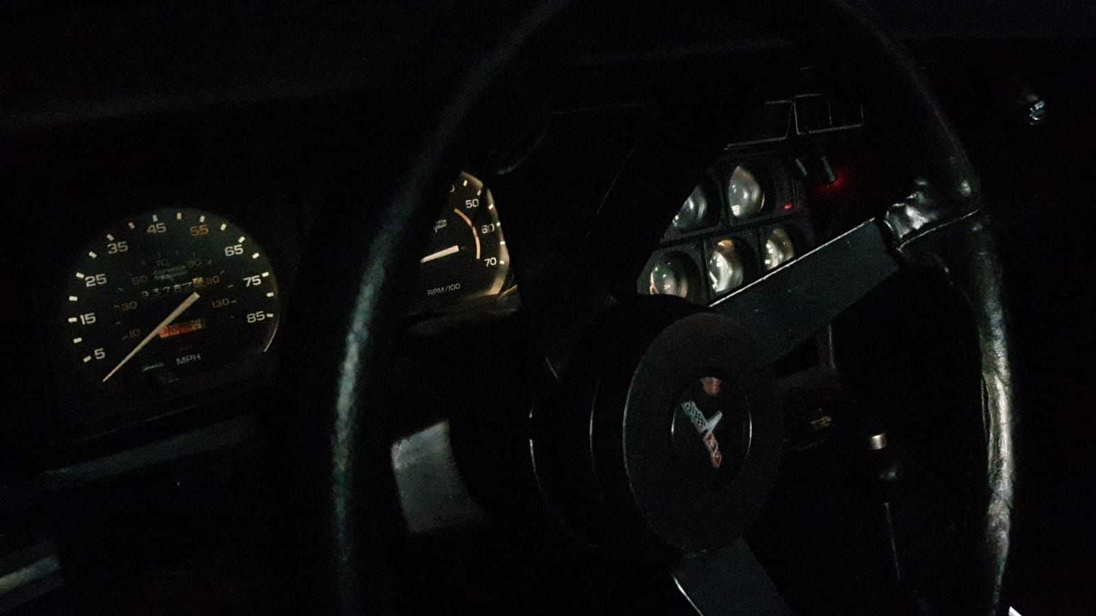

Well, guess I was lucky...
Took the taillight fuse off, and it was oxidized. So got another fuse, some WD 40, and parking lights are back to work.
Thank you for the help
