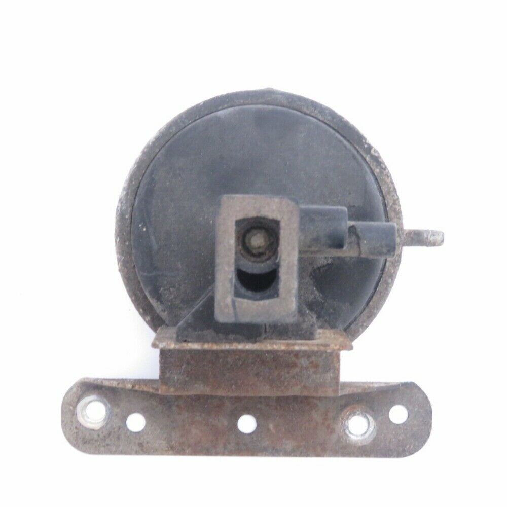

so, you have put a hose on up and down on both headlights and they move correctly? there is a long vacuum hose that goes thru rad support from intake to the t fitting before actuators. has a bug nest o other blockage in it. you need to feel vacuum on the big and little hose in front of the radiator. big hose gets plugged up a lot. the 2 vacuum actuators also have blockages in them.
ok both holes you are looking at are fresh air intakes. the smiley one provides atmospheric pressure to blow the lights up when the relay puts vacuum on the other side of the diaphragm. vacuum doesn't really do the moving. it just removes the pressure so the atmospheric pressure on the other side blows the light upwards. well, the piece of scotchbrite called an air filter over those dissolved about 20 years ag. now that hole attracts wasps. makes a nice nest. plugs up the air path and the lights open s-l-o-w-l-y and close at normal speed. stick a 3/16th drill bit up there and spin it around and it will get it out.
