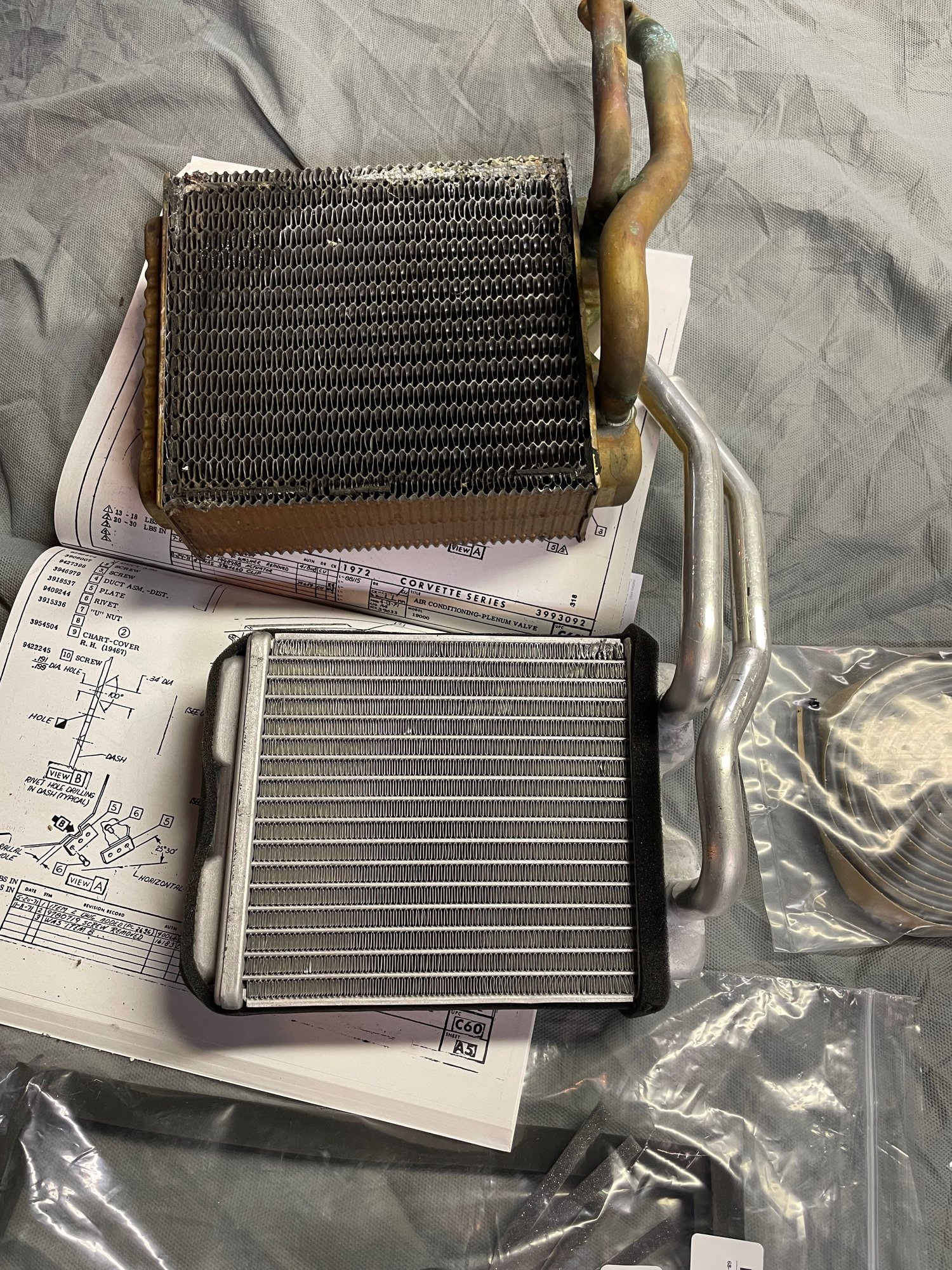

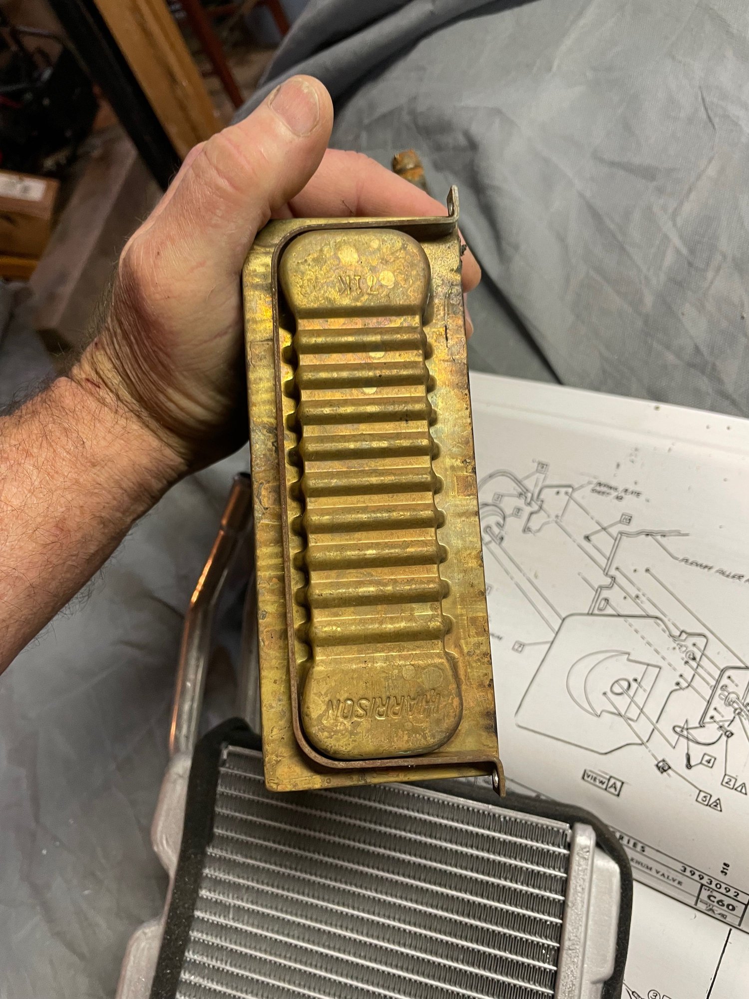

So I need to replace the heater core on my 72, all I can find are aluminum aftermarket ones called many vendors told this is all you can get now! Can I make it fit yes but would prefer to find the correct one.
Any know of options?

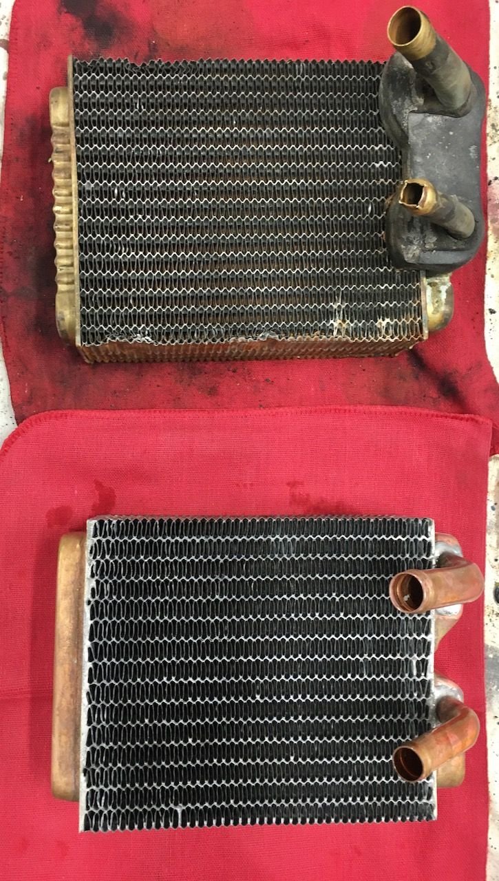

NO MATTER WHAT YOU DO...
test test test after tubes are bent where they need to go before re assembly.
Paragon helped me. no USA left. i would consider re-coring the original and test test test AFTER pipes bent.. also the price has doubled for china or mx replacements..

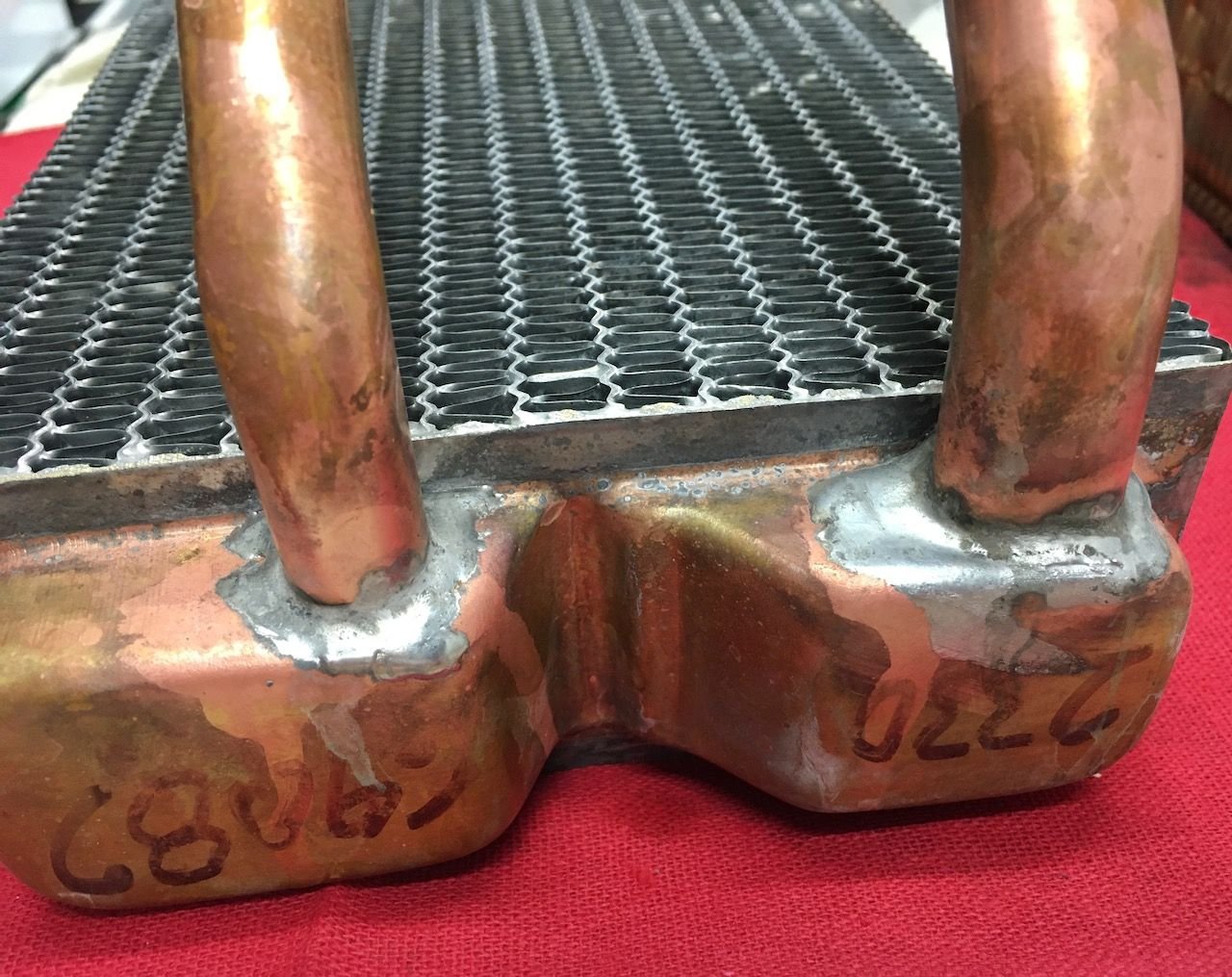

Got mine from Zip and it fit great. I had the tubes reinforced by local radiator shop (which was suggested by folks here).
