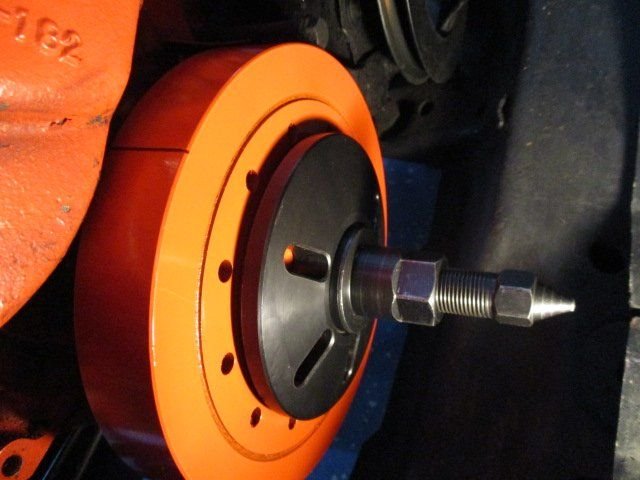

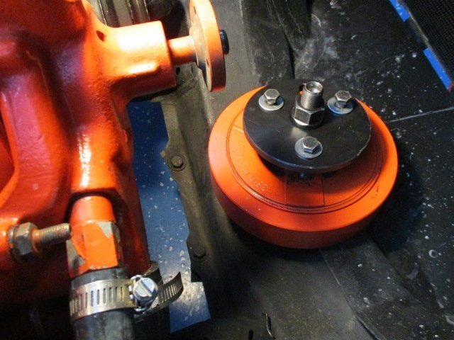

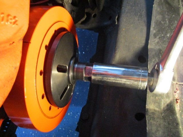

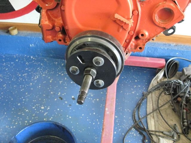

Mike -
I use this one - the ProForm 66514. It has Torrington bearings on the thrust surfaces making the installation smooth and super-easy:
https://www.summitracing.com/parts/pro-66514
Using it to remove a very tightly-pressed balancer:
Smooth and easy installation of the new one:
Same puller being used for removal and installation of the balancer with the engine in the car. Pulling it off:
Balancer removed after about 2 minutes:
Going back on with a new balancer:
Seated and installed. 2 minutes:
Lars

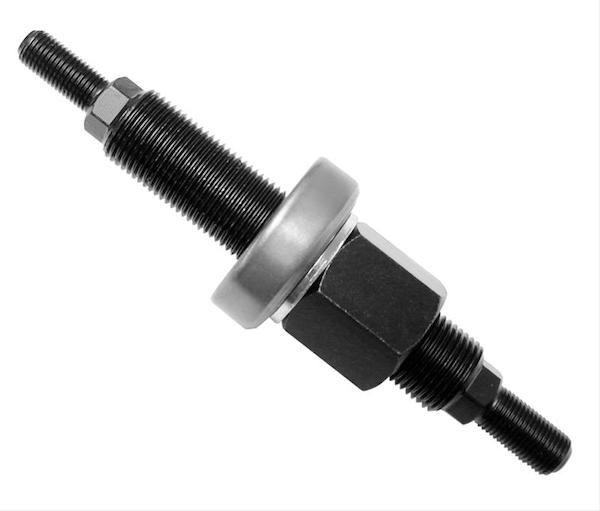

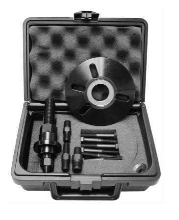

I just went through this in the last month with my 427. For pulling the balancer off, I bought the Harbor Freight puller kit (~$16); worked great with no issues. To reinstall, I bought the Proform 66515 from Summit Racing (~$38). It also worked very well. I was advised to make sure to use an installer with a bearing and this one fits the bill. I also looked at the one Lars recommended above, but felt my future uses would be pretty limited so couldn't see spending the money for that level of tool.

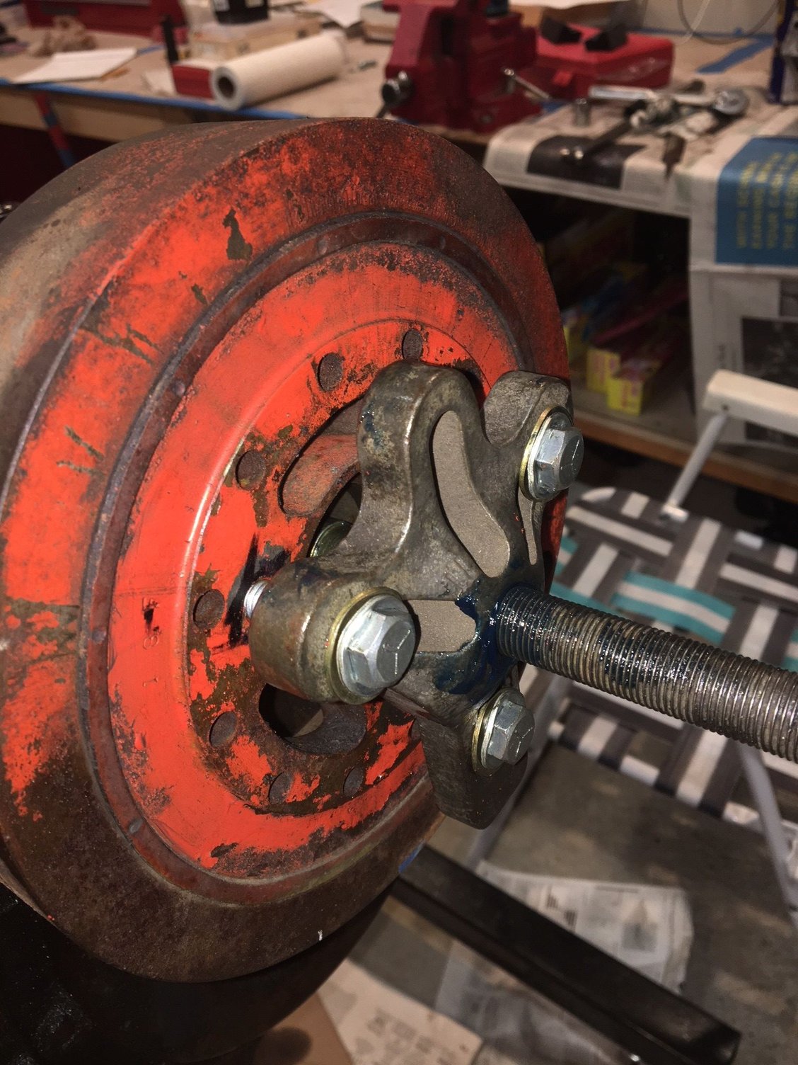

Pulling the damper off my 427 was a bear. I ruined two part store specials, they bent like wet noodles. I wound up using my buddy’s 50 year old forged puller, a lot of heat and some love taps. I’ll try to dig up some photos tomorrow.

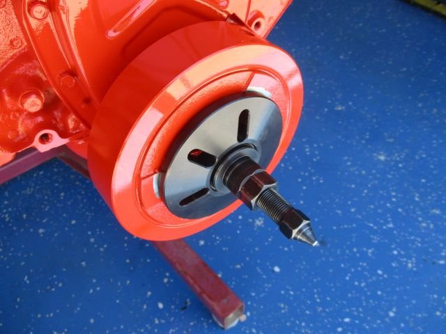

Old Mar 9, 2022 | 09:31 AM
Chris Hewitt's Avatar
Chris Hewitt
Joined: Apr 2010
Posts: 271
Likes: 158
Here's a photo of my set up. As you can see I also greased the threads so I wasn't fighting thread friction.

I'm interested in that puller. I need some caffeine at the moment, so please pardon some possibly stupid questions. Is there a threaded snout on it that threads into the crank to keep everything aligned while the pulling force is happening? And which direction is your wratchet turning when you're pulling the damper off (is that LH threads on the front rod/shaft)?
