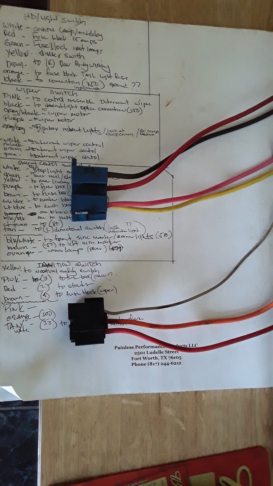

Hello,
I am rewiring my 82 with a painless kit.
Need help in identifying where these ignition switch wires go. I tried to use the wiring diagram but got confused.
Thanks

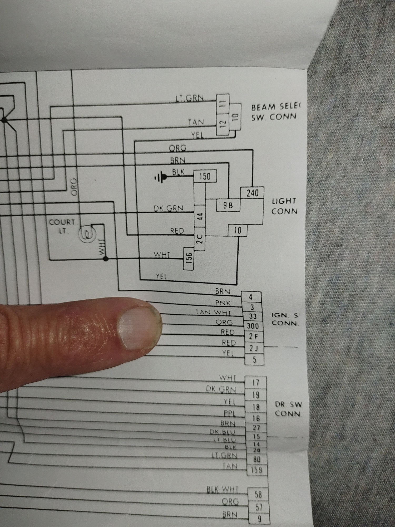

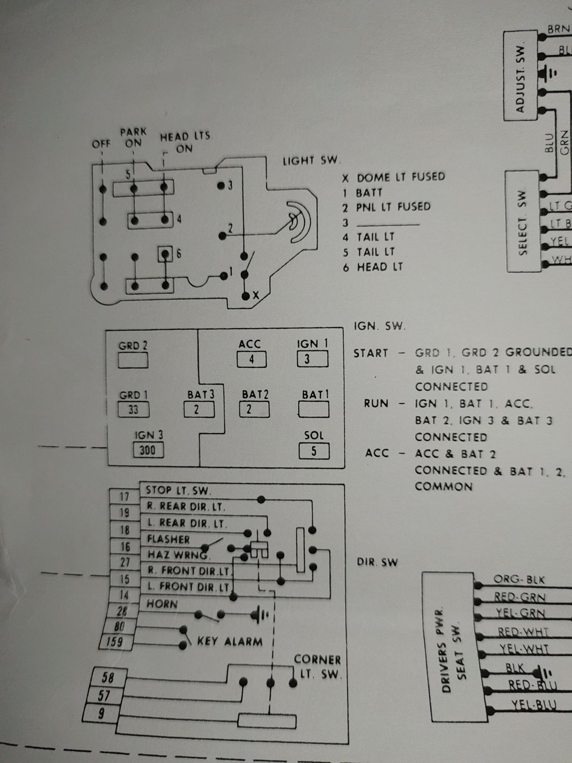

Hopefully these will help.
