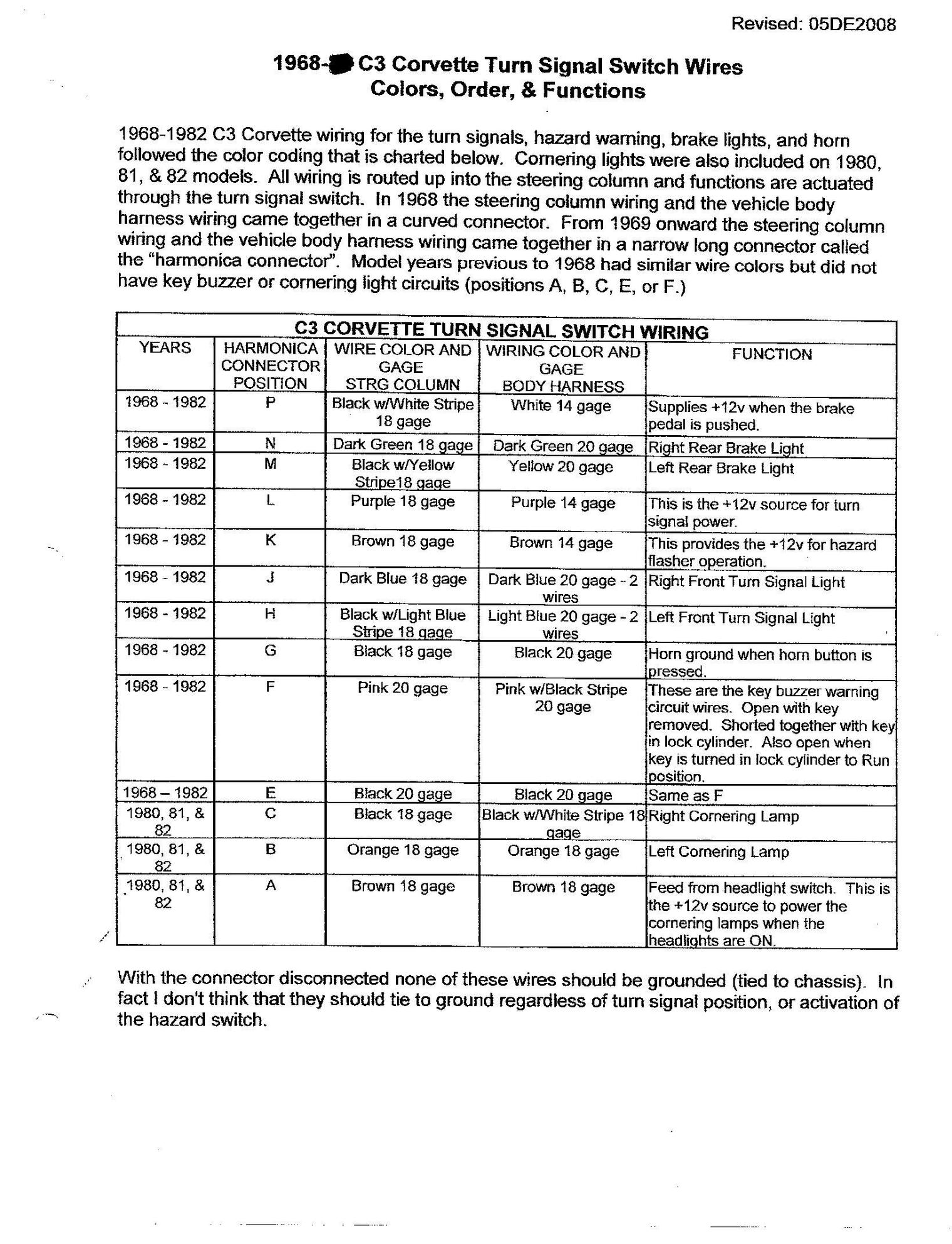

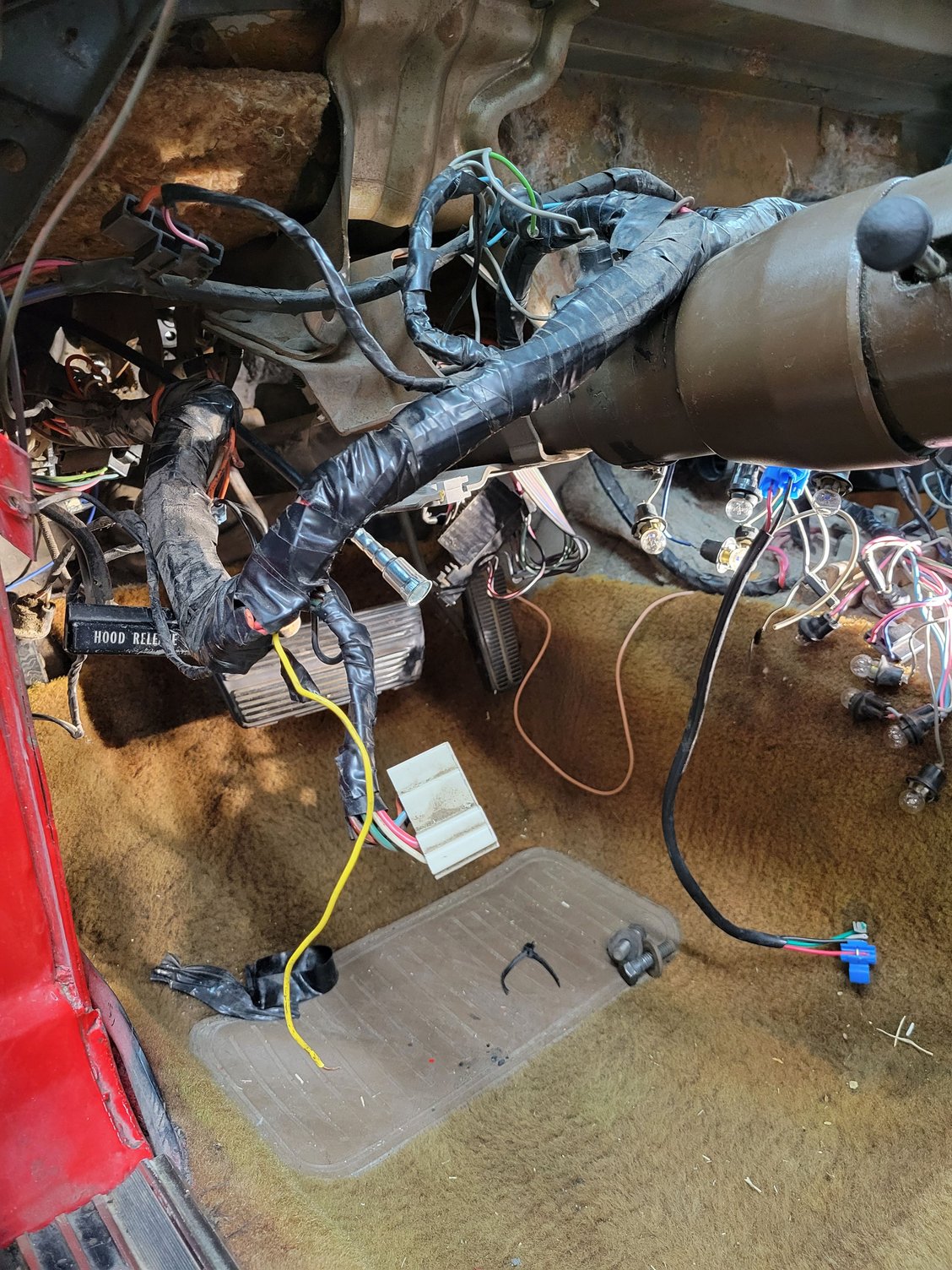

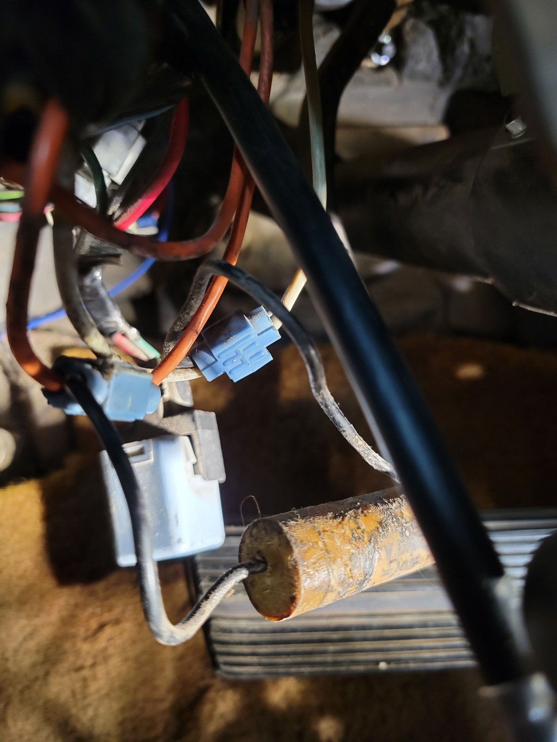

Two current mysteries are: the yellow wire in the harness by the headlight switch that is attached to nothing, and the cylindrical object spliced into my brake light switch wiring. The yellow wire is at terminal M in the turn signal harmonica plug and I don't know where it is supposed to go. I have no missing wires in the headlight switch. I think I should remove the "resistor" looking thing from the brake light switch wiring.
Old Mar 10, 2022 | 03:07 PM
stevedinino's Avatar
stevedinino
Joined: Jan 2017
Posts: 271
Likes: 120
From: Rock Hill South Carolina
The yellow wire from the harmonica connector should go to your left rear tail light. I’m guessing you don’t have a working left rear turn signal.
According to the AIM for ‘76, that’s a radio noise suppression capacitor. They put one in the brake circuit and another in the turn signal circuit.

The left rear signal works as is, although it blinks slow twice then fast the rest of the time, like when a bulb is out. Both front and rear signals work L&R. Brake lights work. More info on the LED dash lights please! I have a few dash light sockets that need replaced or are missing. Have the replacement sockets, but changing to LED would be cool.
