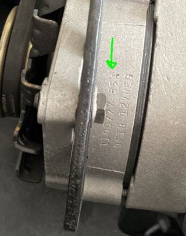

I may be off base here but... What I see is an extra nut and stud at the water pump end that does not belong. Here is a pic from my 72 and the page from the assembly Manuel, I also have a 73 parts car that the mounting is the same.
Just bolt/lock washer/brace/washer/pump at least remove the extra nut.

Yes, that brace is at quite an angle.
This is the nut (green arrow) FASTAZU is talking about that does not belong there. Remove it for better brace alignment.

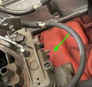

Is that an open vacuum port on the front of the carburetor ?
Yep. And a 55 amp alternator in an A/C equipped car
Thanks, both of you, I’ll fix that tonight! 👍👍

No, you're right. You can clearly see the bracket is torqued and shout not be.

1. I’ll fix the alt bracket, with the nuts pushing the bracket out from the water pump.

Originally Posted by Eric-
4. Is it imperative to get a 61amp alt or as long as I’m getting away with 55amp can I leave it?
Thanks Everyone!!! 👍✌️👊
No it is not imperative. Your headlights/tail lights/brake lights will dim when you turn the A/C on and set the blower speed to HI. Should you need to replace the alternator in the future, replace it with a 61 amp. A 55 amp alternator has 90%capacity of what the system was designed for.
You should consider plugging that vacuum port on the carb.
Looks like it provided vacuum for the TCS system below:
Let us know how everthing works out, Eric-
