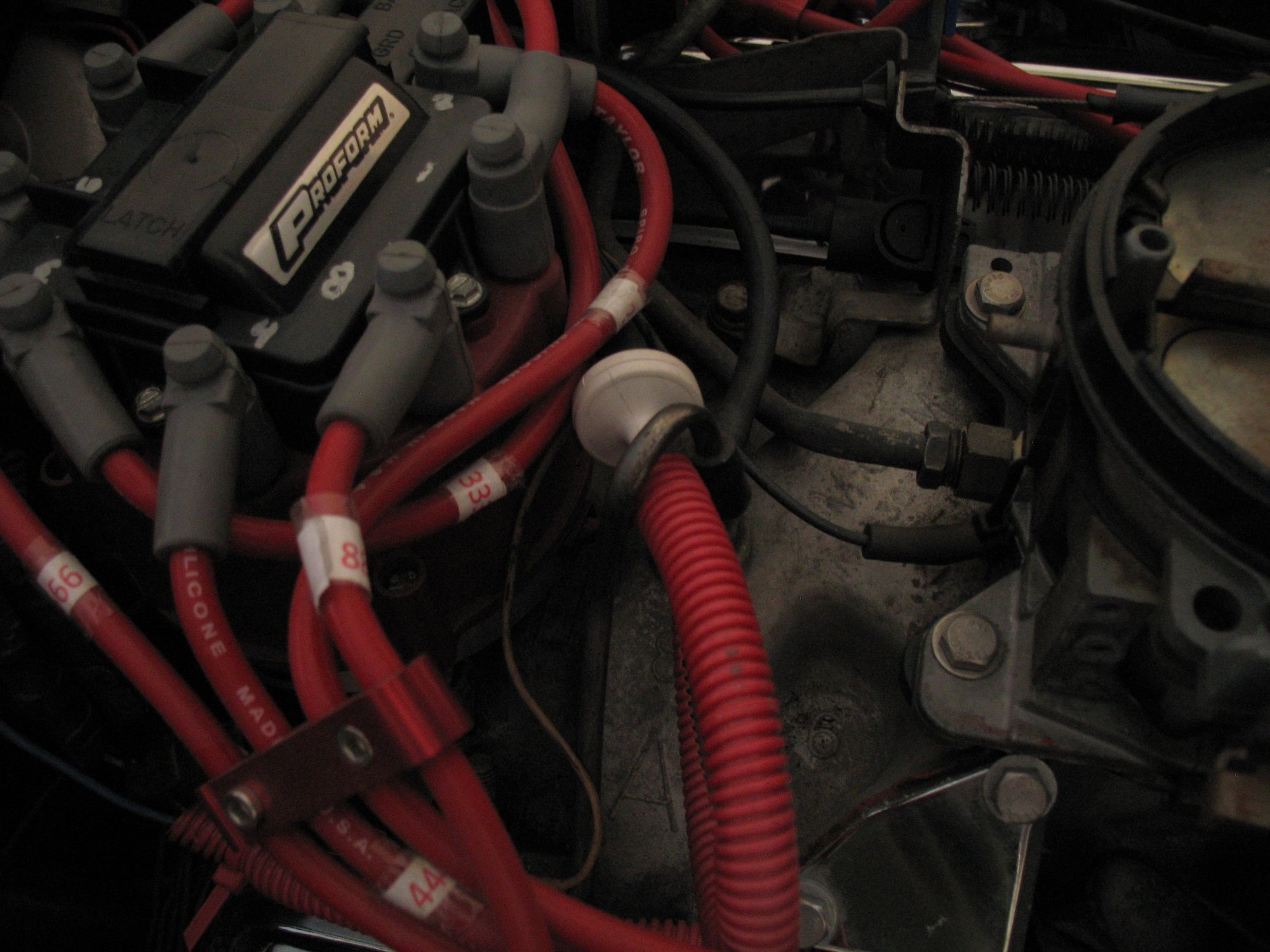

on my 1981 vette had carb rebuilt by lars. question on the rear of the carb. towards the fire wall the orffis tube coming out of the back where do i hook this up to i just have it open now

here is a photo it is the line above the brake booster line
here is a photo it is the fitting above the the brake booster

That is normally the Fresh Air inlet for a Hot Air Choke system.
A larger photo would most likely show you have a electric choke...

and it looks like there is no vacuum advance on that distributor. i am fairly sure lars does not do 81 e4me carbs. got pic of the whole carb and top of engine?

That's the fitting for the fresh air inlet for your 1978 carb's hot air choke. Your carb has been converted to electric, so there is no purpose for that fitting. You can cap it off or just leave it - makes no difference either way. It's just a fresh air supply source, and it's static.
I built that carb for you 3 years ago. I hope you're not just now getting around to installing it - that's not going to work out well...
And next time, just send me an e-mail and ask the question.
Lars
