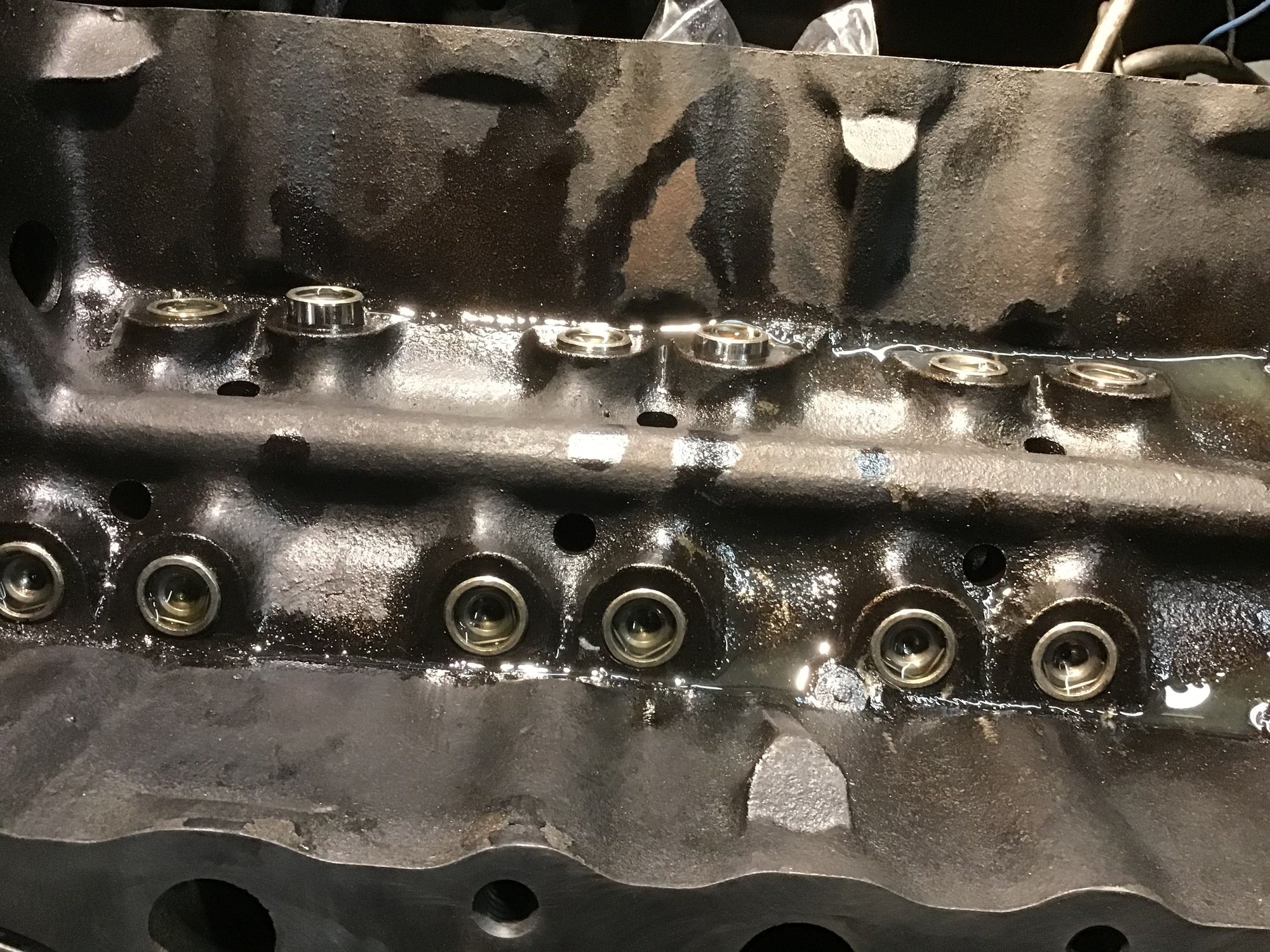

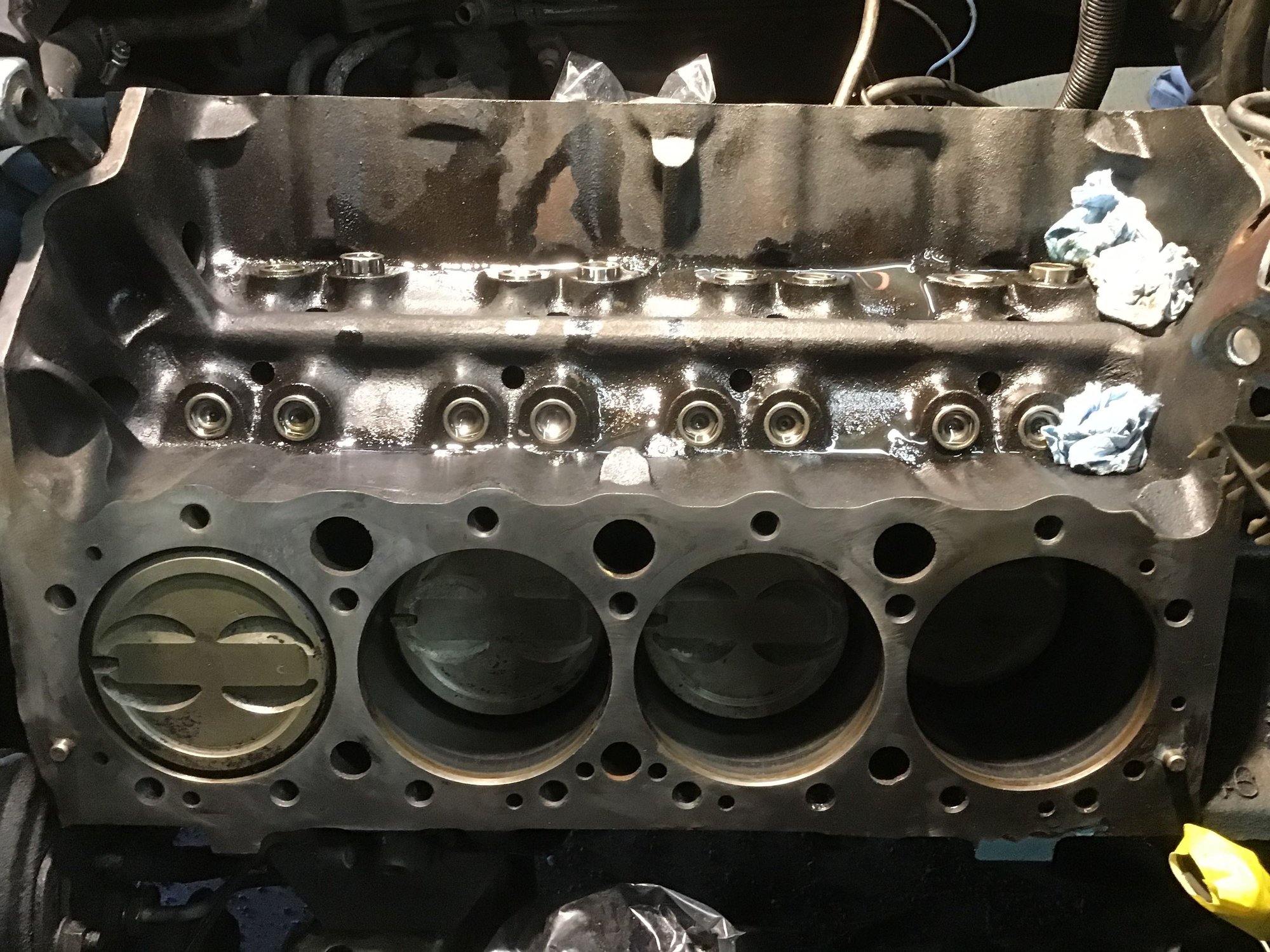

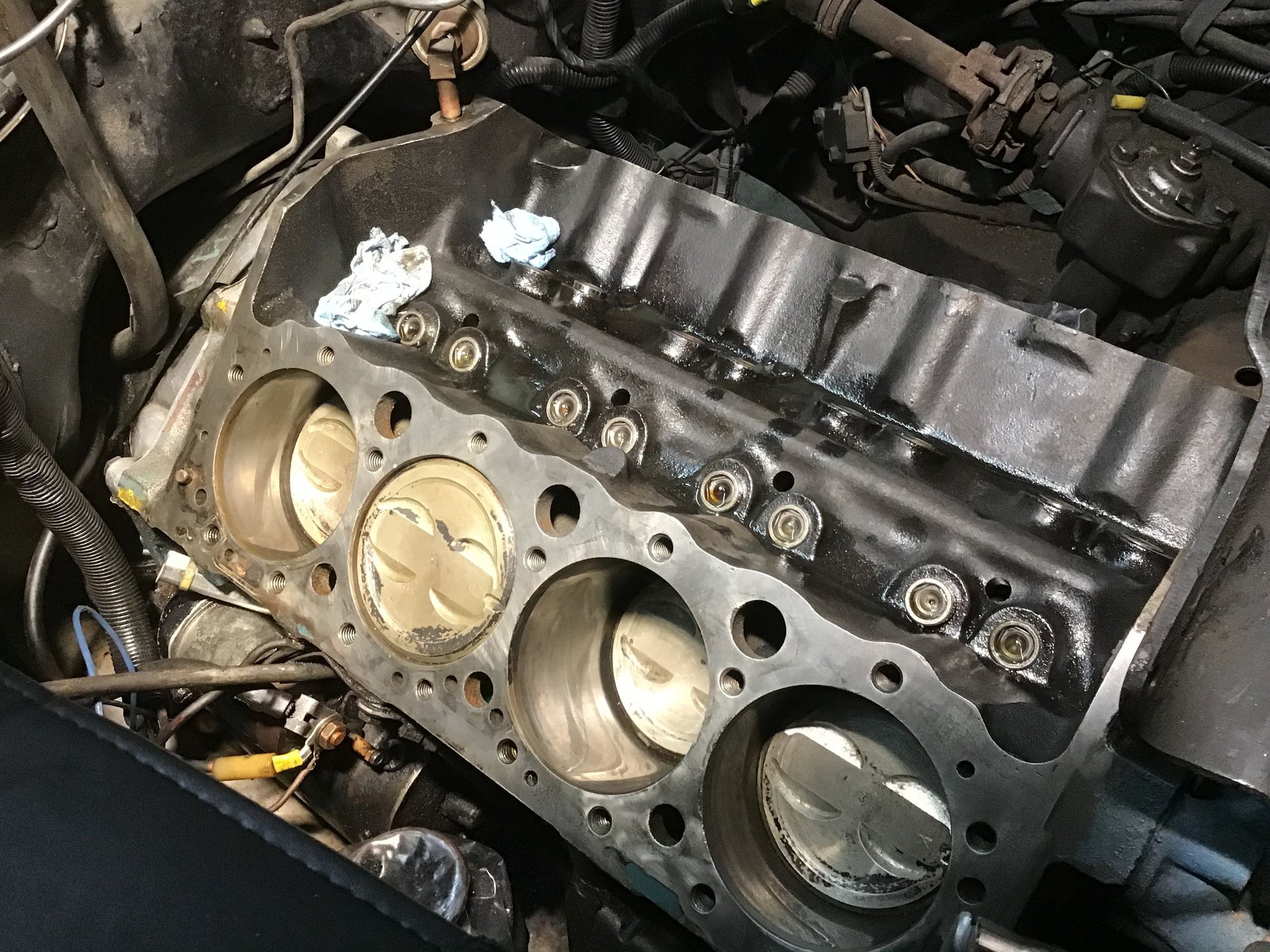

Old Apr 1, 2022 | 04:08 PM
  #46
Golferdad's Avatar
Golferdad
Joined: Feb 2022
Posts: 986
Likes: 183
From: South Carolina
Default Ready for heads
Ready to put in place and tightening up.
I’m assuming Im tdc I am dead on my timing mark on 0.
