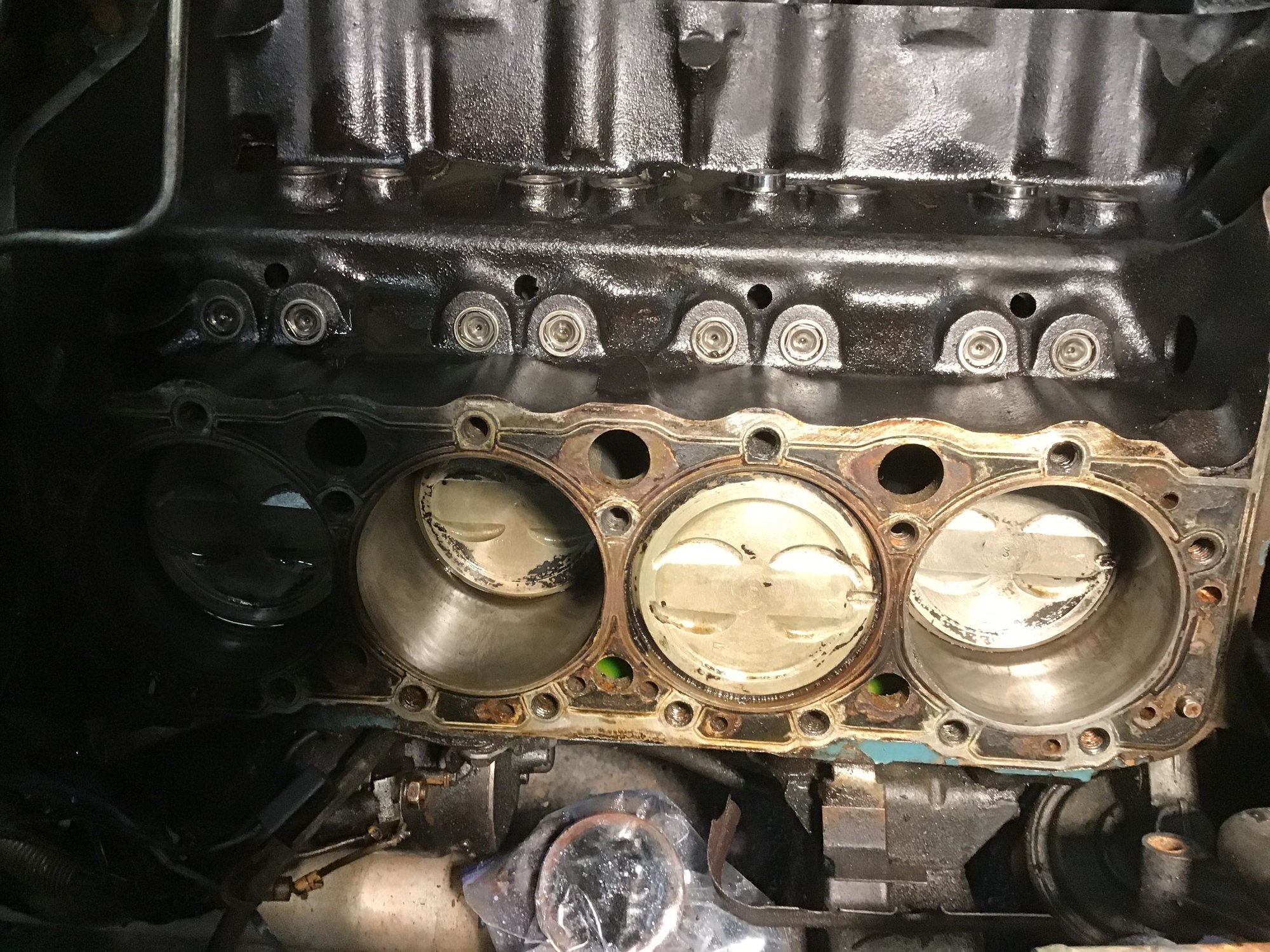

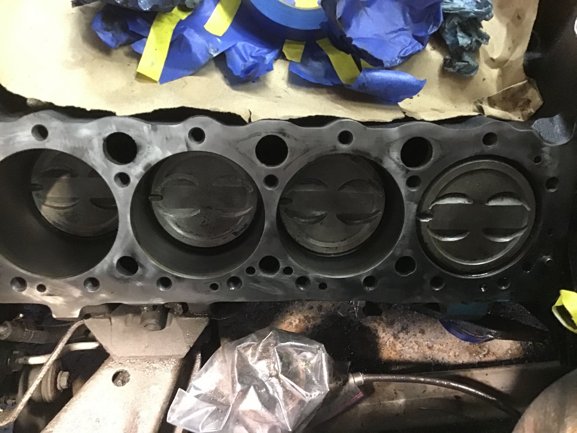

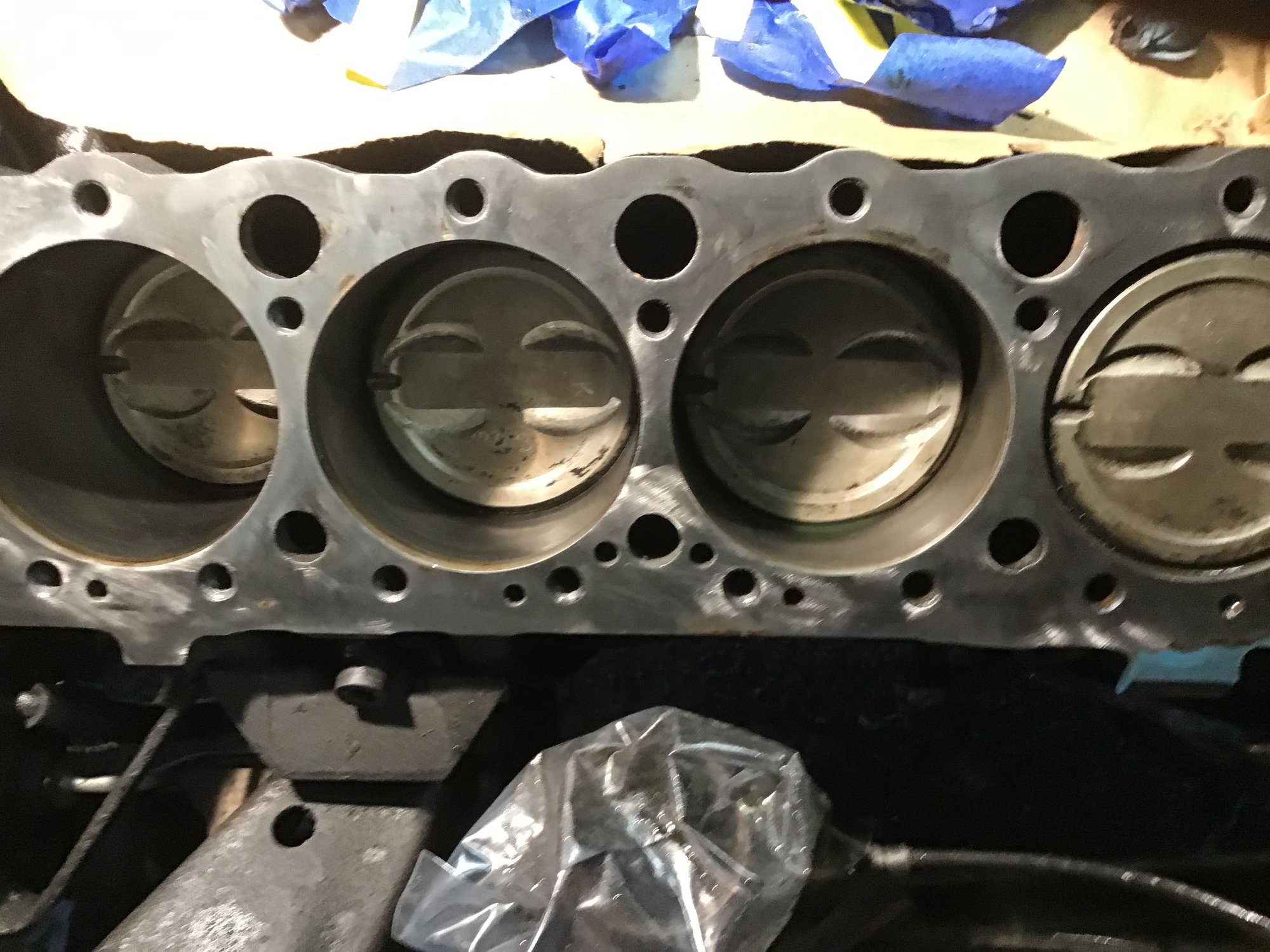

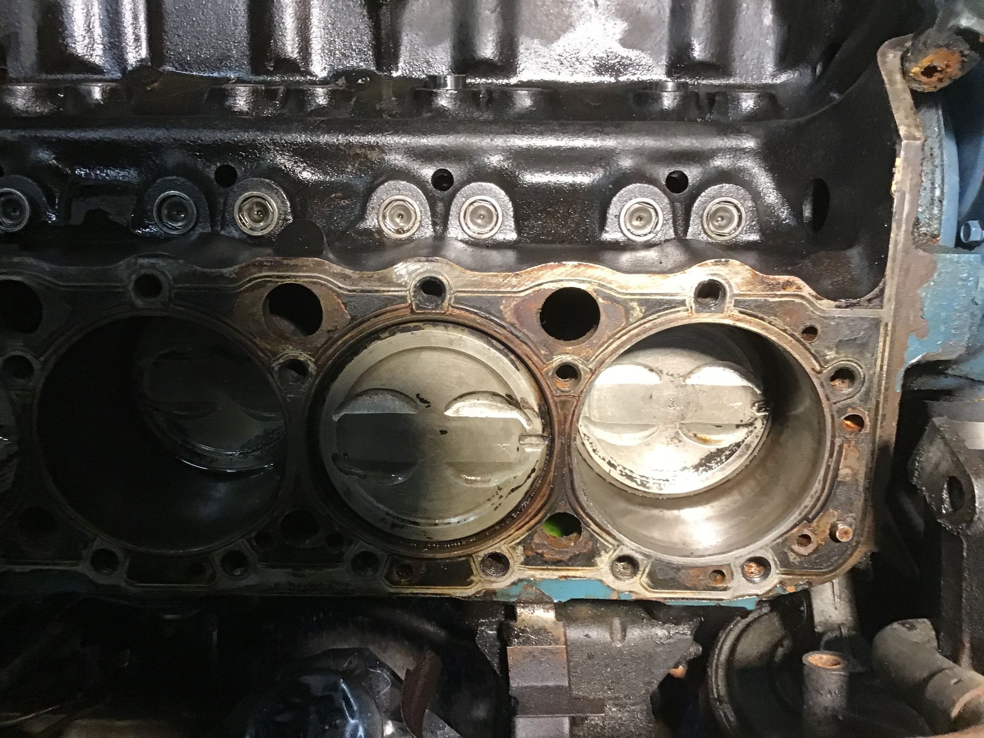

First zip by,took about 5 minutes
Much better
Before I sanded them
Before picture
Good and smooth

take a pair of vise grips. grab sideways on those 4 dowel pins lower corner by 1-2-7-8. pull em out. new at chebby dealers a buck or 2 each. or reinstall those. deck will clean up better. get it a little better. composite gaskets. you can find an .029 pretty cheap. https://www.summitracing.com/parts/n...waAoInEALw_wcB no steel shims. next question: what heads and why? since thread title is heads...

To play devils advocate here, You need washers for the head bolts, thats it. Many people use the same head gaskets as they would for iron heads but if they are metal other than copper they can mark up the head surface of the aluminum heads over time. You can use a gasket spray such as copper kote or a rubber coated steel shim gasket to help prevent this and the prices are comparable to what you have to buy for any head your going to bolt on at this point. You may also need different pushrods with any different performance head including iron heads as I have with my old iron eagle heads.
That said edelbrock heads are nothing special for the cost.. And I thought you were no longer considering the avs2 carb as well?
Pictures can be deceiving but it doesnt look like you block sanded the top of that block.
