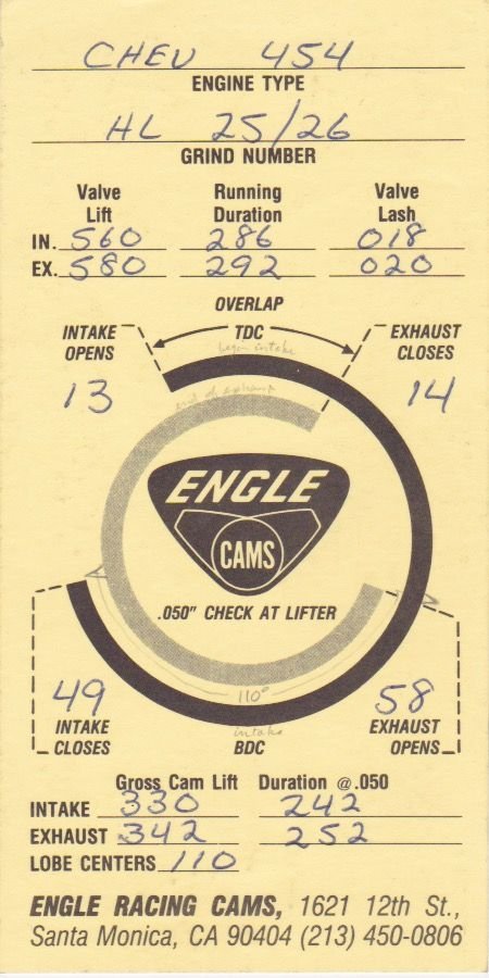

Vacuum pods on the secondaries. The engine has an Engle, 560/580 camshaft that produces 13 in. hg. at idle. (see cam card attached below). It's a .030 over stock, "512" block with "990", 118cc open chamber heads.

nice cam. Im going a bit smaller. I need to stay around 500hp/500ftlbs so my tranny will survive. If I blow this up I will go with a richmond 5Speed and then all bets are off Hp wise. but probably would stay under 600hp. My pistons have a -38cc dome and would be about 10.75:1 compression with a 119cc chamber
