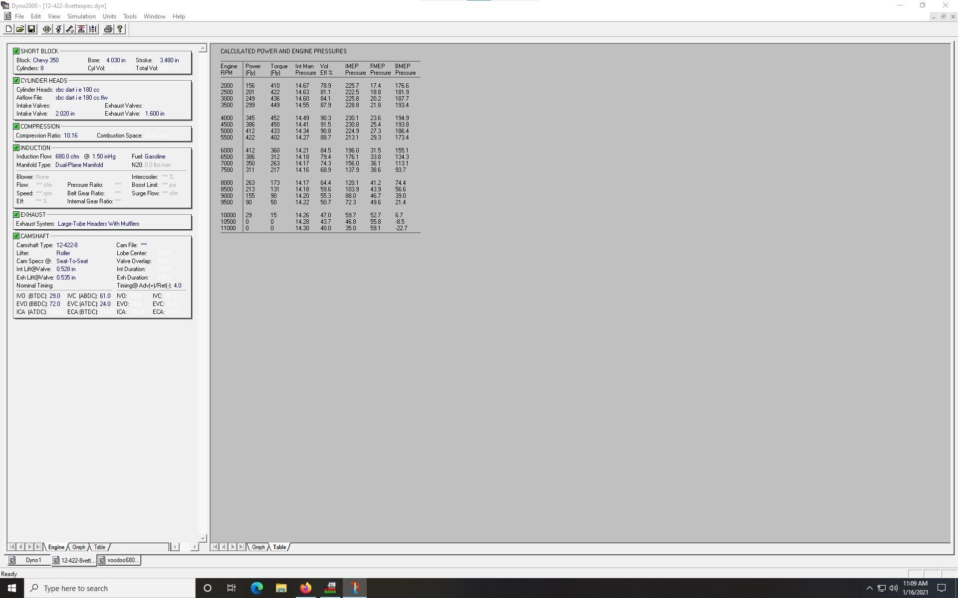

I have the Xe270HR myself and jumped from the flat tappet voodoo 262/268 cam. I also felt it was a worthwhile upgrade and it made quite a difference in how the engine runs. In my case I also have 64cc heads but they are iron and that along with the flat top 4.030 pistons and .015 shim gaskets gave me a higher 10.16:1 static compression which the 270hr cam helped bleed off a bit so my DCR was in the sweet spot for pump gas. I run 91 octane with no pinging.
This software is optimistic I know but I used it to compare the different option with my combo and it gave me the best numbers vs everything else I looked at that would still work with my 3.08 gears and 2000rpm stall... both of which will be changed soon anyway.
