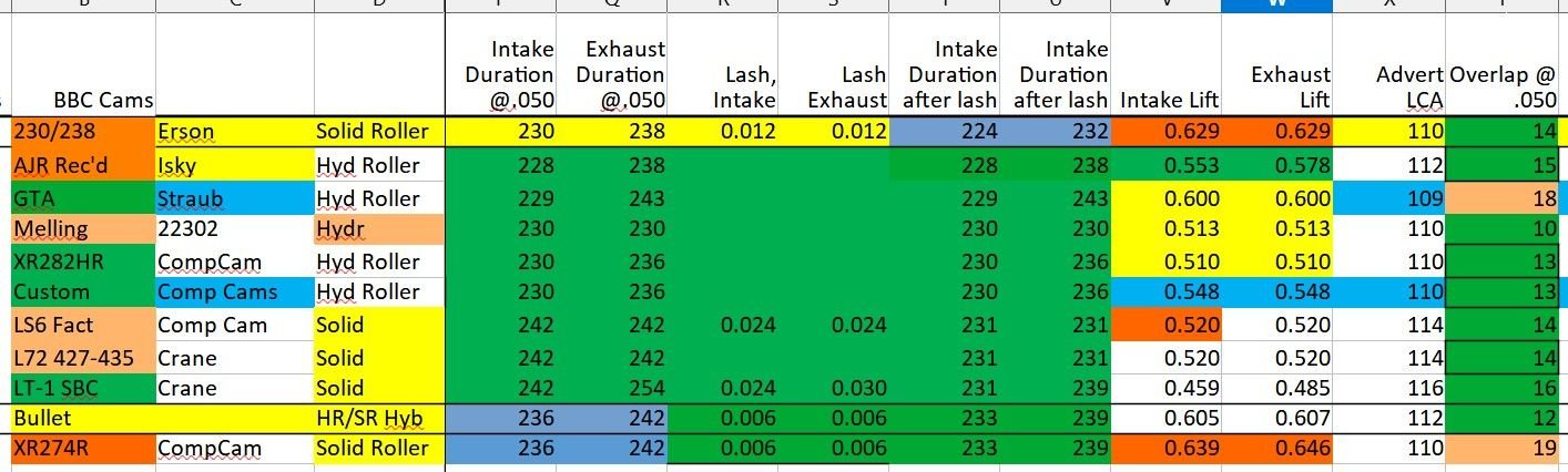

I have done a lot of research into L71/L72/L78/LS6 "similar" cams, in all formats: OEM, Solid, hydraulic, hydraulic roller, and solid roller.
Free info for asking.
Both Crane and Comp Cam give almost identical specs for the OEM L71/L72 cam.
But honestly, in this day and age, I would strongly suggest against a solid due to frequent lifter failure issues.
Here are ten or twelve that should all run & feel about the same as the OEM cam, but some will make more power, some less.
My 454 Dyno'd at 485HP with the Erson SR cam. And 550 TQ. And yet I am going to re-cam it with the Bullet above before it ever goes into the car.
