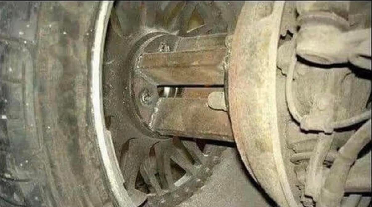

I found someone who shares your aesthetic, and frugality. This is for 4-lug car, but I'm sure you can make a jig to rig something up for a 5-lug car.
You laugh... but i know a guy who bought a 'totally stanced-out' car... only to find STACKED 2" hub-adaptors, on each wheel. Yup... one 2" adaptor bolted to another.
Hey, who says putting modern car wheels on old cars has to be expensive? Hahahahahahagrooaaaannn...
Geez... almost as bad as a car i saw for sale in the 90's... had FOUR ov those cheap CAST-aluminum 1/4" spacers between EACH wheel and the drum. Yup... 1 full inch ov **** Chinese aluminum. I wouldn't drive down the street on ONE ov those things...
The **** thats driving around out there man... Be afraid...
