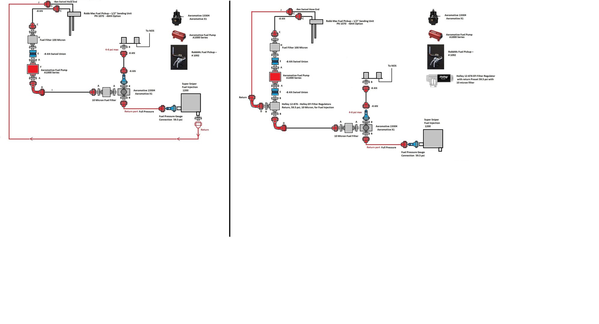

I finally got it. Could you offer some advice on my fuel system? I don't know exactly what is required for the NOS. I really need to know if I can use what I already have with the NOS. I have a couple of drawings of my plumbing plans and have all the equipment except the regulator for the NOS itself. I'm going to use a Holley Super Sniper with a Holley regulator preset at 59 psi with a return back to the tank (i think) Here are a couple of drawings that show my ideas. Any ideas or input you or anyone else on the forum could add would be so very helpful.

The Holley Stealth Sniper is able to do a wet or dry Nitrous system using the Sniper EFI software. I have a Stealth Sniper and it is clearly able to handle the Nitrous for you without a lot of extra equipment. The Super Sniper allows to control the Nitrous injection from the hand held touch screen which the Regular Snipers cannot do. My Stealth Sniper only allows adjustments using the laptop software but that is not a problem as I keep a Laptop connected in the Car while driving it around.
You might want to look at the EFISYSTEMPRO.com as they have a lot of answers regarding the various things like Nitrous. If you have not purchased the Super Sniper then you definitely want to talk with them as they offer 2 years of the best tech support out there for the Holley EFI systems. If nothing else they will guide you to get the right parts as from what I have heard it is fairly easy to add Nitrous. They sell the extra relay to control the Nitrous for less than $80 at their website.
