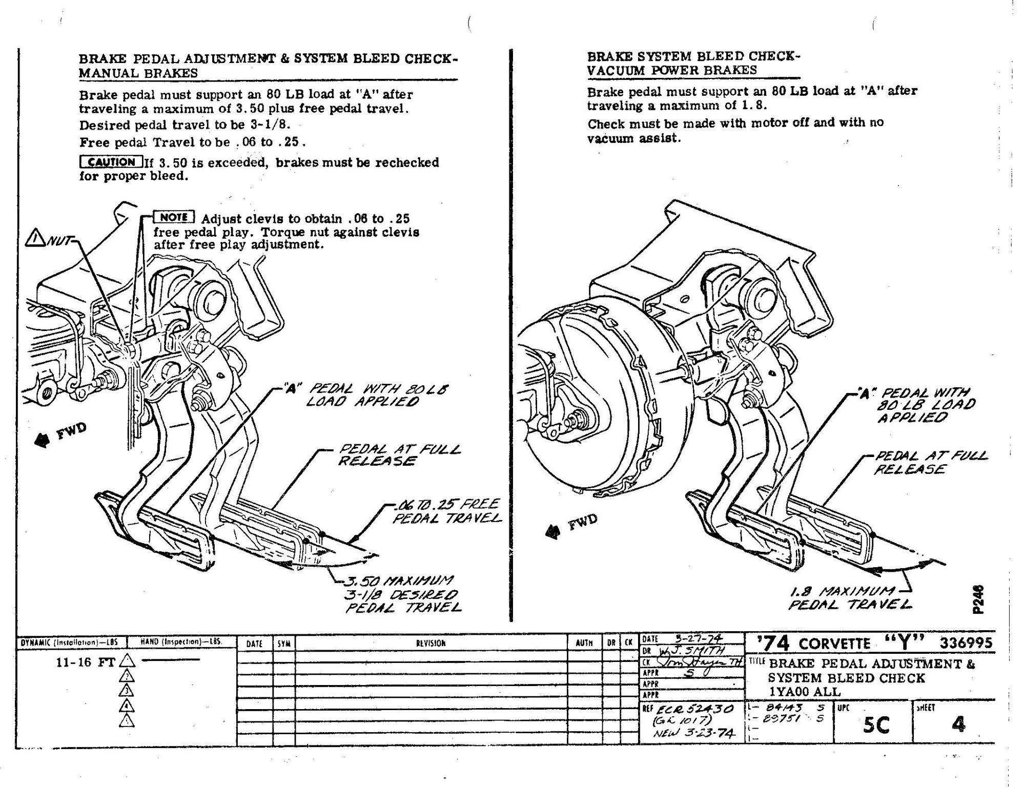

Corvettes have an enormously long amount of brake pedal travel.
3.8" is almost 4 inches and very close to the floor but if the wheels lock up on a panic stop you just have to get used to it.
You did it all, maybe it's as good as they get.

Interesting. Thanks for posting. As I read this, since I have power brakes, the check is done without boost and from what I can tell my behavior is pretty much spot on. Maybe 1.5-2" of travel and the pedal is very firm so from what I gather, it should be working properly. However, one the engine's running, it loses the firm pedal and the travel is much further. I don't get it...

A properly working booster when purged of vacuum will give a rock hard pedal'
once the engine is started the booster's vacuum starts to increase and the pedal will drop a little.
That's how it works, You can always use your Vette and re-bleed down the road and see if and air comes out.
