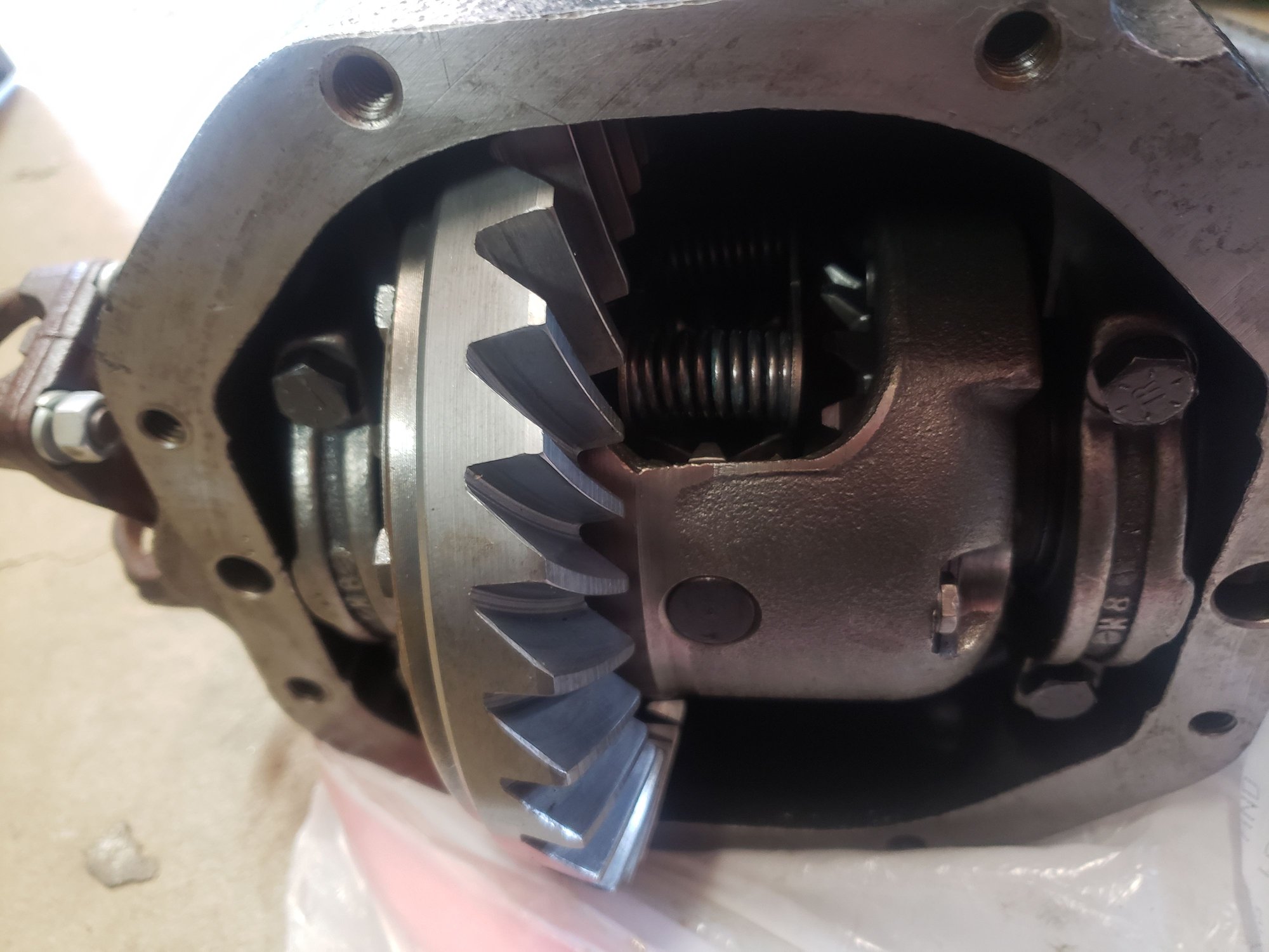

Here is a good example, one I opened last week. 1967 original diff, no issues with it in the car. Sent for upgrading. However, it was indeed a time bomb as the posi is cracked. The diff otherwise would have operated fine up till a few clicking sounds and then complete failure.

Here is a test for you gear heads out there, do you see anything in the picture above - other than the crack in the posi, that is not right?

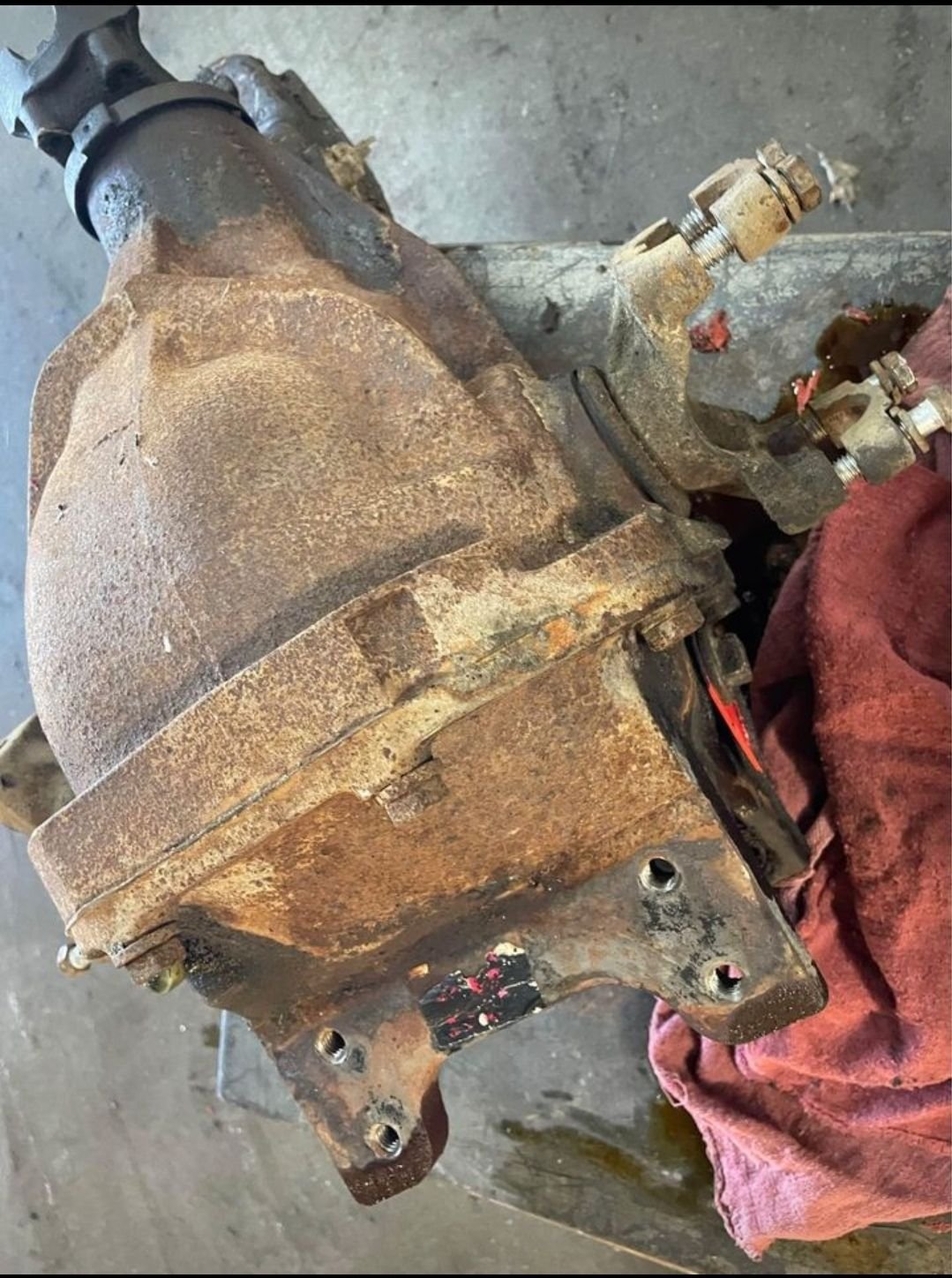

Thanks again gentlemen. You've given me a lot to think about. At a minimum I'll try and get some pictures of the internals and casting #'s. These are the only pictures on the listing:

I'm also dying to know what the other problem is that GTR1999 hinted at on the example he provided.

Right bearing cap installed backwards...
Kevin
Bingo, sharp eye Kevin. I posed that same question on FB a few days ago and no one responded.

For the rest of us, how to tell?

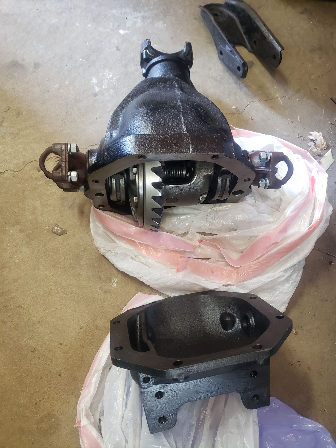

For reference, I found my 3.55 rear end last summer rebuilt and open for inspection, on facebook for $500 it came with new bolts and gasket for the heavy duty rear cover it came with. I consider myself lucky to find it but deals like this pop up every now and again. the seller had it saved for a project he decided against finishing.

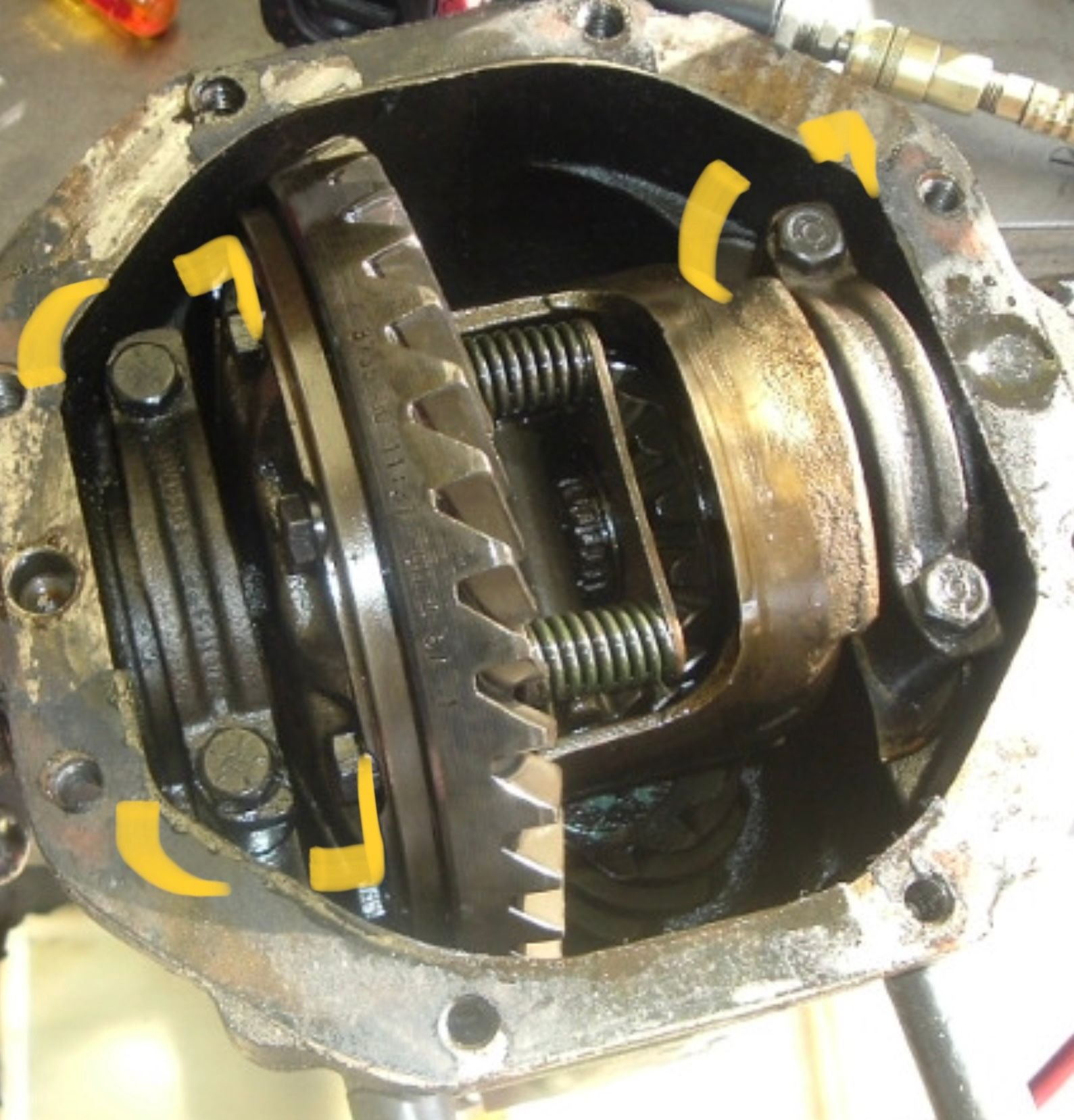

Not the expert, but smart enough to have had Gary rebuild mine!!!
It looks like the bearing caps have a straight edge side and a beveled edge side near the bolt holes. I believe putting the beveled edges toward the diff case is the proper way. If you note in the picture of post #7, the right bearing cap has the beveled edge towards the posi, not the case. The left cap appears correct.
Remember, this is only my guess...
unlike my 79 which had tabs..this one i didn’t see until pointed out..and assume the rounded part goes outside to rounded case.
