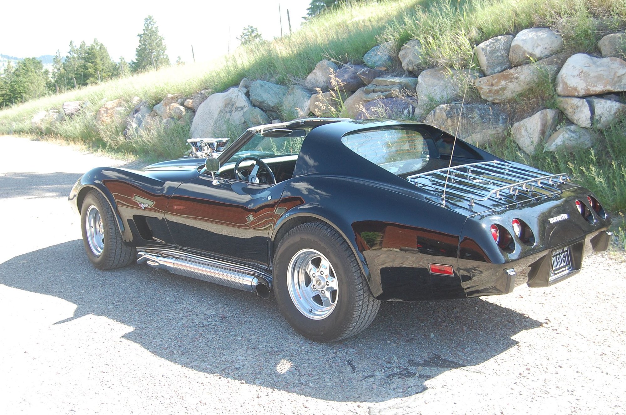

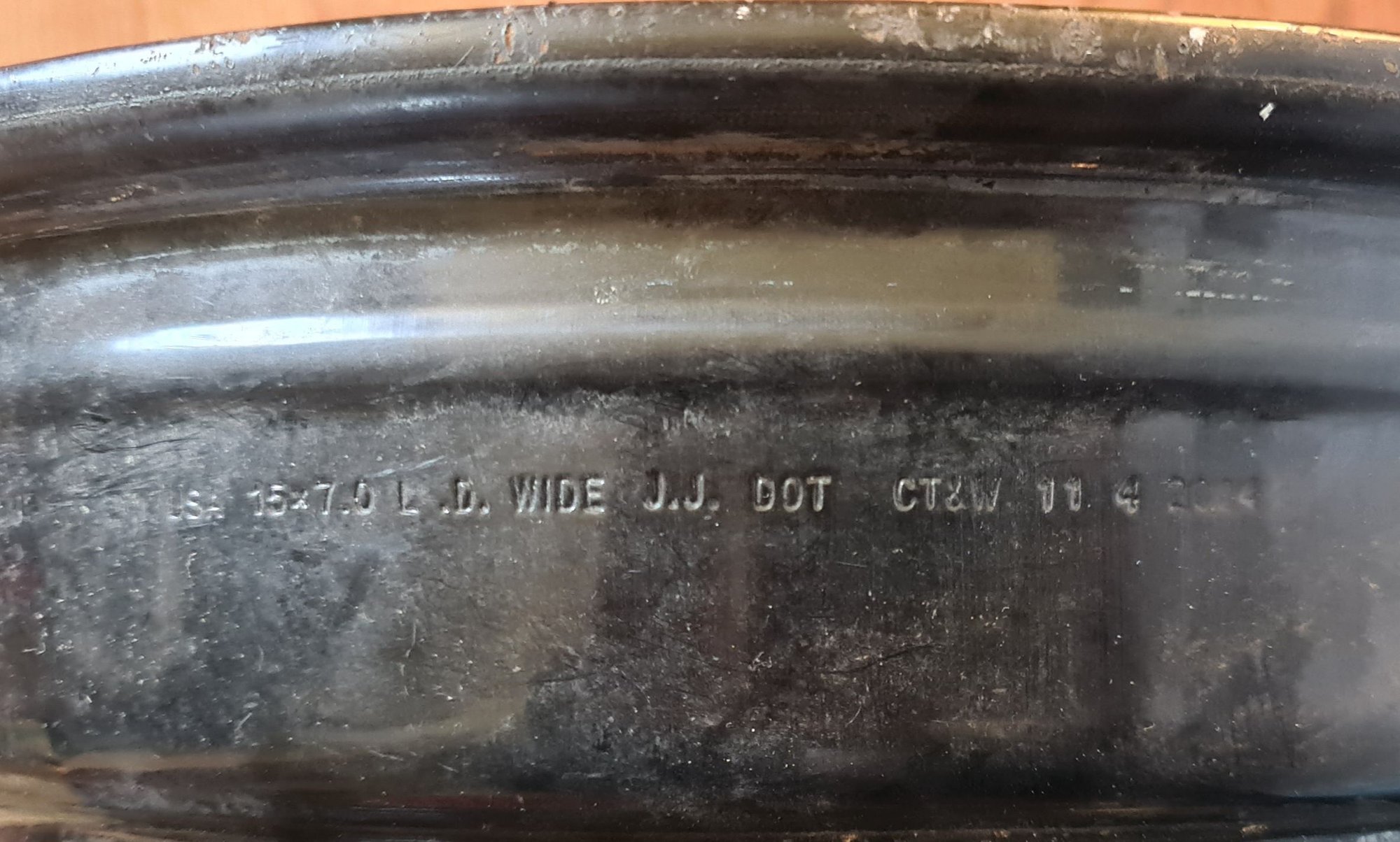

I current have
15x7 (inner bead 2 bead inner advertised) "pic 1" or 15x8 (edge 2 edge total over all size)

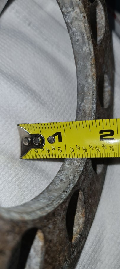

Backspace -- from back mounting surface to back edge is 3 7/8" inch
installed spacers is 7/16 inch thick (pic 2)
