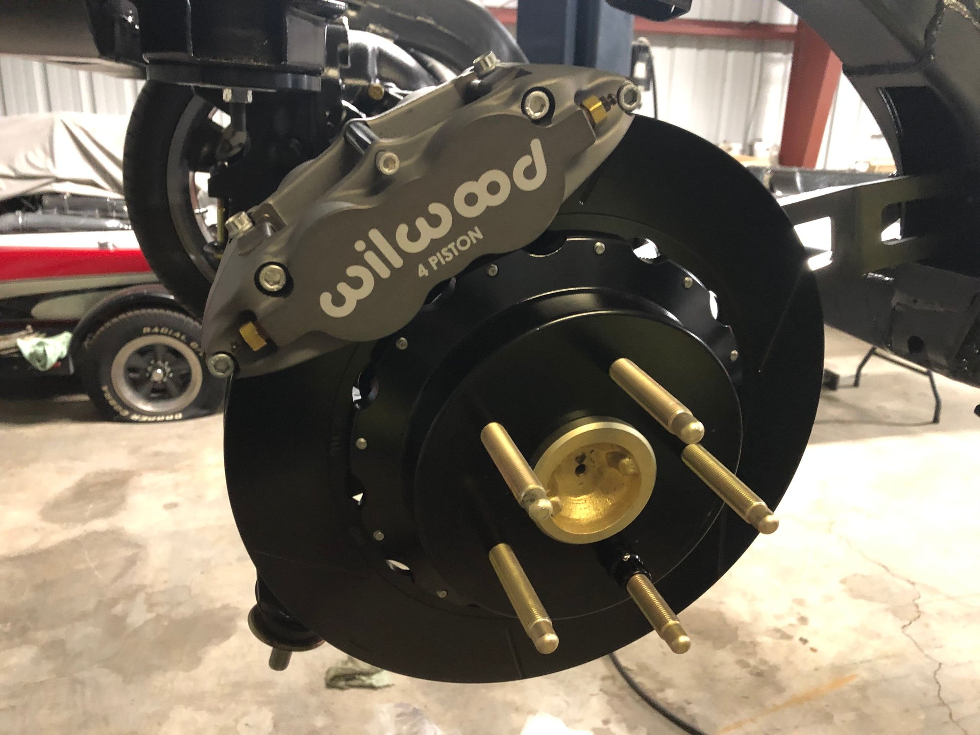

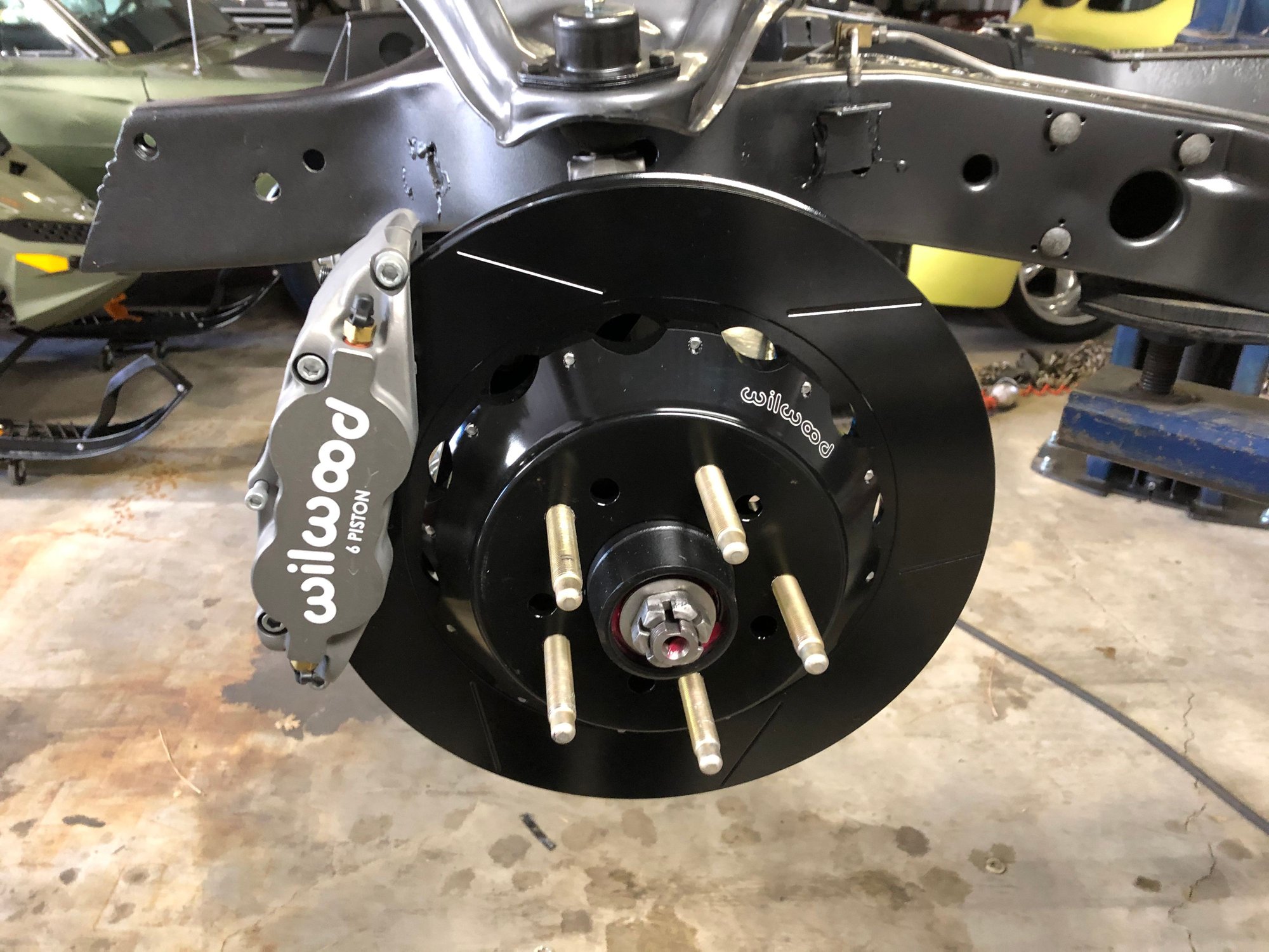

One reason to go big is because they look so cool
looks great
