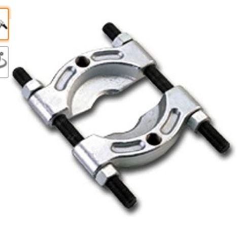

I have a press at home. What the correct tool to remove them?
Old Apr 22, 2022 | 07:50 PM
69L88's Avatar
69L88
Posts: 3,409
Likes: 1,821
From: Apple Valley, MN
One of these. Be sure to get a good quality one - it takes a LOT of force to remove the race from the carrier and there is not a lot of contact area between the puller and the race.
