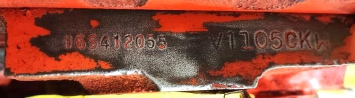

I'm thinking it was an L48 out of a '76...but not sure....I figure somebody on here can tell for sure....thanks

Yup

http://corvettec3.ca/engines.htm
CKW could be a base 4-Speed engine from 72, or an L48 4-Speed engine from 76. 76 seems more likely, but you'll want to check for a casting date (I think V1105 is Flint, November 5, but no year).
The 6 before the S in the partial VIN would correspond to 1976 in a standard VIN, but I'm not sure how partial VINs work. Is that an L before the 6S? The VIN of the 1976 car it may have come out of would have been:
1Z37L6S412055
http://corvettec3.ca/vin.htm

I honestly cant tell what that it before the 6S...It looks like a 1...but a different font than the other 1 ....I have pretty much come to the same conclusion....its nothing important, was the engine in my truck, just have it sitting around

CKW Corvette 76 350 180 4-Speed, (L48/Federal)
1
Make/Manufacturer – Chevrolet
6
Model year 1976
S
Built in St. Louis
412055
VIN Sequence Numbers

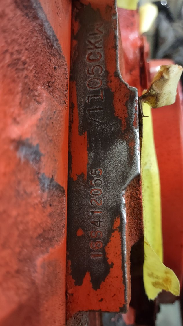

Better photo
To help me ID this engine block
