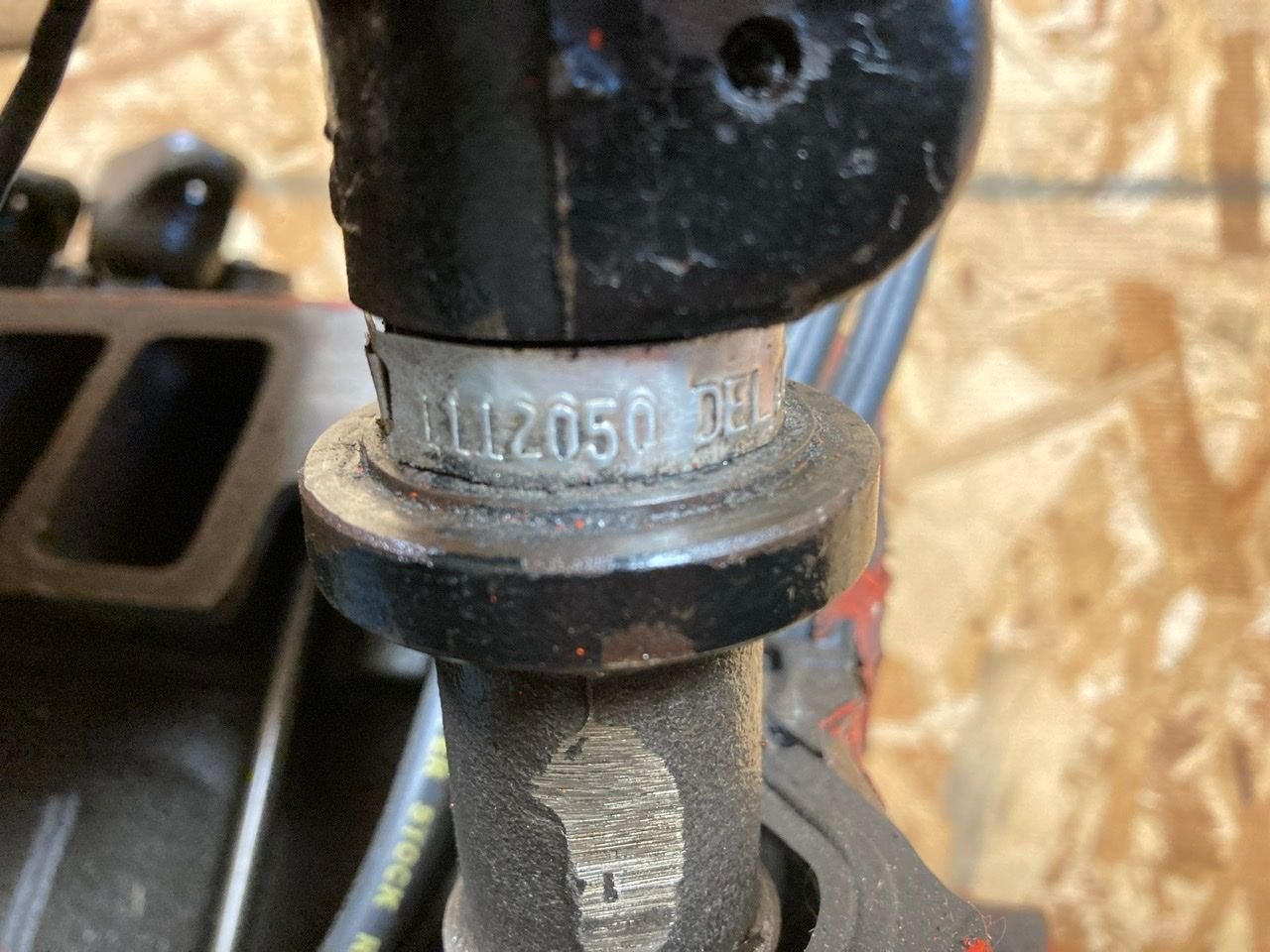

As Wilcar mentioned, there may be an aluminum band around the housing just above where it enters the intake manifold. If it's there, and original, it should be embossed with 1112051 corresponding to the engine (Interesting that this GM chart for the '72 shows what appears to be gross HP rather than the advertised net HP. Or maybe they copy/pasted from '71?):

The original distributor for my ‘71 270 hp is tagged 1112050, so you might be right on the carryover from ‘71.
